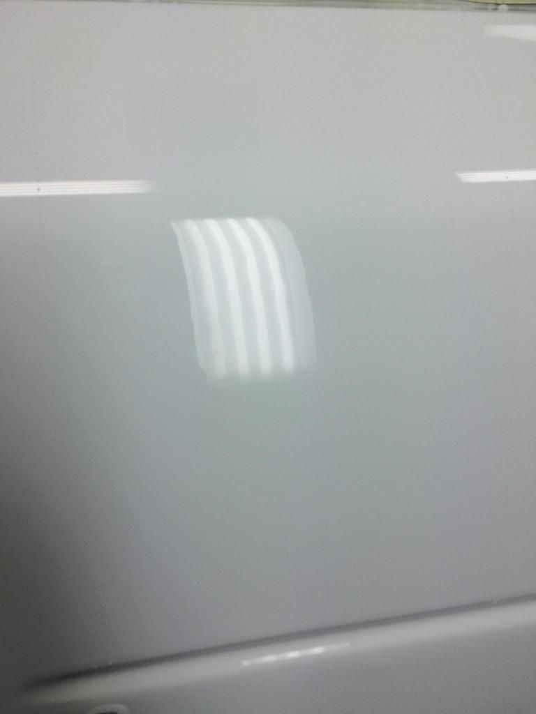

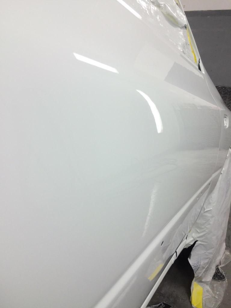

You may not need the UC if the paint is in good condition. Tough to tell in the photos and the body shop may have used something to hide any swirls. It should be evaluated after all the Decon steps.
Thanks!
Ill give it a go put I don't think I'll need a compound

The paint has most likely long since cured since most paints are chemically cured these days. The longer you wait the harder it will be to cut with a polish (ie when the paint is fresh it will actually be softer and you can use less aggressive products). Most likely your body shop has already cut the paint w/ a rotary buffer and if they did a quality job only minor correction will be needed.
If its a fresh paint job, really no need for iron x. I would just use a mild paint cleaner to remove whatever the dealership put on, then a high quality sealant. ( I like Sonax PNS)
