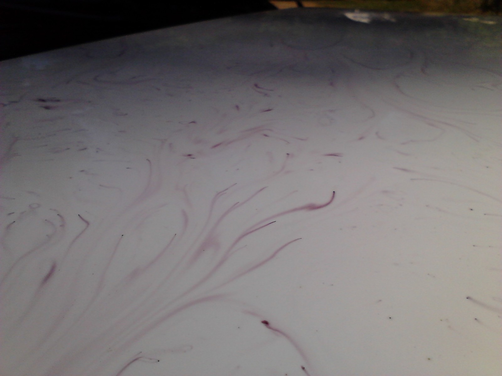

This is a prime example of Love Bugs baked onto a car. A pressure washer will barely make a dent in these unless you want to blast your paint with 4000 psi.
