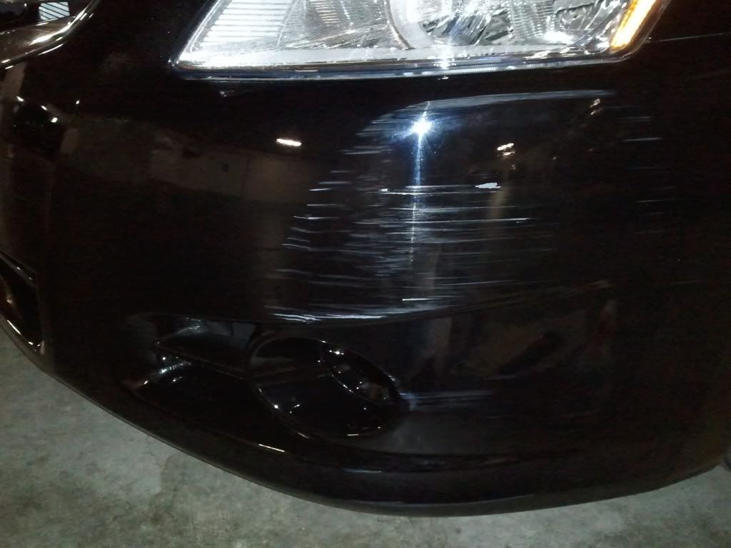

I am trying to remove some bumper scrapes/scratches. This is what I had at first - after removing the paint transfer with prepsol & ISA-Water:

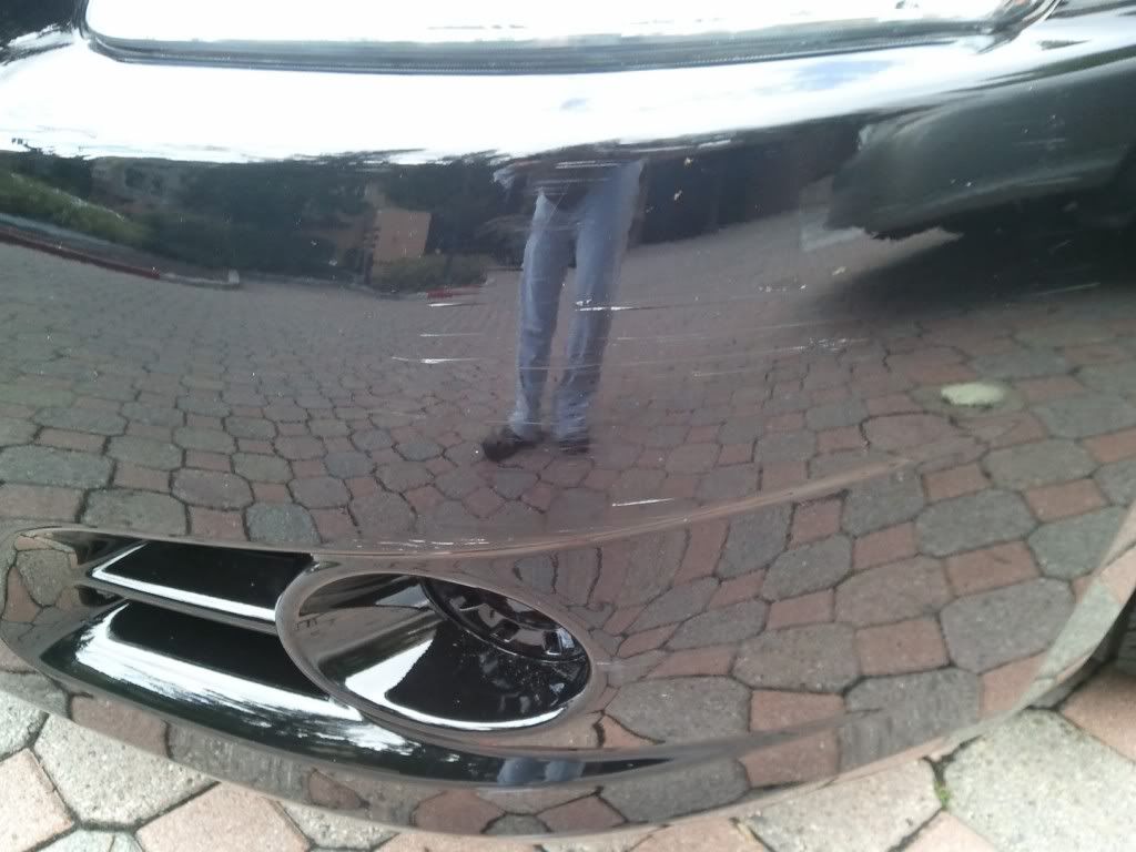

I used Meguiar's UC on a 7" Meguiar's Softbuff Polishing Pad (Yellow) using PC 7424XP at speed 5 with moderate pressure, and got to this:
Looks better, but now the remaining scratches are super difficult to take off. Before I step up to M105, I wanted to solicit advice on whether I can complete the job with UC.

I think that's about the best you're going to get; IMO if you keep going you're going to be thru the paint (because the scratches that are left are already through the paint).
If you want to keep going, be aware that those vinyl facias don't dissipate heat well, and if/when you overheat the paint it will fail suddenly without warning, so stop often and let the pad/paint cool, feel with your hand, if it feels too hot to touch, that's too hot.
PS You did really well with that, I'd leave it alone, or try some touchup in the remaining scratches.

Thanks. That makes sense.. which is the reason I stopped after I reached this point. The bumper was definitely getting warm to the touch by then, and it seemed that I could not make more headway without applying additional pressure or bumping up the speed to 6 (which I definitely want to avoid).
