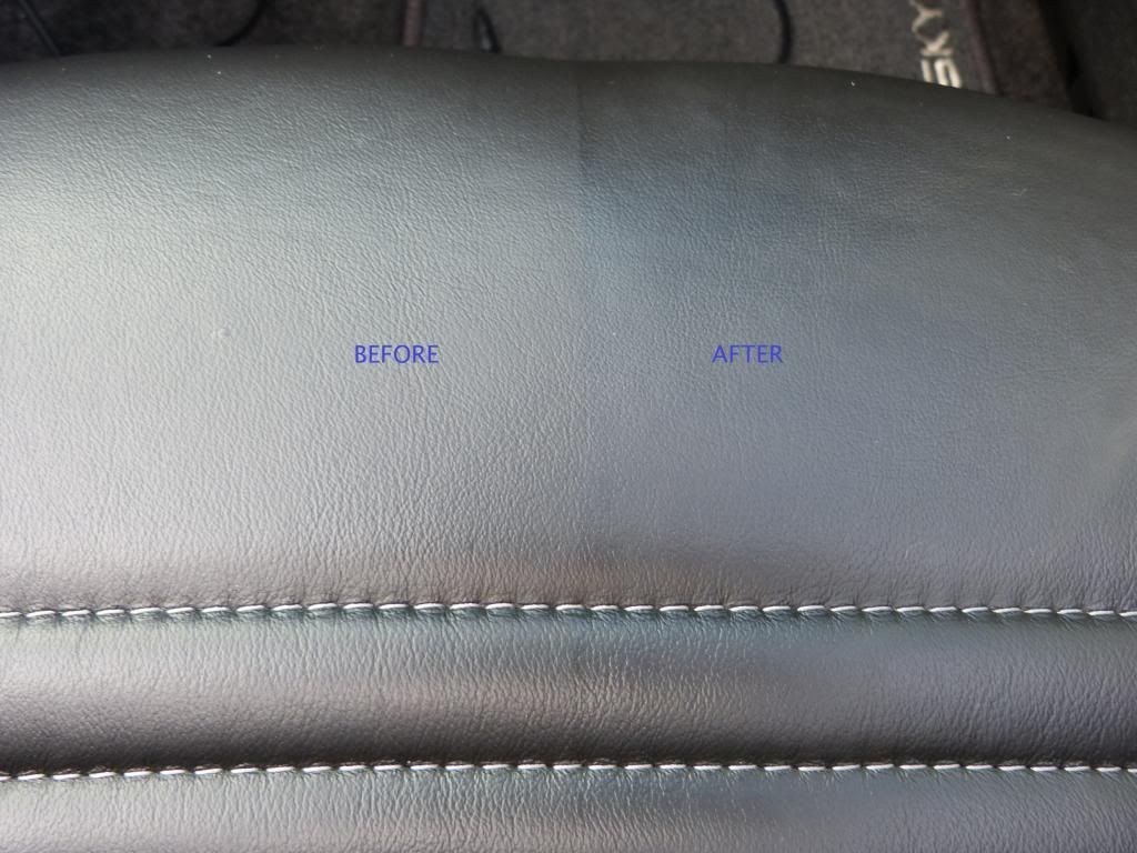

I tested on Skybaby when we first released F&L and ill grab a picture from that momentarily. Let me find it :)

You'll be very excited with the results Mike ;) We've had a lot of great feedback with customers using it on all manner of shoes, golf bags, all kinds of things. Some great videos out there.
