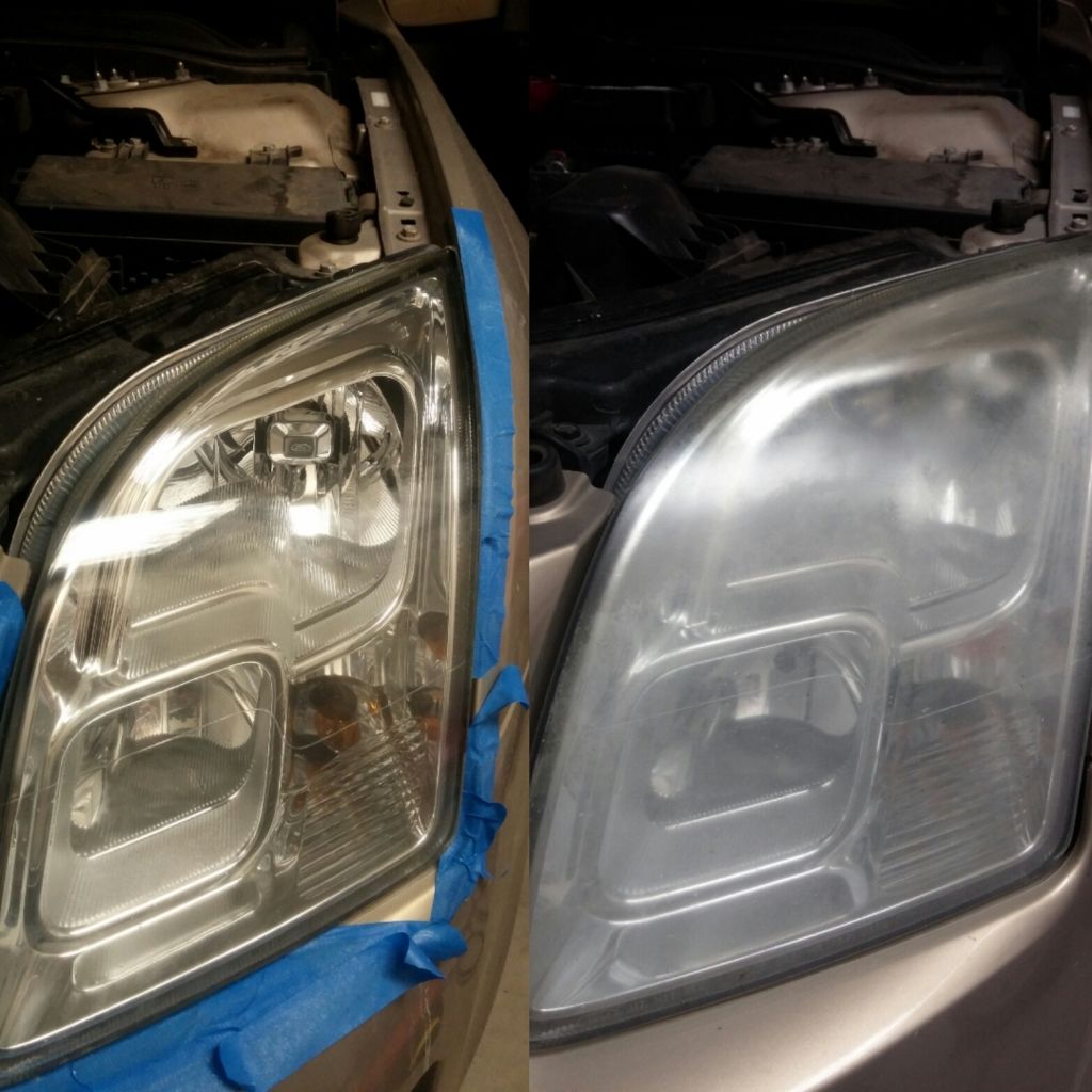

oh yeah, easy fix!
looks like you don't even need to wet sand it.
DP headlight AIO polish should work easily.
Oh yeah! He has 10 bucks and one day to fix them.
oh yeah, easy fix!
^^not terrible results.... this is what I did on a customer car with the 3m kit that I bought from Walmart for $15.... worked pretty good but the kits only good for 1 maybe 2 sets of lights.... I picked up the DP headlight polish that everyone's talking about so I can't wait to try that out next time
don't forget to use sealant to protect your polished headlights .... leaving them exposed will let them fade again..
