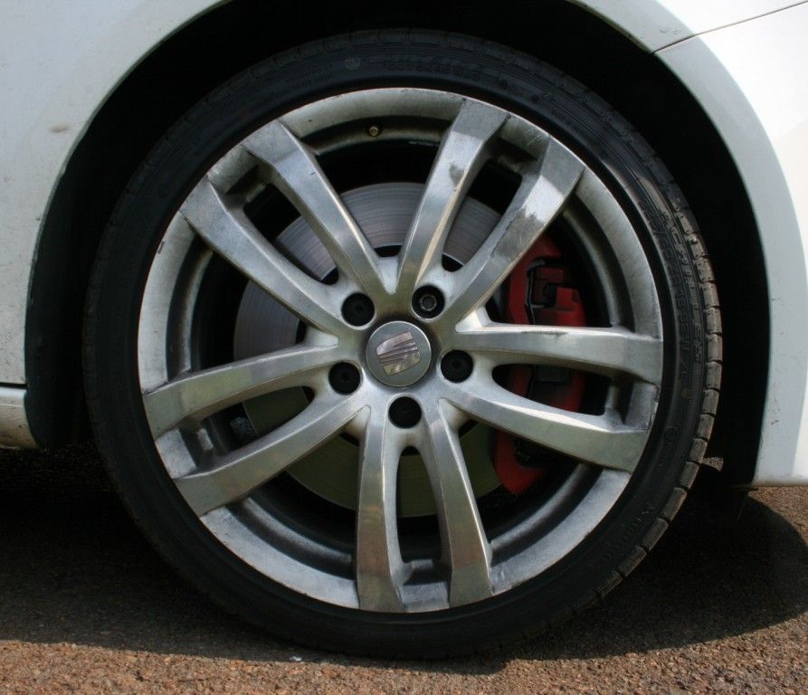

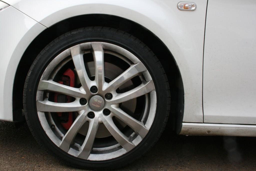

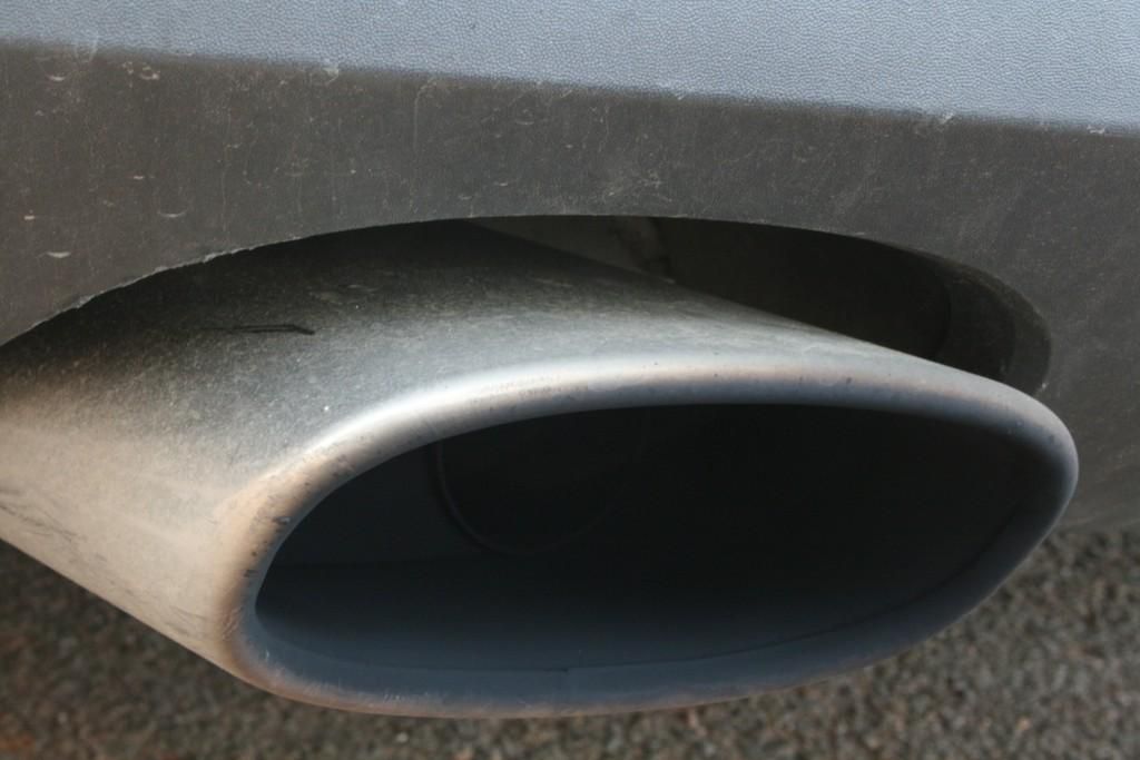

This was a full detail, however the customer is looking at refurbishing his wheels soon, so whilst every effort was made to bring them back to life, this was done on the car and as such, they are not perfect. First the wheel wells were washed and then I started on the wheels themselves. They received an initial wash (along with the tires) of APC, which was followed by a wash with a dedicated wheel cleaner. This was followed by 4 separate hits of iron-x in an attempt to remove the embedded brake dust. They were then sealed and tires dressed.
Before
After

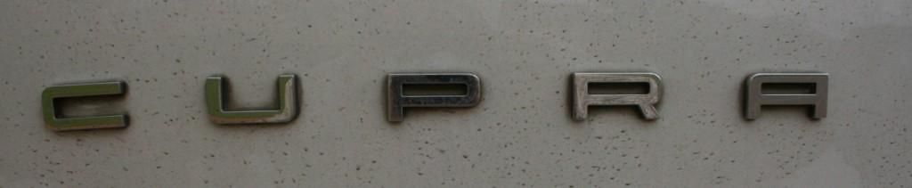

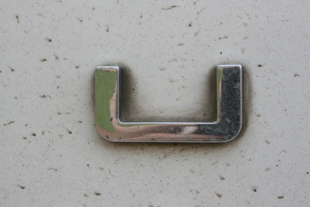

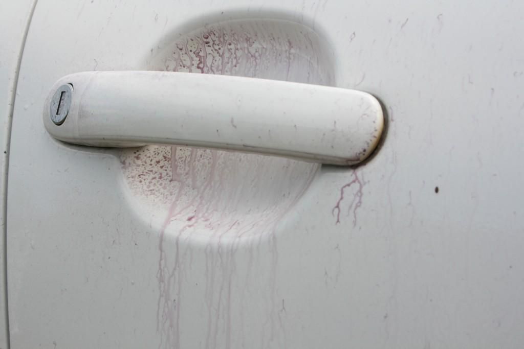

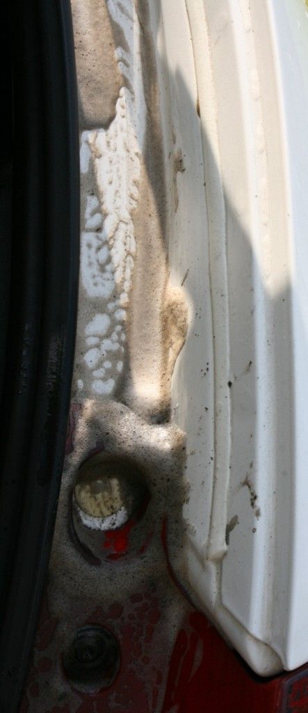

All the emblems, door jambs, petrol cap, boot jambs etc were then pre-washed to remove the bulk of the dirt in these areas.

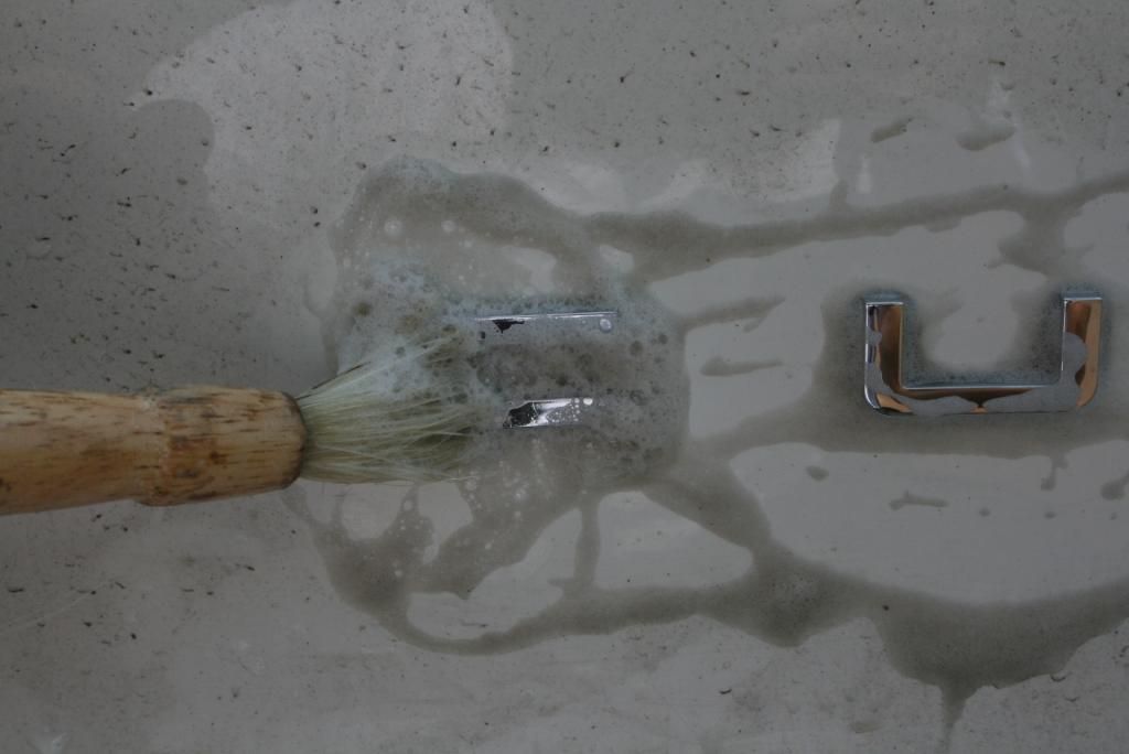

The entire vehicle was then snow foamed with a mixture of products to help remove any existing LSP, as well as the more stubbon bugs and road grime

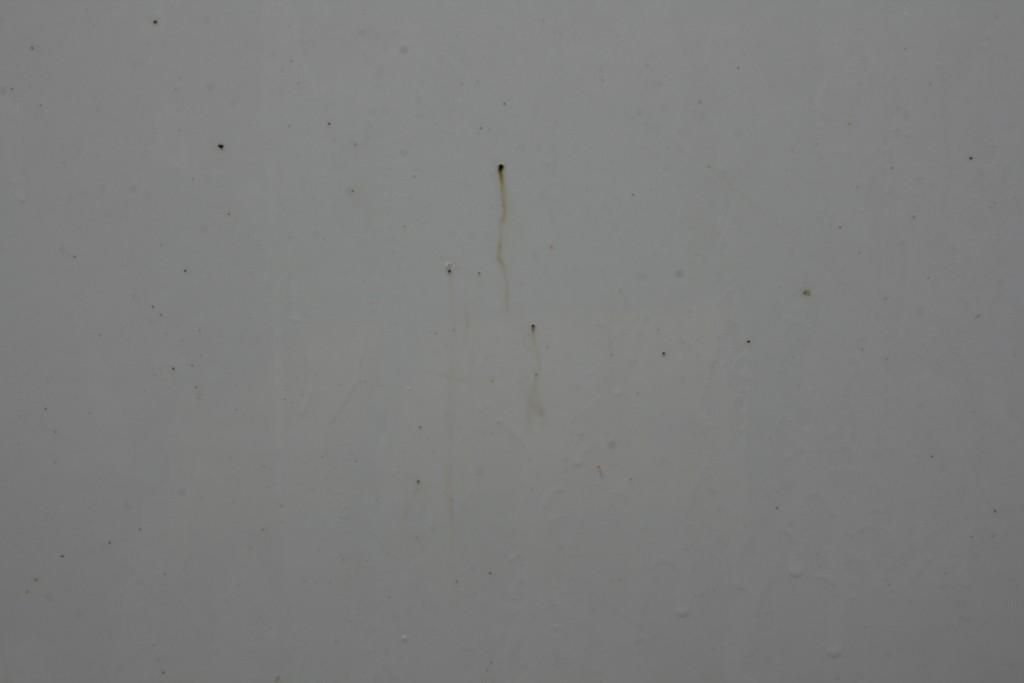

The above surface decontamination then continued with all the tar spots being removed

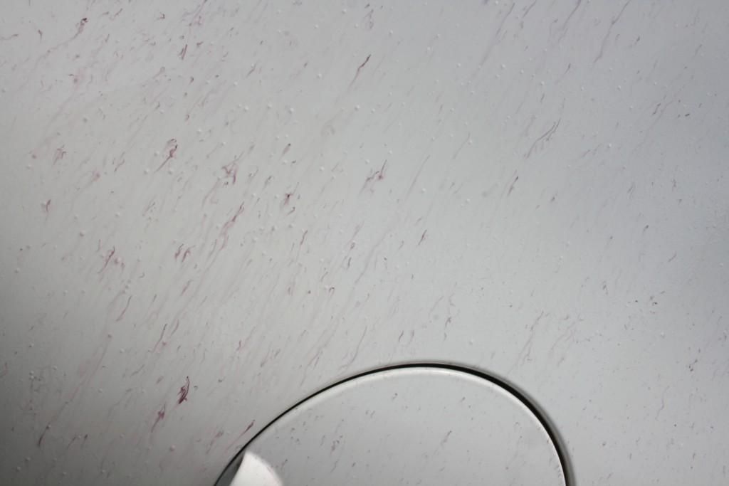

This was then followed with an iron decontamination over the entire surface of the vehicle
I then moved onto focusing on specific issues evident on the paint, such as this...
Which then came out looking like this

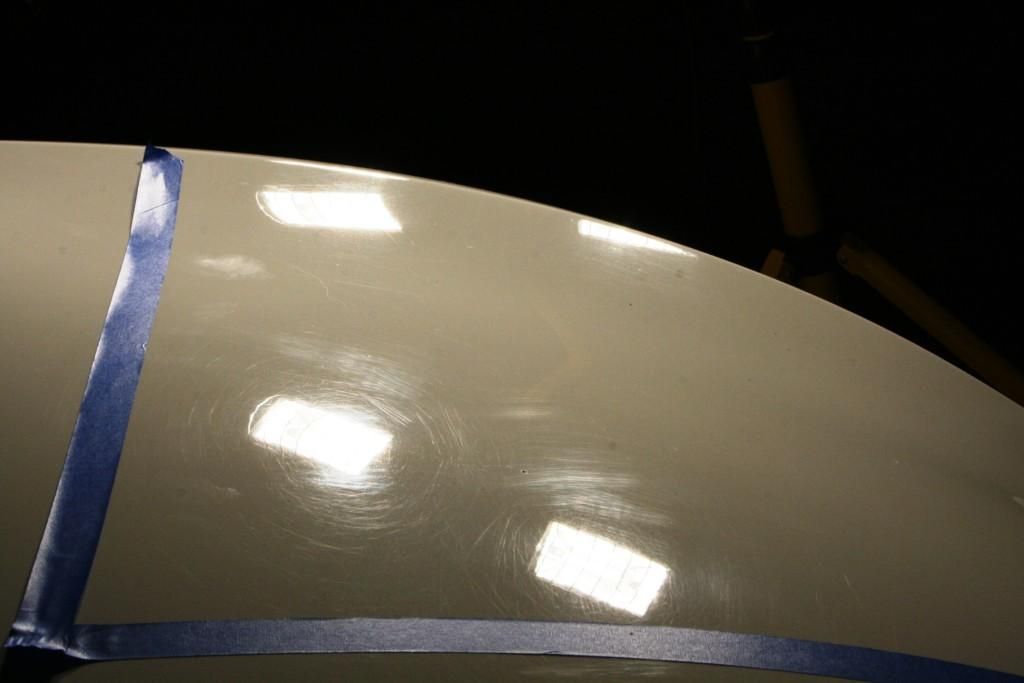

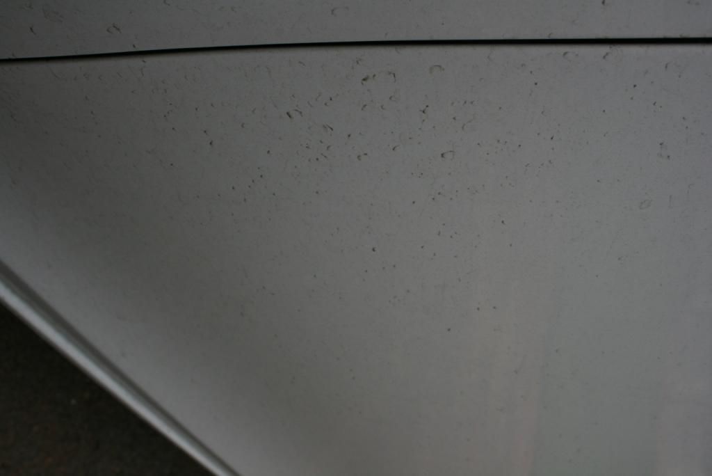

Not only was the car covered in swirl marks, but there were many many deeper RIDS. After an initial test spot a decision was made to correct the paint sufficiently to remove the swirls, but to not attempt to remove any of the deeper RIDS as this would have removed too much of the clear coat.
Before
After 1 correction pass (you can still clearly see the RIDS, however the swirl marks have been removed)

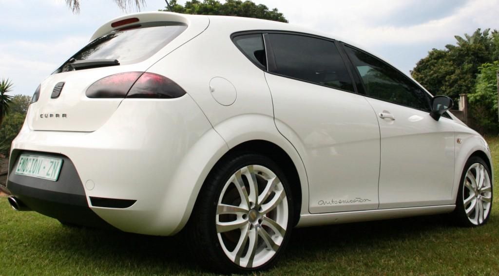

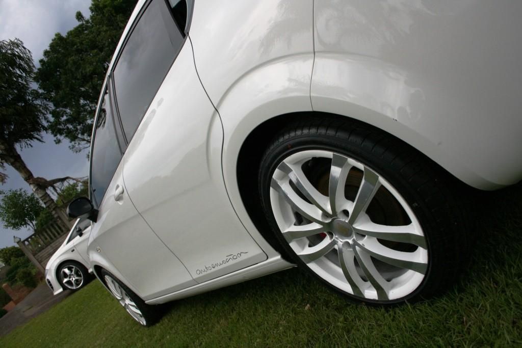

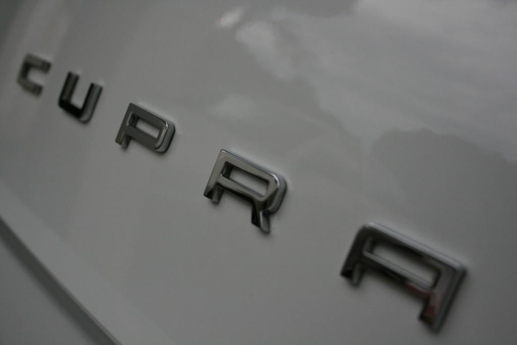

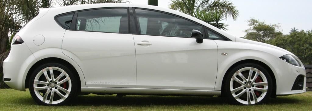

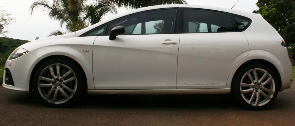

Here are a few 'after' pics I did manage to capture.
^ the other Seat poking it's nose out in the above pic, is the client's wife's car, which will be done this coming weekend.
