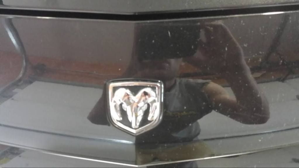

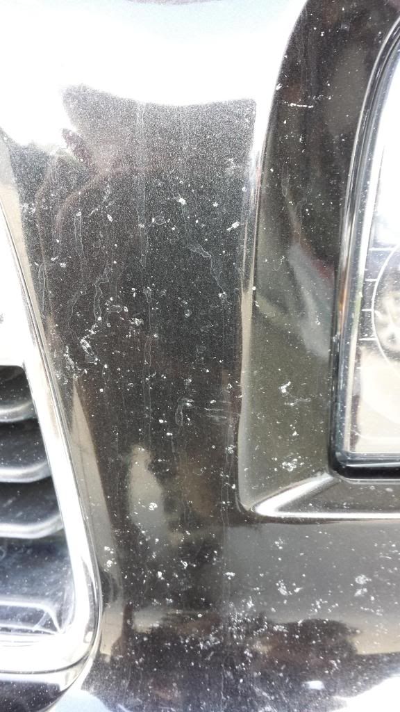

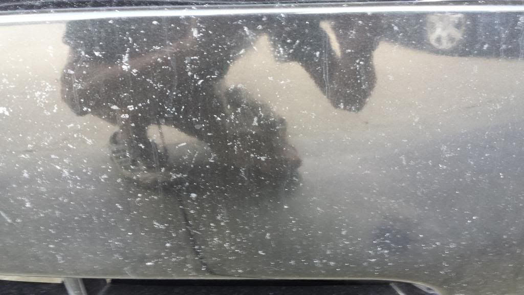

I have a black Charger and my front bumper looks like this...
Any advise on getting this out(Im not talking about the water spots) Some of that other stuff if i pick at it with my nail you can not feel it and there is some that i can tell the paint is slightly chipped. I have the porter cable 7424xp and so far have tried m105, ulitimate compound, scratch x 2.0 with yellow and orange pads with speed on 6 and none of these products cut it. Is there something i am doing wrong? (im new to pc, just got it the other day). Thanks!!
Yea point of no return unless you get it "repainted". I know you were not trying to hear that.
No def did not want to hear that but atleast your honest and i can stop waisting my time.
would it be possible to hide them a little bit? Its def not a show car by any means and i dont need it in prestine condition but would like for it to not look that horrible esp when the rest of the car looks stunning
Fractures are rather deep. Any polish or wax with fillers will stand out on black paint as these will fill in the etchings. LSP with a clear product like Optimum Opti-Seal or the like.
Bumper resprays are relatively affordable.
if you are new to machine polishing, i would take it to a local detailer, and ask him if he can do anything for it, ask for a test spot. if he can correct it (although it may take off quite a bit of paint), you would end up paying a bit less than getting it repainted.
Go to wal-mart and grab a gallon of this Windshield Washer Fluids | Car Care | Products | Prestone®
Pour it into a 32 ounce spray bottle and spray it on those areas, keep spraying it on to keep everything wet for about 5 minutes. Do this right before you wash your car next.
It looks to me like those are bug guts deposits and not so much etchings. Try this and see where it gets you, or you can spend 10 times the money and get a gallon of Bug Squash to accomplish the exact same goal. Both are formulated with being sprayed over automotive paint part of the formulation plans.
Once you've done this, perhaps there will still be some etchings that will be needing buffed out.

Defiantly worth a try. Another method I use for the same purpose is aerosol glass cleaner that foams and let that foam sit on there for a few mins
At the same time though...I've experienced some horribly bonded bug splatter that couldn't be buffed off with those products. Upon being treated with a product specifically designed to soften and break down bug guts, a drastic improvement was made.
