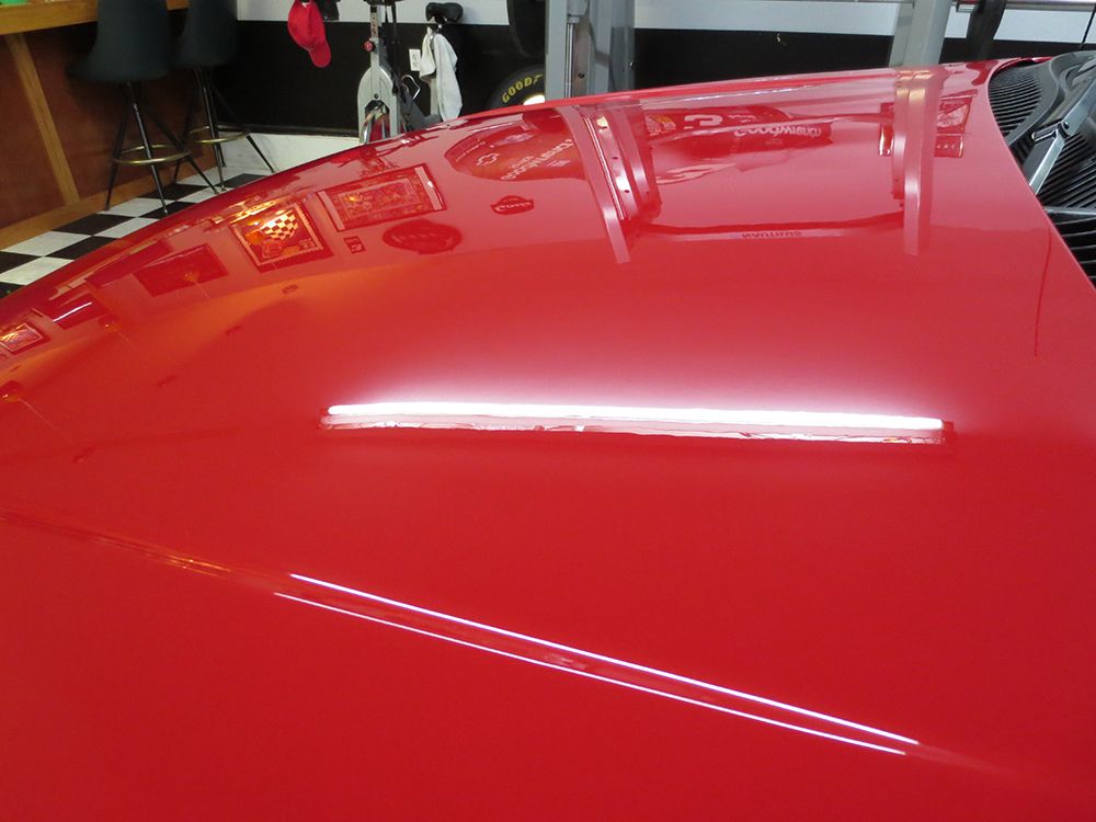

Knowing just how soft the clear coat (DuPont ChromaClear sprayed 5-20-11) is on my truck, I'm always looking for new products that leaves less of that dreaded haze so common on soft clear coats. With HD Polish I had it soooooo close... just needed a slightly finer abrasive product and life would be good lol. Read a lot of good reviews about CG Black Light and that it had just the slightest of cutting abrasives and thought I'd give a try!
Started with GG ROP with a 5.5 Black Finishing pad on setting 4 1/2. Applied BL thin with just a slight bit of pressure on half the hood. Waited the 15 minute dry/haze time. Remved with a Gold Cobra MF and could instantly notice the hazing, about where M205 leaves on this clear coat. Oh well... moved to a Blue Finessing Pad to minimize (user) pressure. This brought it almost back to where it was but still showed the hazing :rolleyes:
Now the search continues for that elusive polish & pad combo for this soft clear lol
Going back to the HD Polish (just the hood) tomorrow as it works out really good. Still would love some opinions which fine polish you guys would recommend (HD Polish is less abrasive than PO85RD).
Thinking maybe one of these:
GTechniq P2 Jewelling Polish
Prima Amigo Pre-Wax Cleanser & Gloss Enhancer, Prima prewax polish
Before with HD Polish very little hazing
After with Black Light
Probably a one step with Blacklight? No prior polishing I mean, directly BL.

Yeah after using the BL it seems like a nice AOI. If my clear was harder it probably would have looked great IMO.

wow thats some strong hazing for what is considered a mild product. looks like it has lots of cleaning power.
