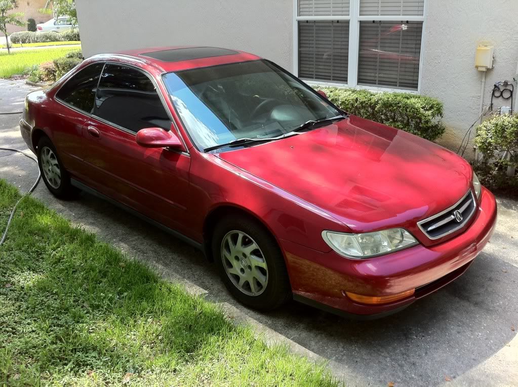

BEFORE (should have taken it in the sun.. o well)

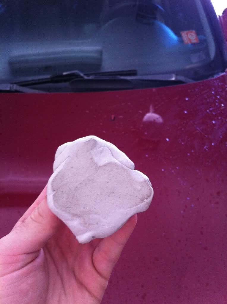

Claying after wash:
I taped off my main areas of concern, I did not charge my neighbor anywhere close to full price for this job so I did not tape EVERYTHING off. I was very careful around the exposed trim and did not get any compound or wax on it.
During the wash the car wasn't beading at all, and I knew some of the car had been repainted so I was confident the paint was free of any old wax, etc.

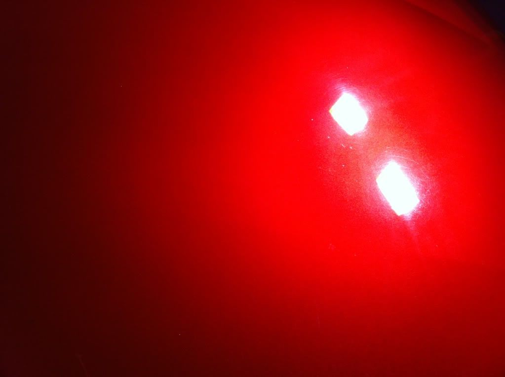

HOOD BEFORE under my halogens:
Swirls and buffer trails captured as best I could:

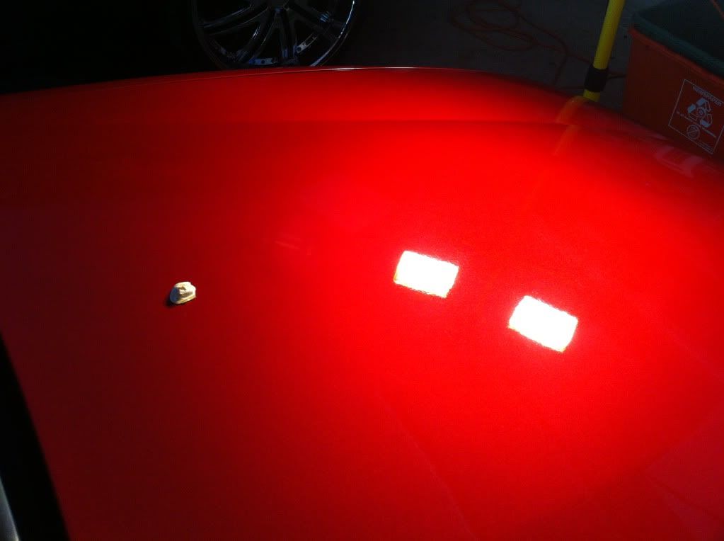

D300 & Cutting Disc
AFTER polishing with D300 and cutting disc (several passes variating pressure from moderate to light):

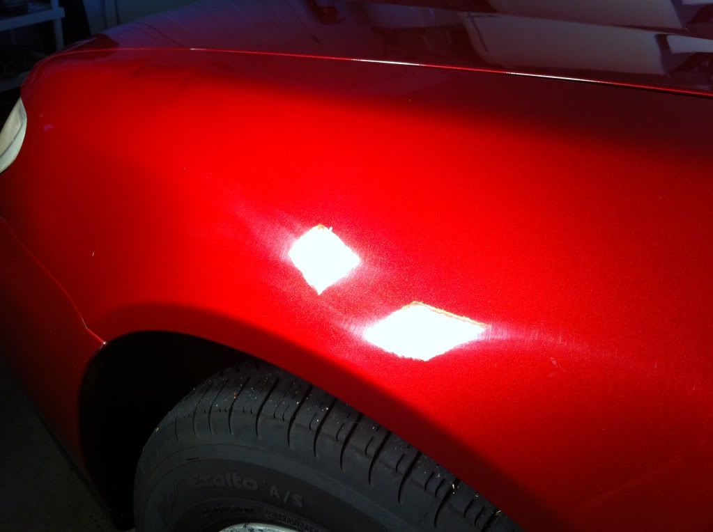

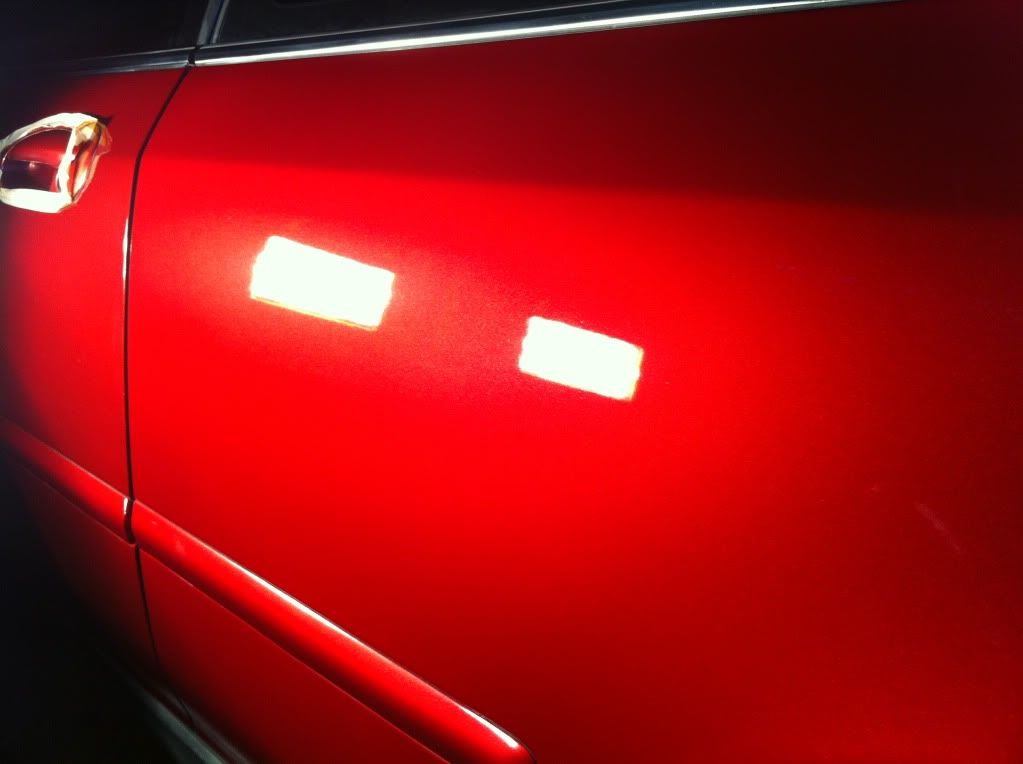

Driver's side front quarter panel BEFORE:
Driver's side front quarter panel AFTER:

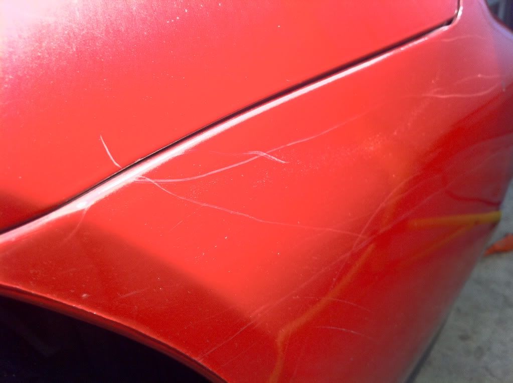

Scratches on the passenger side of front bumper BEFORE:
Passenger side of front bumper AFTER (I hadn't polished the scratches above yet)

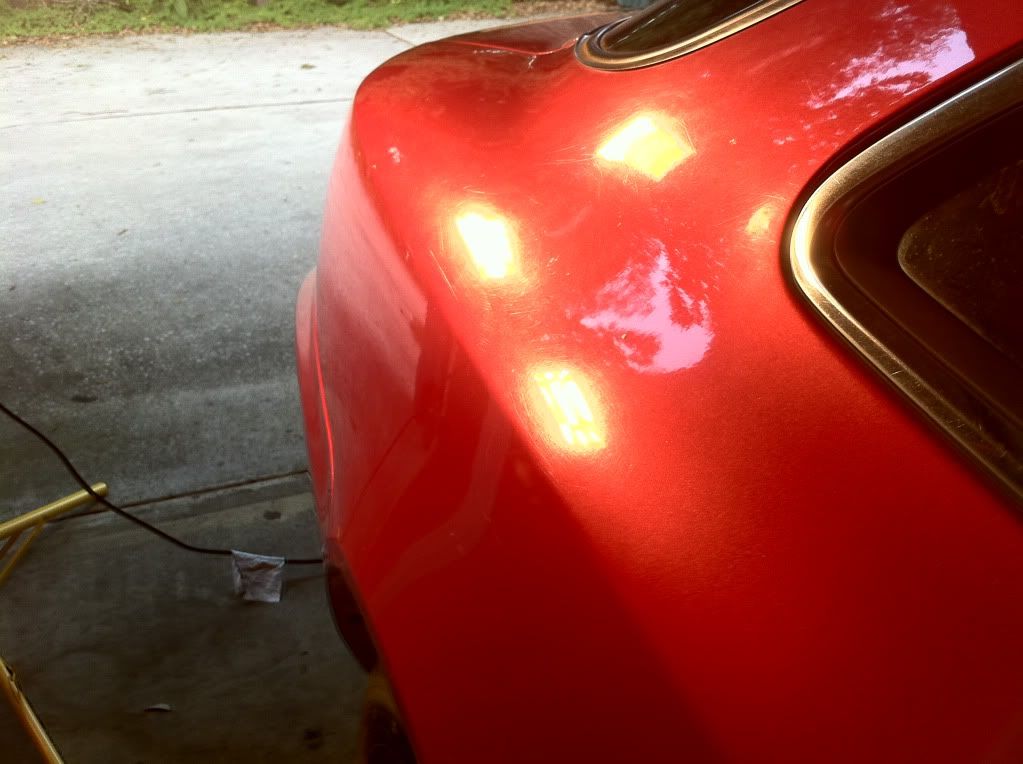

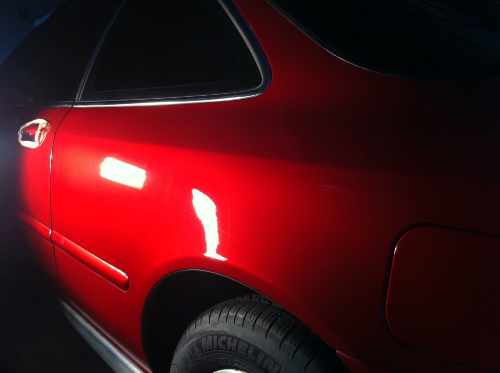

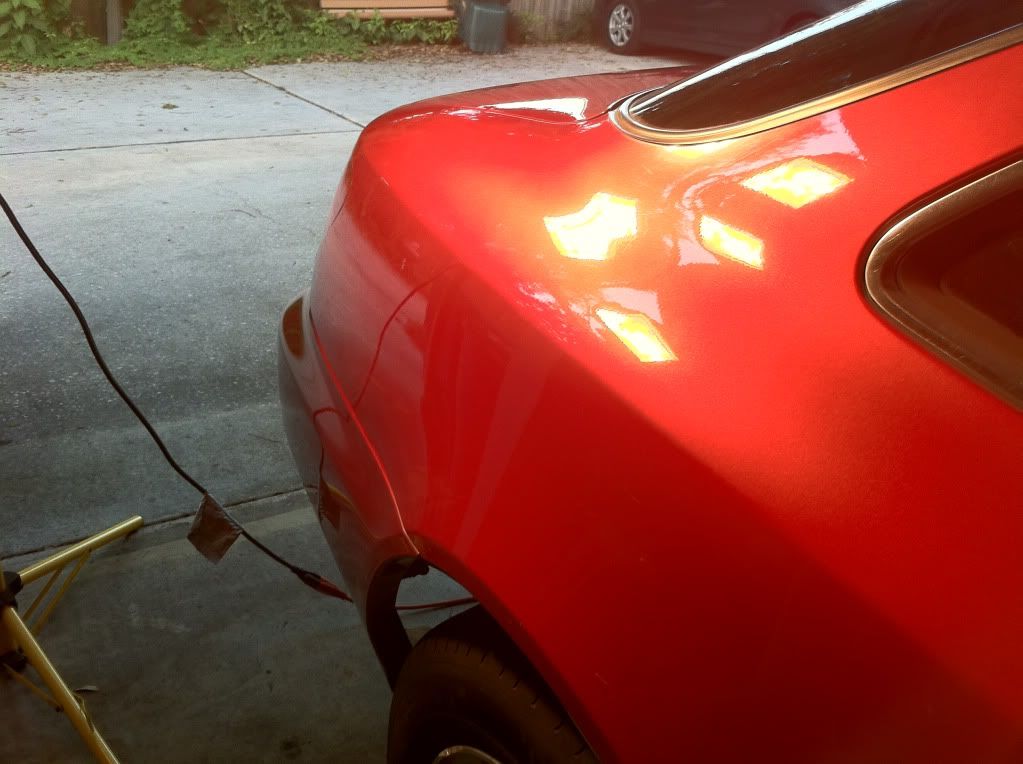

Driver's side rear quarter panel BEFORE:
Driver's side rear quarter panel AFTER:

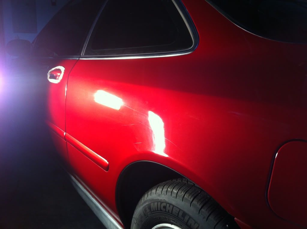

Passenger side rear quarter panel BEFORE:
Passenger side rear quarter panel AFTER:

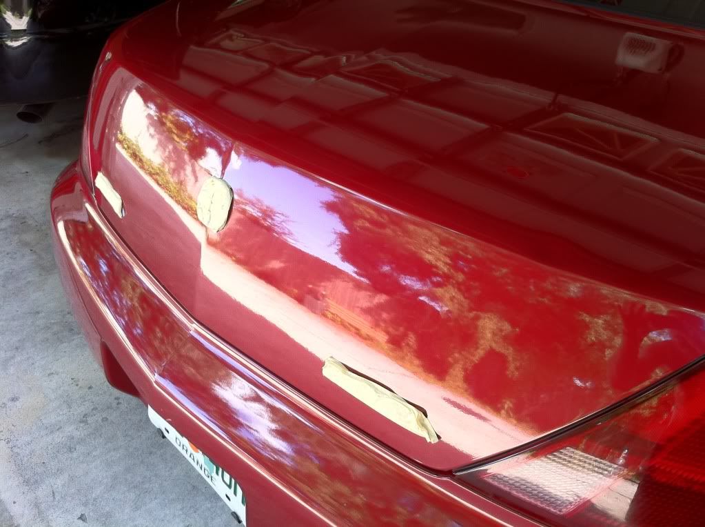

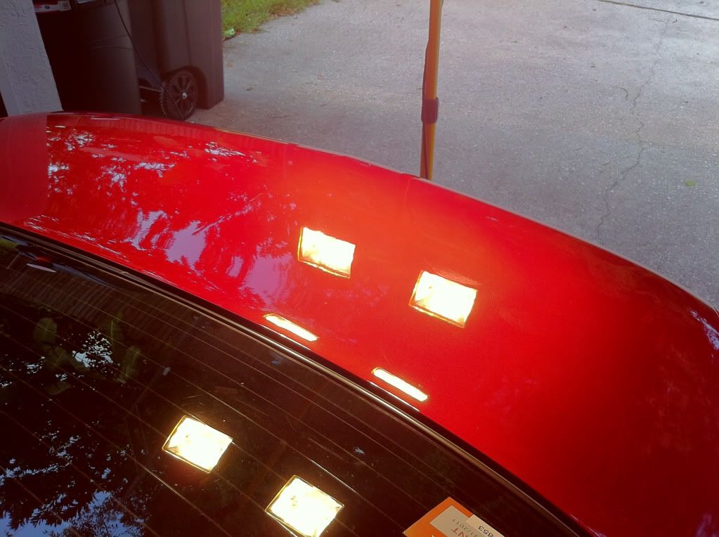

Trunk AFTER (i was getting pressed for time and daylight)

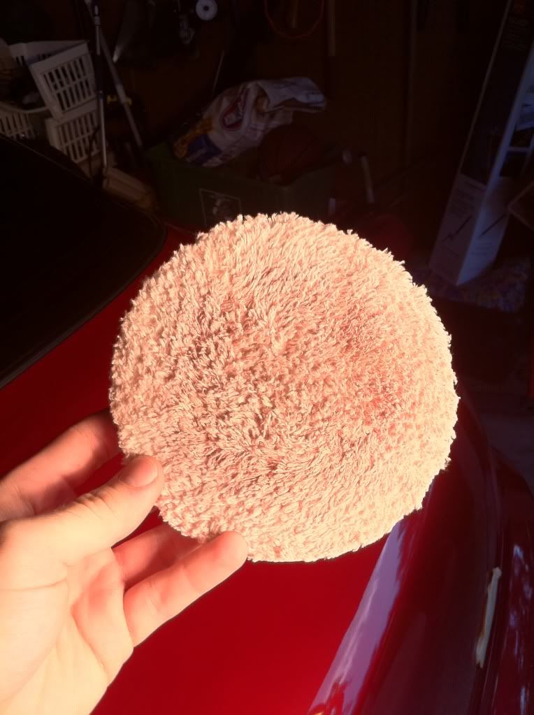

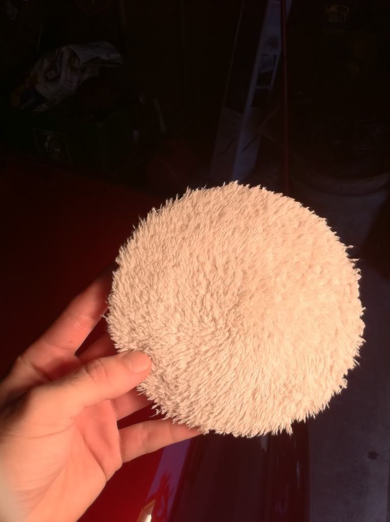

Meg's cutting disc after polishing BEFORE cleaning:
Meg's cutting disc after cleaning with APC and a little bit of APC+, & thorough rinse:

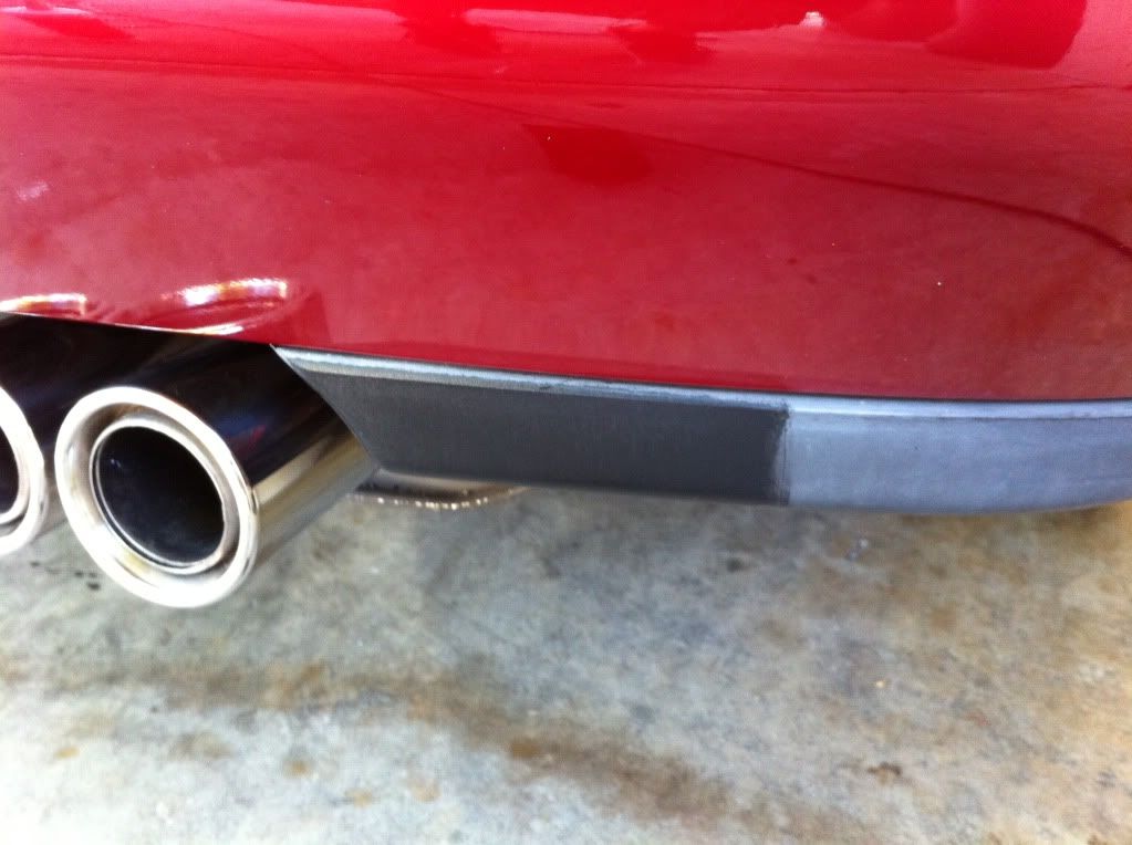

Meg's Mag & Aluminum polish w/#0000 steel wool:
Meg's waterbased dressing on plastic trim:

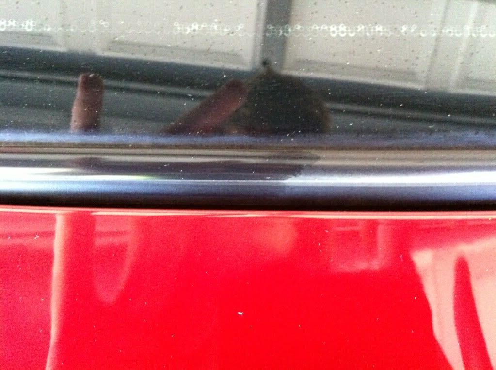

Meg's #40 on exterior rubber:

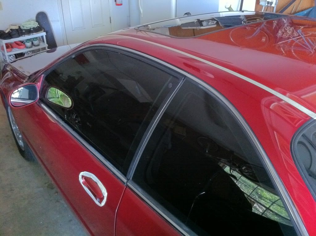

In the sun the next day:
Interior AFTERS:
In the shade FINAL SHOTS:

Well done! How many compounding passes did you make?
Thanks!! I would apply 4 small dots around the cutting disc and work it into sections at a time working 2 passes at moderate pressure, 1 pass at light pressure, and 1 pass at machine weight only. About 4 passes.
