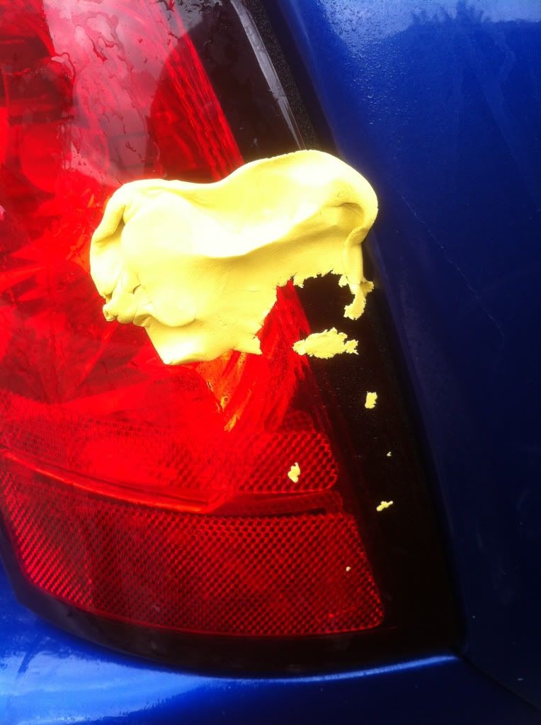

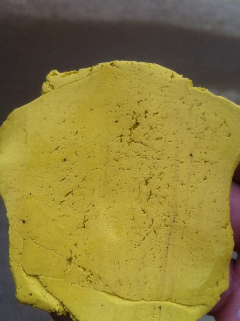

soapy water is gonna fk up your clay bar and make it shred to pieces.... dont do it
This is incorrect as I clayed so many cars with soapy water with no problems at all ... just don't put to much soap, you'll be fine.

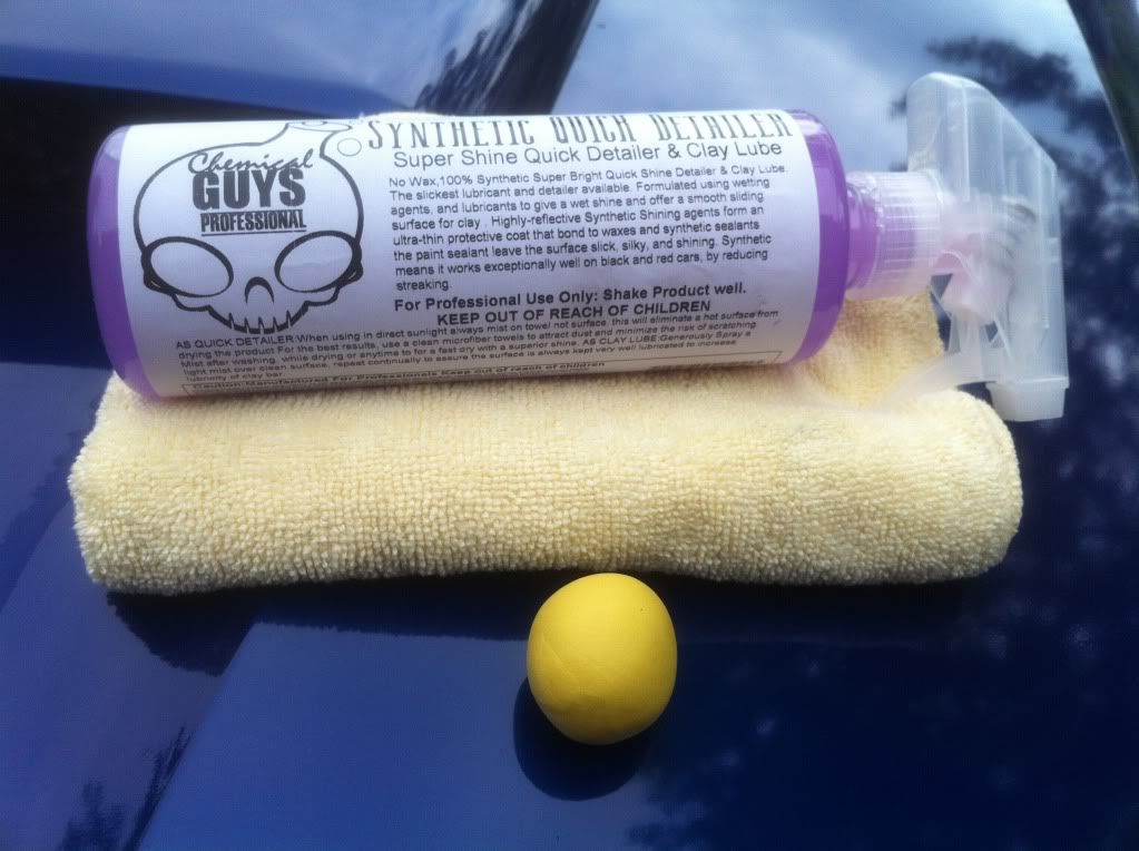

I would say clay lube or ONR. Don't be such a cheapskate. You can pick up some cheap clay lube anywhere.
After buying bottles of dedicated clay lube and running out after a few vehicles i went the ONR route and use it as a dedicated lube now. Its stick, doesnt cause the clay to "stick" and its easy as heck to wipe off when your done, leaves no residue.
