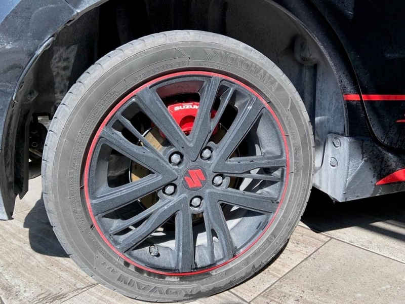

This are the dirty wheels of my Suzuki Swift Sport 2019. :wowwow:
I want to show the process I use for cleaning them.

First I use the pressure washer to remove all the dirt possible. This time I only used Wheel Brightener, no need for the iron remover this time.

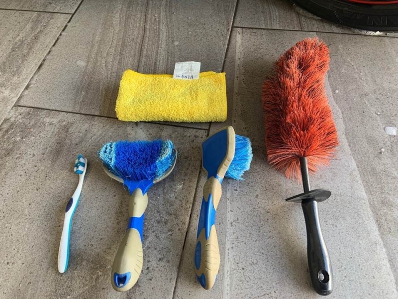

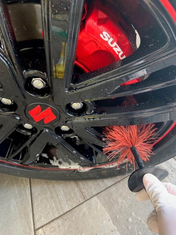

I use different types of brushes for the wheel spokes, arches and tires. I even use and old toothbrush

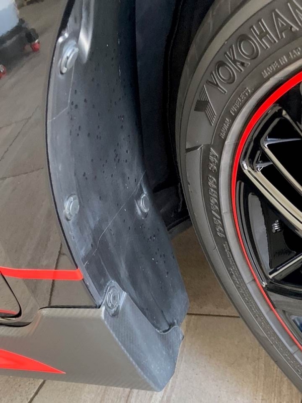

You can clean the wheel arches with Superdegraser or All Purpose cleaner depending on the dirt you have. Agitate the product with a good brush. This is important preparation for the plastic protectant.
I use the Speed Master wheel brush for cleaning the inside of the wheel and is very handy for tight spaces.

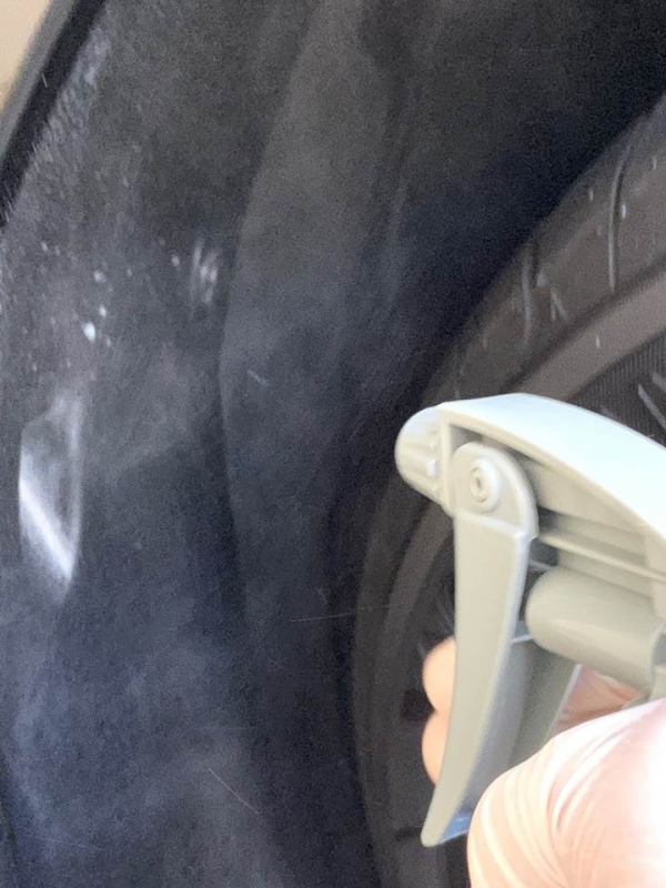

For the wheel arches I use Hyper dressing diluted 4:1 for the "like new" look.

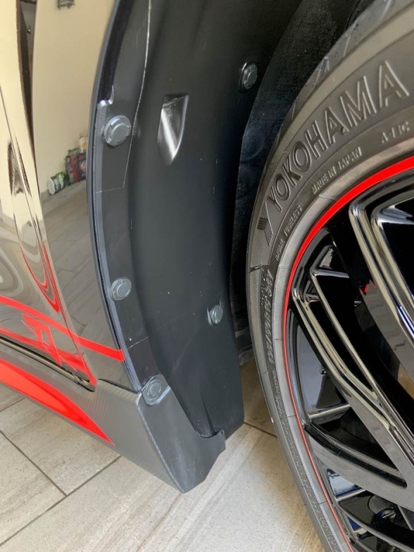

Now the wheel arches are clean but they don´t look black. They need dressing to complete the effect and look like new.
Apply deliberately and distribute with a foam applicator if needed.
Looks better.

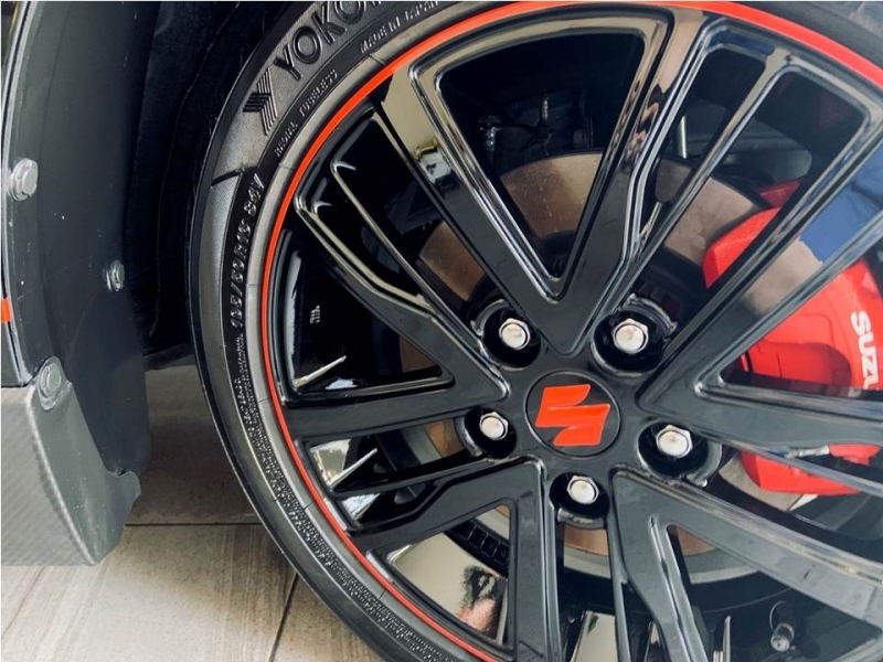

Now to dry the wheel with a waffle weave microfiber. And to remove any overspray.

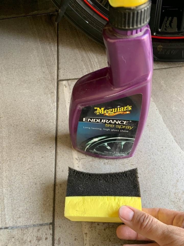

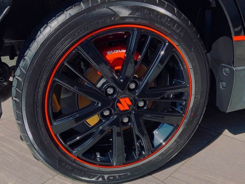

like shiny tires so I used Endurance Tire Spray. This version doesn't exist anymore. Distribute the product with a tire foam applicator.
Nearly finished. 3 more to go.
BEFORE
AFTER
Final result with a coat of Ultimate wax. This is very important because it will make subsequent cleaning easier.
