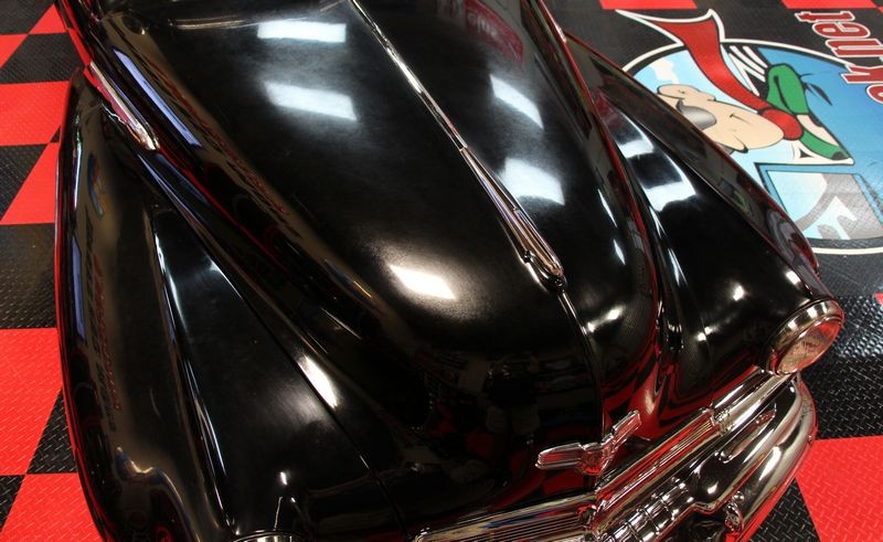

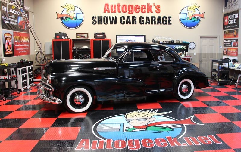

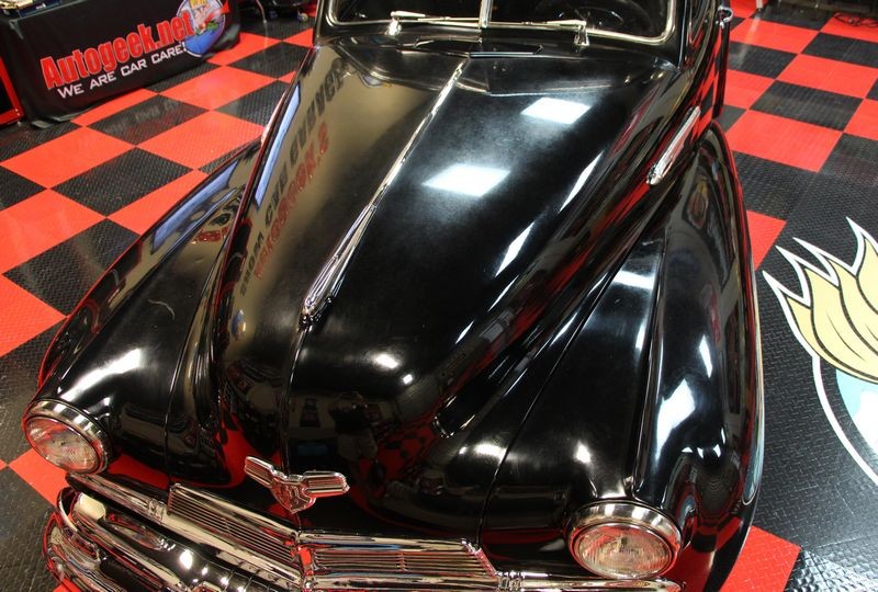

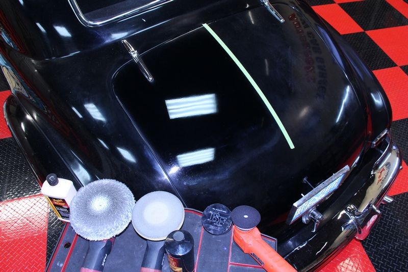

SOLVED! I wont bore everyone with the litany of firmer pads and more aggressive polishes that I went through to figure this out - I’ll just cut to the chase. Yellow pad with Yellow Top Rupes Fine was working - but it was SLOW going. During a break, I grabbed a super soft foam wax applicator pad and tried a few drops of Car Pro Fixer on a particularly bad area, and the crap I was seeing just sort of wiped away with almost no pressure. Just a few swipes and you could literally see it wiping away and leaving crisp black paint behind. Even under the Scangrip light. So I swapped back to a soft White Rupes pad and gently walked the whole car with Fixer and the filmy mess is now completely gone. Im taking a break to enjoy a huge sigh of relief, then I will get a fresh white pad and do the whole car with CarPro Essence. I may decide to use Essence Plus as the LSP for this car since it gets such limited fair weather weekend car-show use.
Here she is. CarPro ‘Fixer’ on a Soft White Rupes pad. CarPro Essence on a Soft White Rupes pad. CarPro Essence Plus as my LSP. This will allow for quick and easy spot ‘fixes’ with Essence and Essence Plus - without the need to remove a more durable coating just to address areas of light toweling marks.
I will say, even though it is advertised as a more aggressive product, CarPro Fixer with a soft pad left a near final finish. One or two passes with Essence was all that was needed to really sharpen the reflections.
