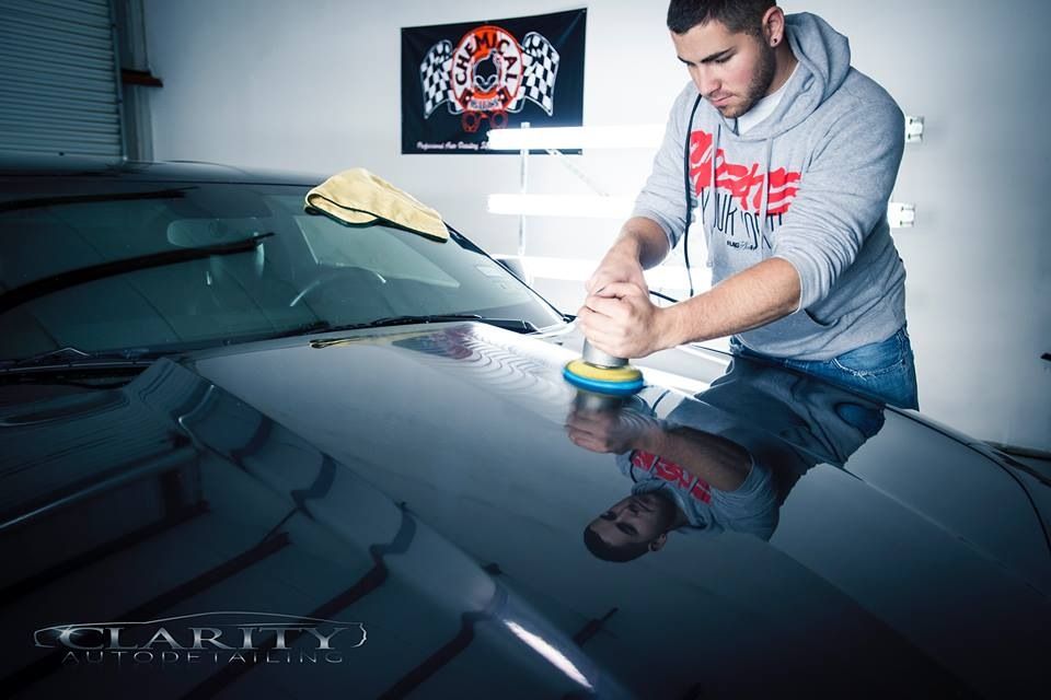

Last night we gave it another go. Slowed the tool way down. It is still difficult to work with. My surface couldn't be dirty because there was no difference between first pass and third, so its not a contaminate issue...its just plane hard to work with. Id say it was 45 degrees in the shop but I kept my panels pretty warm and it seemed the warmer it got the more troubles I had. but it you power through it and finish off the pass smooth....HOLY COW does it finish well! INCREDIBLY well! If this stuff wasn't so finicky it would be a game changer.
Has anyone else experienced another compound that finishes THIS well with a cutting pad?
After my heaviest pad and M105, we went straight to a finishing (not polishing) pad, and a jeweling polish, it finished THAT well.
This is one of my guys starting his FIRST section on this hood. Everything but his small work space you see, is a heavy cut pad and heavy compounded finish. I, am impressed.
m105 is my least favourite compound, it works well but can be finnicky I agree
Im glad I learned to work though the pains of it....it finishes astonishingly well
