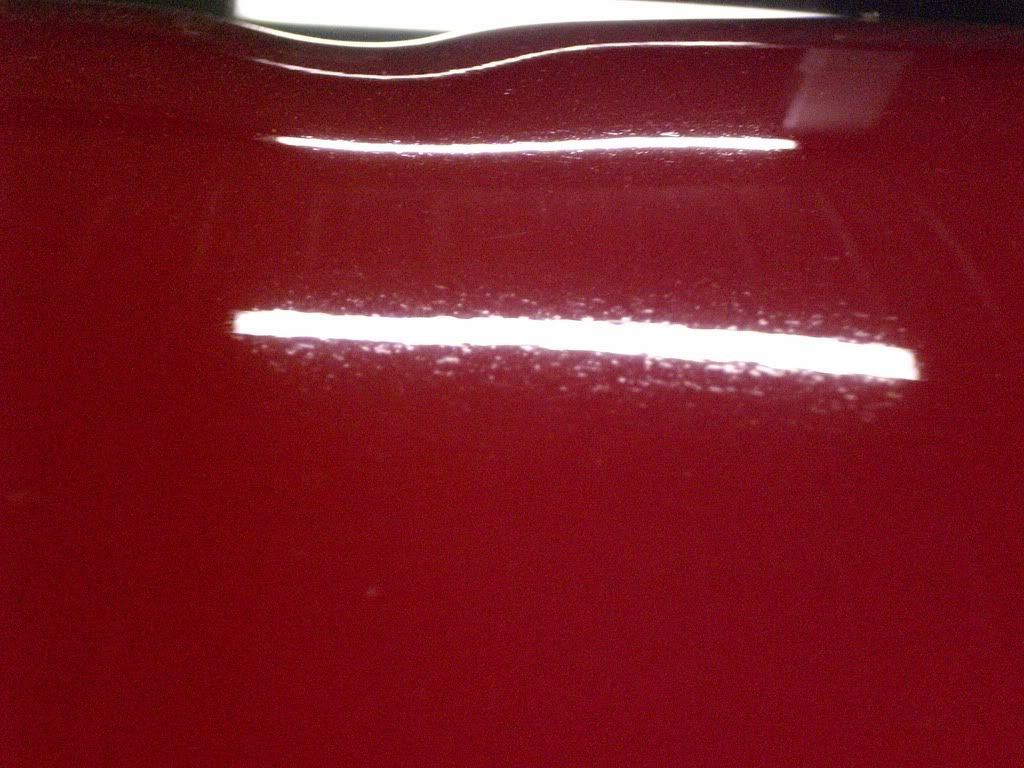

New to the forum, and new to detailing. I got a lot of advice from the Corvette forum, and I am just looking for some more. I have a 2001 Corvette Zo6 that looked good from far...but far from good. I bought the PC and the intermediate swirl remover kit from Autogeek (XMT #3 with an orange LC pad, XMT #1 with a white LC pad, and XMT glaze with a grey LC pad). These products worked well, I thought, until I noticed all these spots on the hood, roof, and trunk of my vette. These are the only areas I have worked on, but I am not sure if these defects were there prior to polishing, or if they are simply more noticeable now that some of the fine scratches are gone. What do the experts here think?
This looks worse in the picture, but here it is.
Here is a picture outside in the sun.
Looking at the picture and my bad eyes..it does look like micromaring from the XMT 3...your best bet is to now use a finer polish and a polishing pad....use something like XMT 2 or 1 and rework the areas slowly....wipe occasionaly to inspect your work to see if they are removing...

judging by the pictures, I would say yes. consider a finer polish to finish with, like Pinnacle's Advanced Finishing Polish, which is my personal fav. good luck!

So far, the hood has about 4 passes with XMT3 (orange pad), 2 passes with XMT1 (white pad) and 1 pass with XMT glaze (grey pad). Unfortunatly, I did not pay close enough attention to see when these spots appeared (after which step) so I am not sure what compound is causing the problem. I am having a problem with my PC now (my velcro backing pad melted) so I need to place an order with AG for a new backing pad, and some new LC pads. If I should get a different type of polish, please recommend what I should get.

Did you clay the vehicle ahead of time? The first picture looks like some type of contanimation which'll need to be removed by claying.
Try using the XMT3 with a white pad and then bump down to the XMT1 and another, clean, white pad. That should clear any of the light micromarring that remains.
That is indeed micro marring, I can tell because I've had the same on my Dodge before. Work your finishing polish longer and slower. For example, go from SSR3 to SSR2.5 to SSR1. A nice gradual decline in pruduct and pag aggresiveness should do the job.
The car was washed with dish detergent to remove any wax, clayed, and washed again prior to starting. The surface is very smooth to the touch (I can not feel any contaminaints).
If you are working XMT3 with an orange pad first, you are using a very abrasive combo. I would then move to white LC pad and same polish first. Once that is done, then move to a grey finishing pad with XMT2 or 1 as needed. You can then use another grey or blue pad with XMT1 as needed.
Remember these are step by step polishes, and pad dependant. They dont finish up as easily as Menzerna does initially. You also appear to be rushing polish, allow it to dry and flash as you use it and stop counting passes. When it hazes to a cloud from a wet paste you can slow down, finish, and wipe off. Before that and you are likely rubbing a sandy paste on finish.
