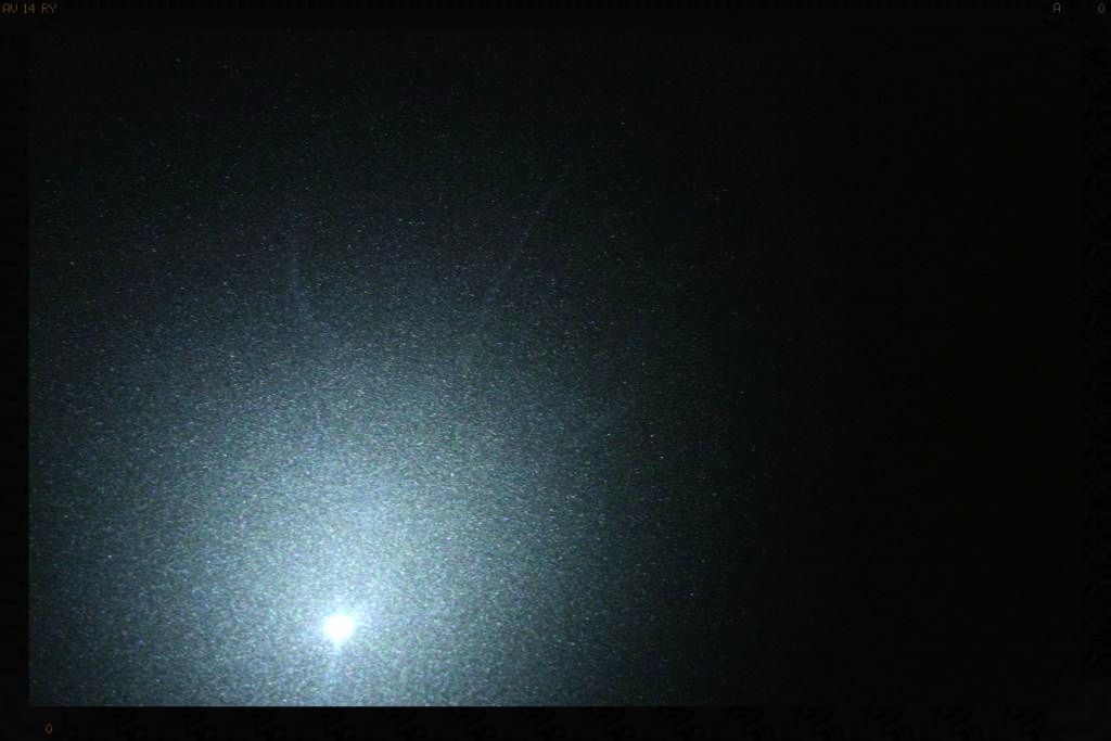

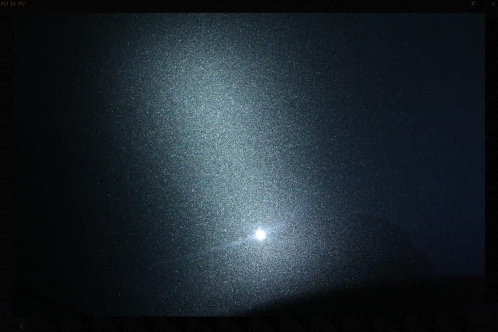

Upon querying this with the owner he admitted that it had been sent to a well known (over here) 'glazing' company for a 'detail'..... :dunno:

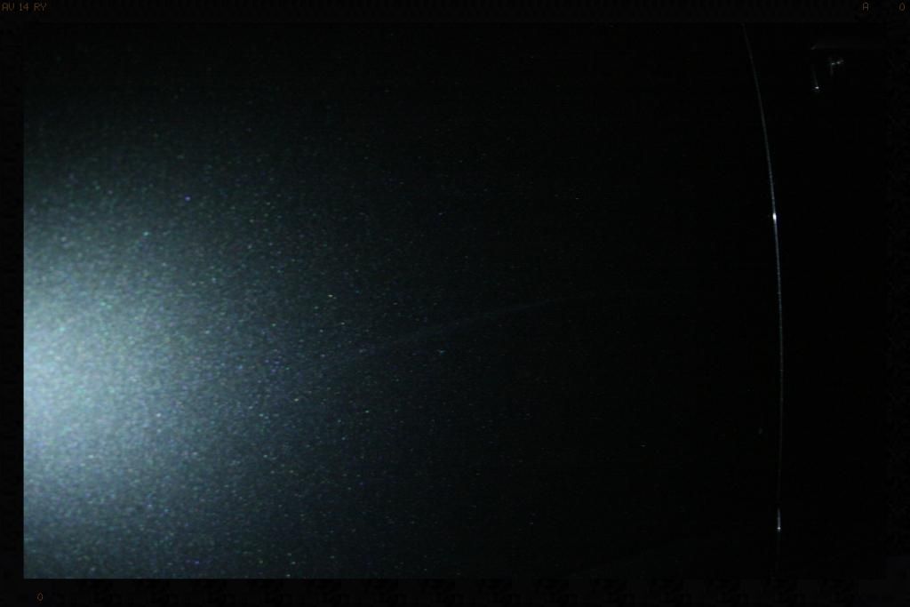

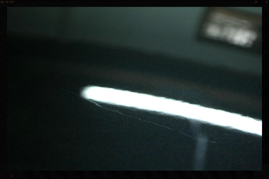

Knowing that rain was predicted for the remainder of the weekend and that there would be no sun to capture the holograms nicely, I tried to capture them as best as I could in the garage. The problem being that none of my lighting was showing them nicely, so I eventually landed up with my a torch app on my cell as the light source, and the DSLR to capture the pics with - unfortunately trying to hold both and manually focus (auto focus kept 'hunting' for sufficient contrast to focus on) proved to be a little tough, so apologies in advance for the crappy pics
At this point I must acknowledge that for the most part, whatever swirl removal they had attempted had yielded fair results.... there were only 4 sections on the car where I had to remove swirls that they had missed, but it was their finishing off that left a lot to be desired (i.e. a glaze used to mask the holograms instead of following up with a 'refining polish' to remove them. Of course it is impossible to know if they removed more clear than was necessary to remove whatever swirls may have been in the paint.

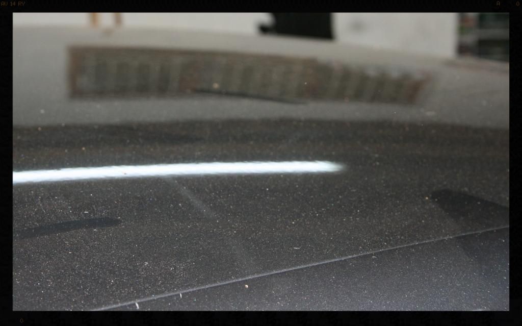

Before moving the car out into the rain I snapped these 3 pics showing the surface dirt on the car
and of the many RIDS on the roof (which were unfortunately too deep to safely remove)

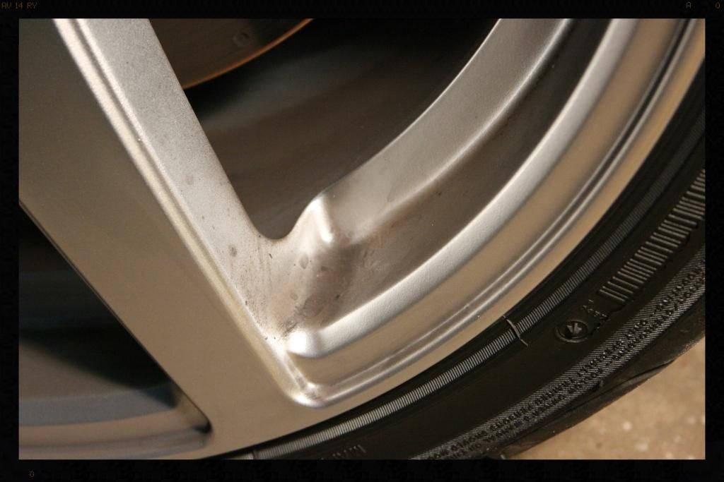

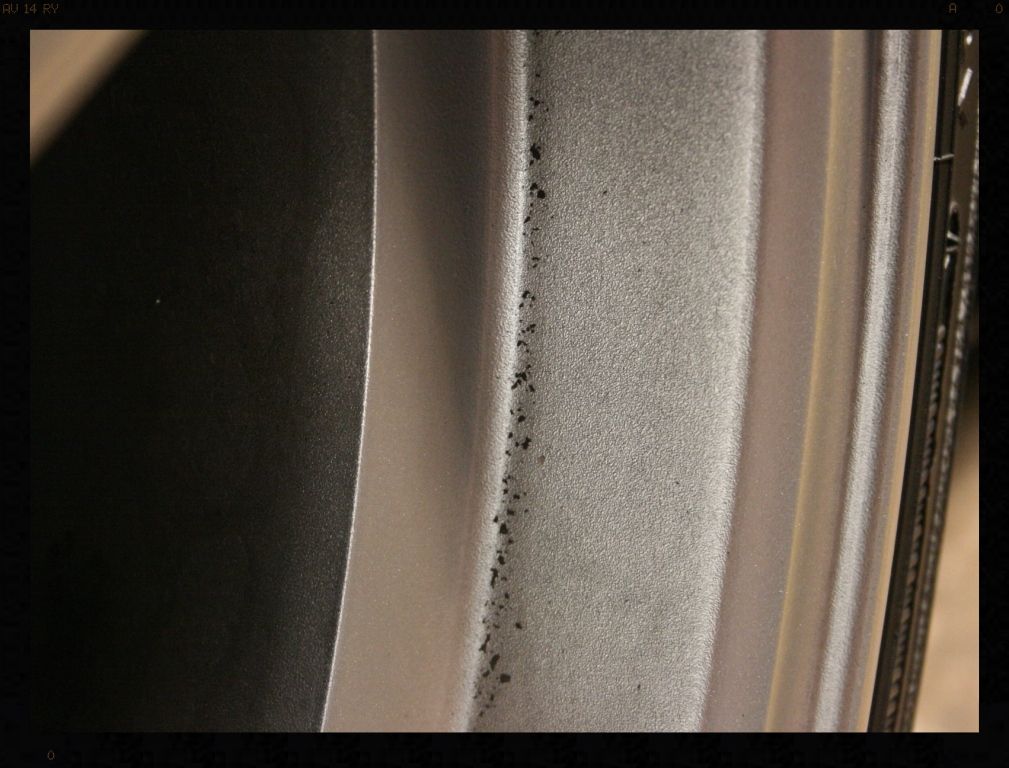

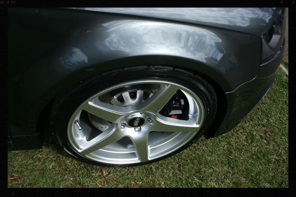

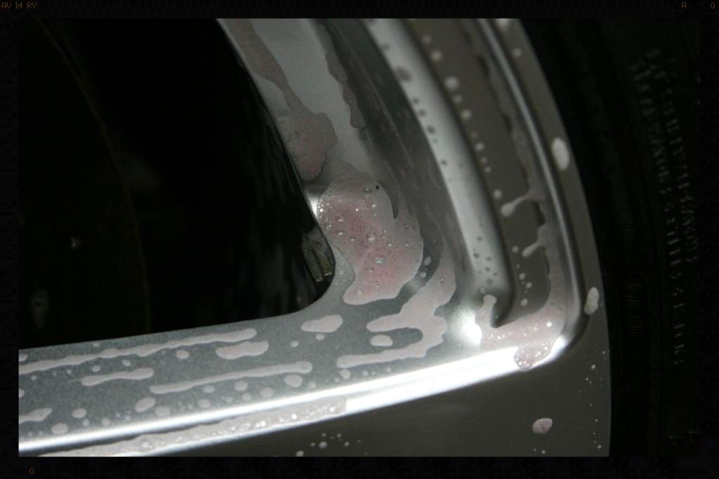

So first up were then wheels, tires and arches.
They were washed using Autofinesse Imperial Wheel Cleaner diluted at 1:1, the tar deposits were removed using Autofinesse Oblitarate and the Iron deposits removed using Autofinesse Iron Out. The rims were then clayed using Clay Magic Blue Clay and later in the detail were sealed using Smartwax Smart Sealant. Tires were dressed using Optimum Optibond Tire Gel and the arches dressed using Chemical Guys Bare Bones.

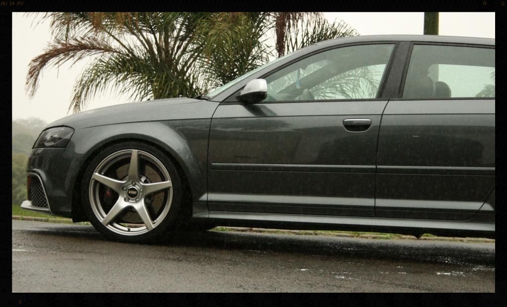

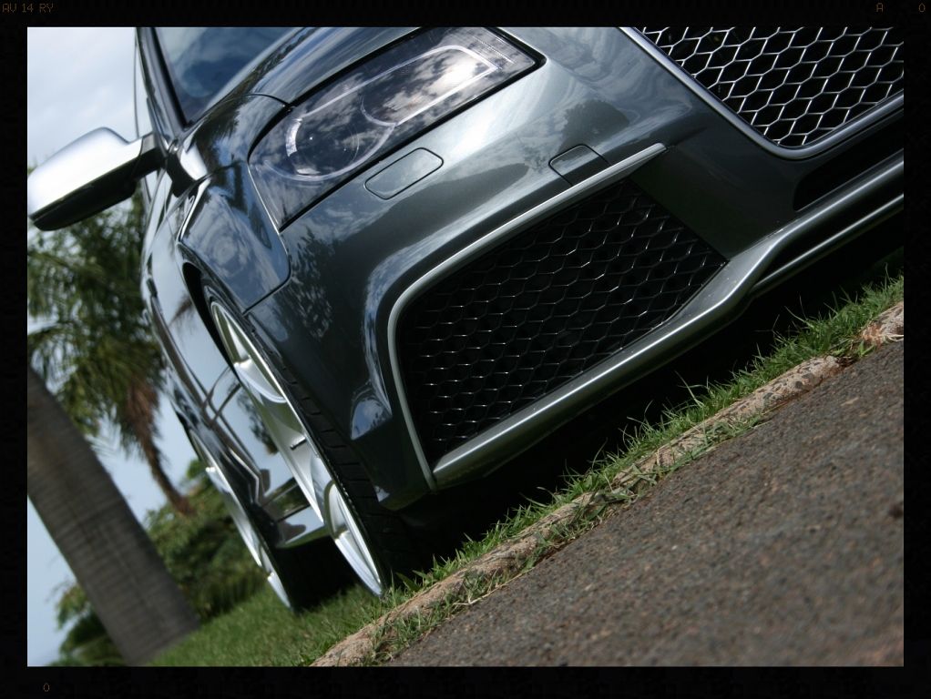

At this point the sun decided to make an appearance so I quickly pulled the car out to check my work and snap some sun shots....after taking these the car was pulled back into the garage where the following was completed:

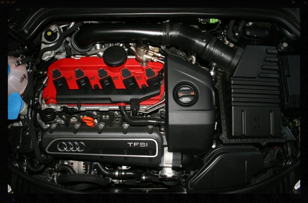

5. Engine bay blown out/wiped clean / dressed
