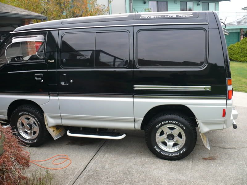

I'm obsessed with paint correction and have been doing it for a number of years. Glad to be a part of the community... Anyways I import cars from Japan and they have their own unique issues such as pollution and weird polymer sealants... here are some that I've documented (I'm usually to busy to snap pics)
A friend had just gotten back from taking a back route on a couple thousand km journey with his kids... thank god it wasn't winter, but it still had the obligatory west-coast pinstripes. Gotta love the artwork too.
Presoaked with Foam
Horsehair detail brush around all bezels
Rinsed
washed
3 Stage Polish/ The stripes were deep so first stage on black paint with wool pad. Then moved onto green to lift the swirls, and finally a soft black pad with fast gloss to get the surface level for wax.
used claybar gently on silver area to pull off contaminants then also ran 3 stage to level and wax.
before
after (Flash wasn't working so I couldn't actually show how well it turned out)
