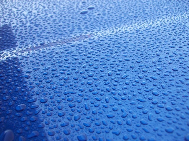

When was it repainted? That looks like a single stage paint to me. If it is, then try a pass of meguiars #7. Don't color sand till you know exactly what is happening with the paint.
It looks like there is missing paint on the roof. How much did you sand? And you used a machine to color sand?

I dont know much about the paint i bought the truck from a kid a month ago been working on it. The hood is after I have used a bottle of number meguiers 7 on it already..

I did do the meguiers clay system on it then I used number7 didnt get the results I was getting with a 3 inch buffer with rubbing compound. Its just taking forever with the rubbing compound. I got fast results wet sanding but burned through the paint fast too. Is their a rubbing compound you would recommend??

If asked to go do your car I would use a wool pad, (orange foam pad) and use 3M compound lightly and little bit little.
And then polish and wax

IMO 3M running compound, 3M polish then some wax. Reason I keep bringing up 3M is cos you could find it locally and not have to wait for shipping only to find out it did no good.
If a 3 inch buffer is all you have then let it take forever. Shouldn't be that long though.

I am new to foam pads, but a medium to heavy cutting pad with the 3M rubbing compound would be my best bet.
Dont know if they make mini wool pads though. Cos that would be my preference.

find a local paint supply store and by the 3M polish and go to Kragen, oreilys which ever and buy Meguiars Ultimate Liquid wax,
I have never tried Meguirs Ultimate Compound but will soon and from what I've read it might let you skip the polish stage dont know though. I think meguiars sells a polish also.
