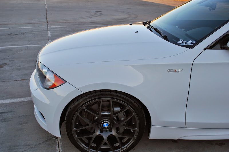

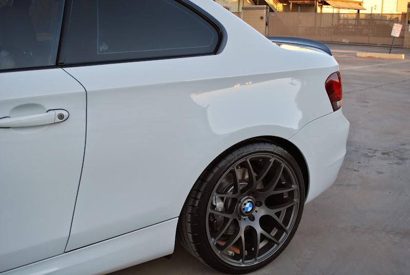

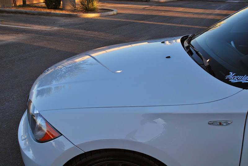

After OC2.0 flashed and the excess removed, I let it cure for a day. Then I was left with a beautiful gloss and shine. The camera doesn't capture the same gloss and depth of the paint as the eyes can see. But it's understandable since it's hard to see it in white.
Afters:
Check out the reflection of my banner!!!

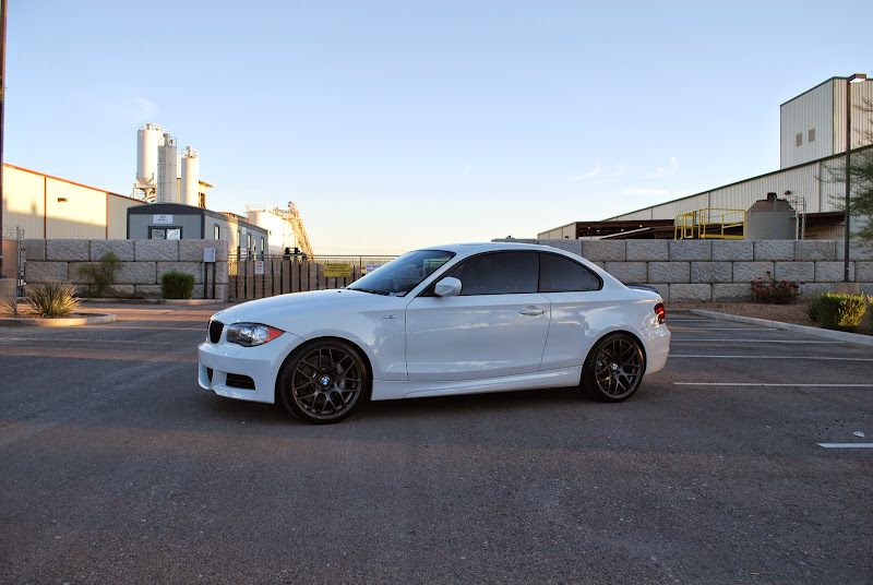

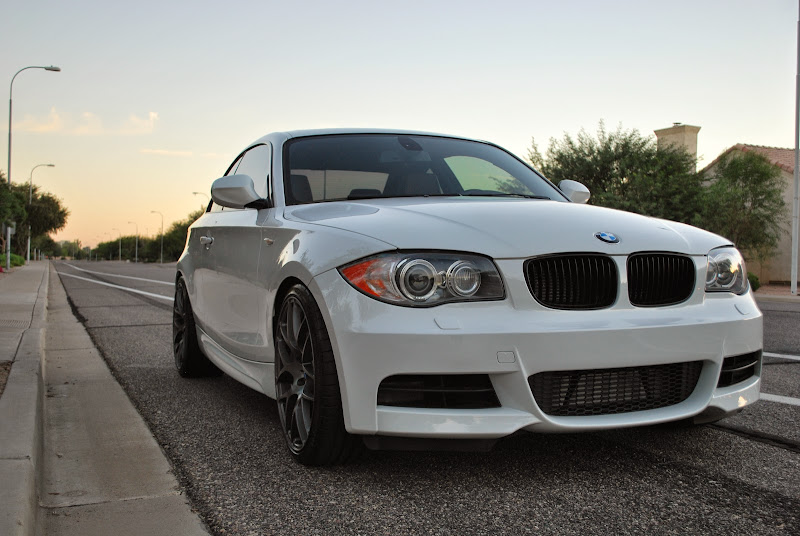

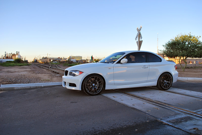

Photoshoot and Sun Shots:
Gotta represent!!!
