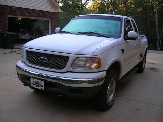

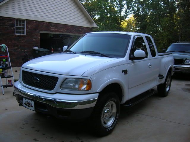

Detailed 98 F-150 last week.
sparkie
Aug 9, 2006
5,357
I just replaced the Monitor for my PC yesterday, sorry so late posting pics!
Wash
Xtreme Foam Formula Auto Shampoo with foam gun. Added ½ oz of Poorboys Bug Squash to mix, for extra cleaning. (Thanks Killrwheels for the TIP)
Wheels wells Purple power
Tires Wesley tire bleach white wall cleaner
Paint Polish
XMT3 Edge Green pad setting 5 and sometimes 6
Klasse AIO Edge Orange light cutting pad setting 5
S100 wax by hand.
Outside Glass
Klasse AIO Edge Orange light cutting pad setting 4
Outside Plastic Chrome
Klasse AIO/ VRT/ Stoner’s Trim Shine
Chrome
Klasse AIO
Wheels Wells
Black Magic tire foam

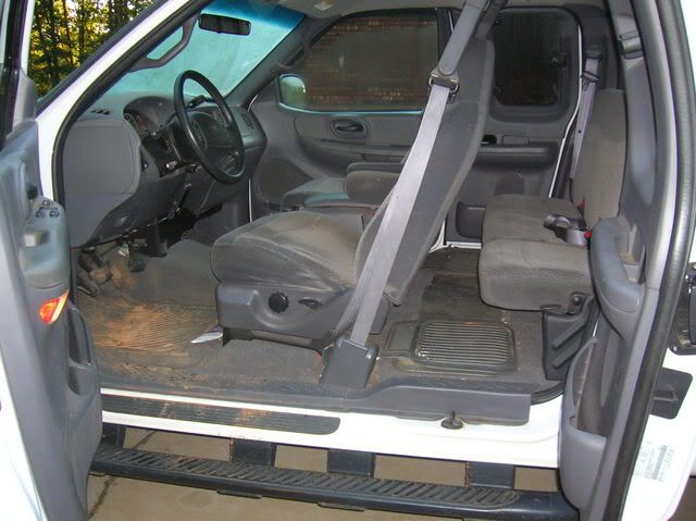

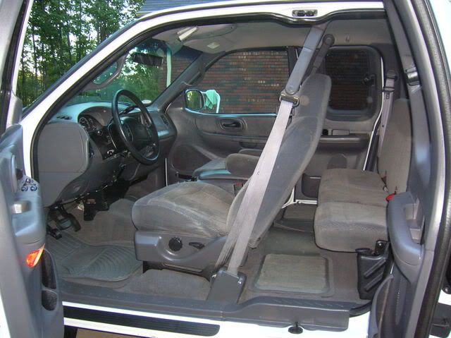

Inside
Vinyl with VRT
Carpet and seats Folex
Stoner’s Invisible glass

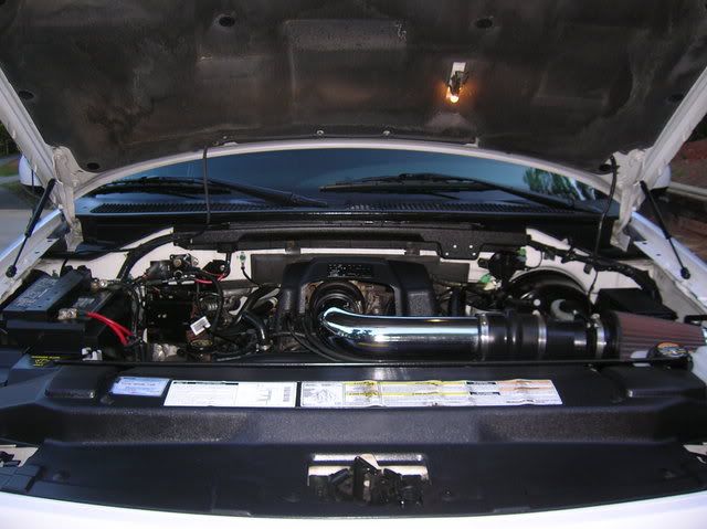

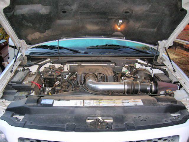

Engine
Clean with purple power
Top with AA tire foam then wipe (trying new stuff)
Comments, Suggestions, Questions are Welcome!
Before and After Pic's

nice job on the engine also
ive never had the guts to clean engines always think something is gonna get wet and blow up
-z
Very nice, Sparkie!! Love the engine bay. I still haven't had the guts. Nice wet look with that S100 on the white paint!!
Nice job with the interior. I noticed those stripes on the front floormats and thought you were playing around with that striping again. Then I noticed they were already that way before.
justin30513 said:
Sparkie.....AMAZING. Nice job on the fabric. Everyone looks at the shine pics. Those are easy. Interiors, well, suck.

Justin, I do have a question. On the seats, it had Carolina red clay stains. I tried every thing I had to get it out. Folex and little green machine, I have the best luck with, made an improvement, but did not get it all out. So some people use APC on carpet and fabric. What do think would work, and is APC safe on carpet and fabric?
When it's bad, and we have Georgia red clay here, I use Meguiar's Detailer Line APC cut 4:1. It's made for carpets and has optical brightners and fabric softners too. I love the smell. It also has antibacterial agents to help out on the smell.
Read about it here.....
http://autogeek.net/mg10101.html
You can even cut 10:1 making it a deal for 14.99 a gallon!
