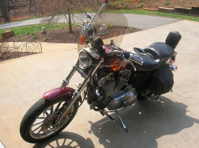

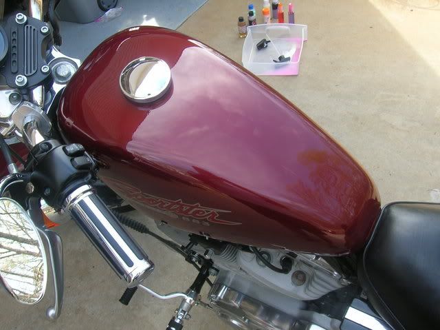

Before pics

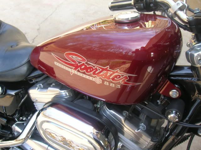

Aluminum 1/2 polish the other 1/2 not polish pic

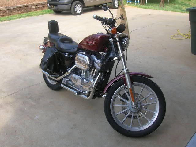

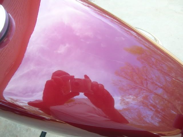

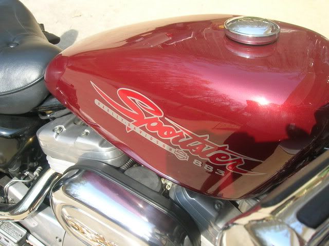

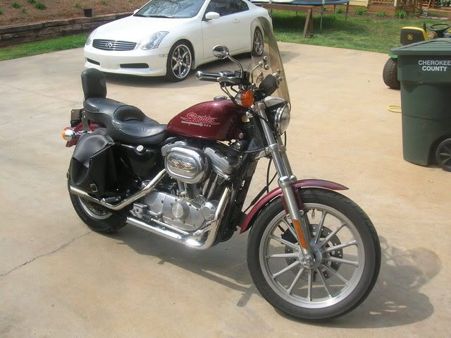

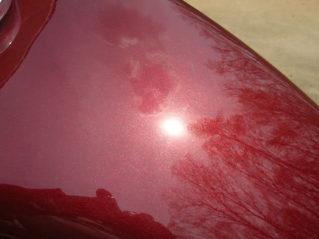

Afters Pics
Yes it does look good.

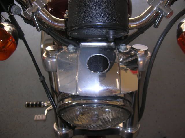

What is your trick for the aluminum polishing?
Mine will never get that good mirror finish to it.
Looks good sparkie! The aluminum really looks great after you polished it. I would have guessed you used Duragloss on the paint even before I read you review. The white car in the background looks familiar.
Mothers power ball mini and a high rpm drill.
sparkie, do you like the Mother's Power Ball? What else do you use it for?
The mini! nice good to know i have the power ball but not the mini
Thank You Sir

Gary, You can use it for rims, cam cover, on about anything aluminum.
