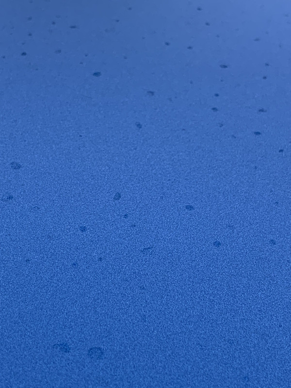

Last August, I applied Gyeon Can Coat to my boss's brand-new Mazda CX-5 in lovely Eternal Blue. The finished result was terrific.
Sadly, that result did not last long, with the owner parking the car on their lawn overnight. And of course, the sprinklers coming on and did their thing. Sprinklers fed by bore water rich in iron....................................
Confusingly, these spots don't exhibit the typical water spot appearance. Even still, I gave them a bottle of Carpro Descale and some Spotless to attempt removal..............to nil effect. Cue, another visit to DFB Garage.

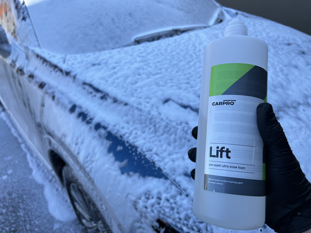

With the rolling stock and exhaust tips taken care of, it was time for that decontamination of the paint. The following is a method adapted from Sandro at Car Craft, a multi-step process that attacks the contaminants from several angles.
First step, I applied the pH neutral NV Purify to the whole vehicle from dry. This was then allowed to dwell for several minutes.
I then foamed with the alkaline Carpro Lift. This is applied over the top of Purify, helping to increase the working time of Purify, while introducing alkalinity into the mix to lift tougher grease and grime.
After another several minutes of dwelling, both products are then rinsed away. It was then time for the contact wash using the acid leaning Carpro Descale, which will then target the mineral deposits left by the water spots. I foamed this directly onto the paint as usual.
