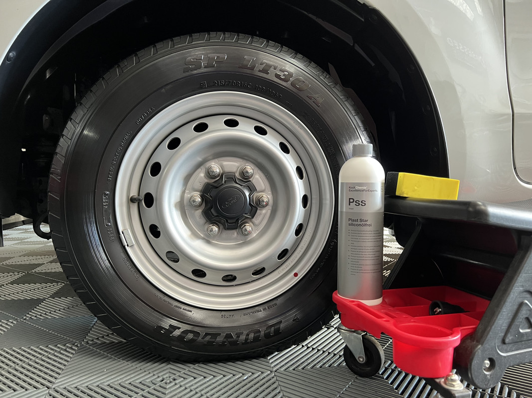

Last job was to dress the tires, today trying out a new application method.
This method I learned about on this forum, using a wheel brush to apply dressings to larger SUV and Pickup tires. In this case I am using Duragloss 253, but any runnier dressing could be used, think Diluted Carpro Perl, Autoglym Instant Tyre Dressing or Meguiar's Hyper Dressing.
Firstly, apply the dressing directly to the brush.
Then start working the product in, I liked that it made it easy to get into the chunkier grooves and right up to the edge of the rim.
