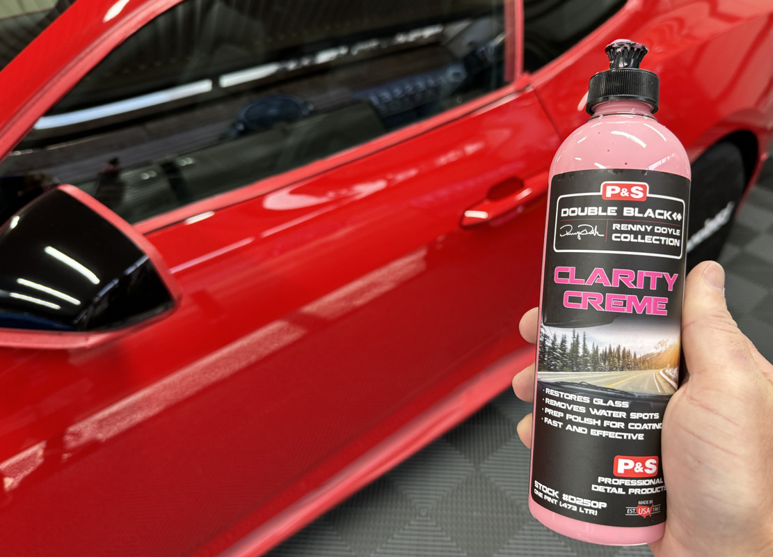

I also got the glass polished today using P&S Clarity Creme. To avoid plastering glass polish all over the rubber trims, I went around the edges with a Carpro glass hand polishing block, which uses the same rayon material as their normal glass pads. I then put a Lake Country SDO Blue pad on my 3-inch ShineMate and took care of the inner sections. I really like this product, its so easy to use and does not require micromanagement like CeriGlass does, or require a sledgehammer to remove the residue afterwards. That 473ml bottle will last you the rest of your life, negating its cost.
