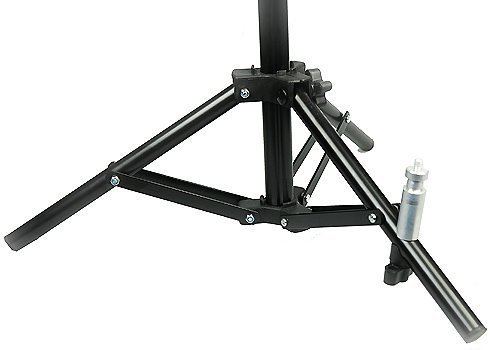

I've been chatting back and forth with Zach about the pros/cons of his lighting system and with his input I set off to find something that would resolve some of the limitations he experienced. One of the expressed cons was that the light would not go low enough to do the rockers without setting the user on the ground to have the proper reflective angle. Well with that in mind I found this little gem
This light stand has a toe stud on which a dual AC bulb flash light can be set up. For $13 shipped (since I have Amazon prime) could I go wrong?? It is definitely not meant to have a heavy load on it and its footprint is definitely not the most stable but does it do the work? Absolutely......

At its maximum height the center of the light is at 44", at the lowest level of the telescopic arm the center of the bulb is at 21.5", and on the foot stud the center of the bulb is at 8". Being that the lights are LED, you can have the light right next to your head and right close to the panel without fears of drying the product or overheating the panel.

Can you please zoom on different angle the clamp or I don't what it is that stick the bottom dual bulb holder on to the one of leg.
It is the same simple stud that is found at the top of the stand... they just added one on the bottom leg as well for lighting backdrops for photography...

I have added some rubber chair tips to improve stability. The size for the stand mentioned in the thread here is 5/8.
