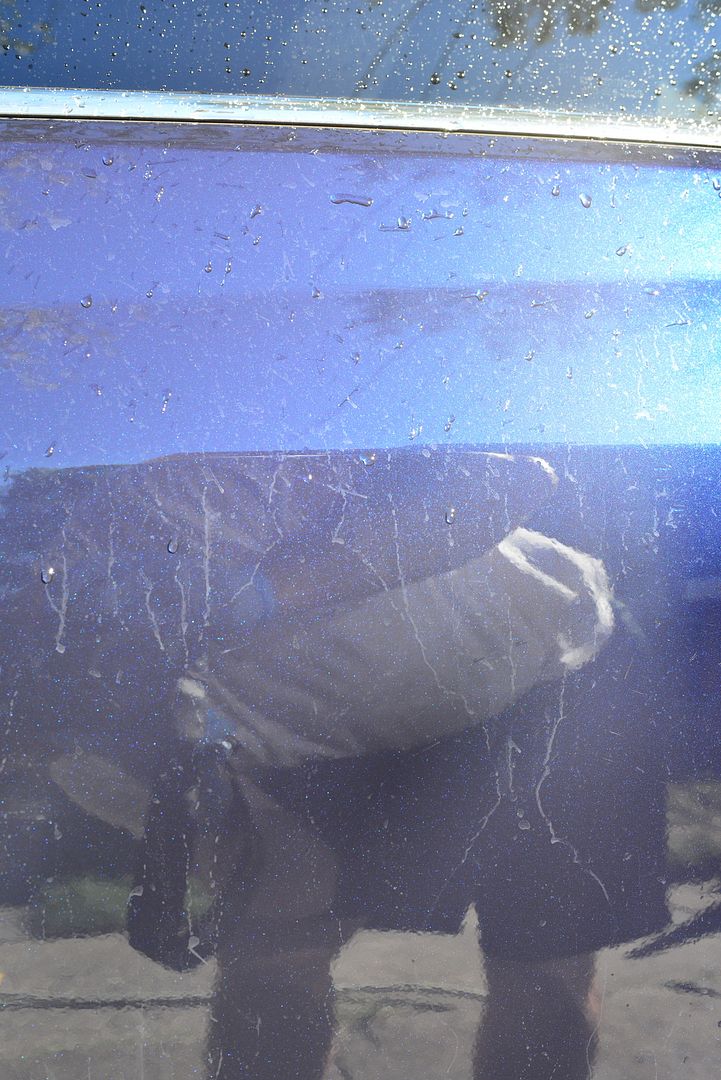

Does Dawn original leave horrible residues? Or is this from drying too fast?
JHZR2
Sep 8, 2015
39
Was stripping the odyssey today in anticipation for polish and CQuartz UK. It was high 70's, clear and dry, and I was out of the direct sun, shaded by some trees.
I kept getting this sort of residue on my panels.
I washed with Dawn dish soap for the purpose of stripping. I rinsed it very thoroughly, but couldn't stop such residue from coming back, making me think it was minerals, not soap.
In the end, I took a microfiber sponge to wet the surface, had my wife work right behind me drying the surfaces, and we got it to go away. But what a pain. How does one avoid them? My home water is filtered through a carbon block system, and Ive not typically had such issues. Thoughts??
That looks exactly like what I have to deal with when it dries too fast using California tap water. The water here is horrible, twenty years ago washing and drying a car was a lot easier and didn't do this.
So its odd that I dont usually get this. So I have to wonder if it is because of the near-drought conditions, that the aquifer is getting higher TDS, which leaves this...

I agree with both points above, and I think that's just Dawn residue you're seeing. I also get that with some other soaps like Meg's Gold Class.

How much Dawn did you use? Seems to me that you used a lot and other variables such as heat & humidity were factors.
Also, I am unsure of the state of your carbon block system - and they do great at filtering water for human consumption. That doesn't mean everything is filtered out. Calcium and many salts, for instance, is not filtered - let alone whether or not the carbon block needs to be recharged. Over time, if they need to be recharged, the system isn't really working for you.

Not being an avid 'dawn' user...I will use it at times for removing road grease (where does that come from?) and the like. Maybe a healthy tablespoon in couple of gallons water works for me.

That looks like too much Dawn. I also found Dawn to give the plastic trim a dry chalky like appearance.
I agree with ski2. If you're going to polish the car anyway, that will remove the LSP far better than Dawn ever will without all the other headaches associated with using it. When I get ready for a full detail I just use my normal car wash soap, sometimes in a slightly higher concentration if the car is really dirty, and wash like normal.
Don't use it. Really no reason to use it, especially if your going to polish. The polish removes everything from the paint.

Honestly, I don't have s good answer. That's why I came over here to learn.
I didn't want to aggressively polish since the van is new, and only had a marginal wax job done at the dealer. My going in thought was that I didn't know that polish/eraser would remove everything, so since i had to use some soap, why not use that?

Fair enough. Probably so. Didn't get very much foaming on the smallest (most dilute) ratio, so I moved up one.
