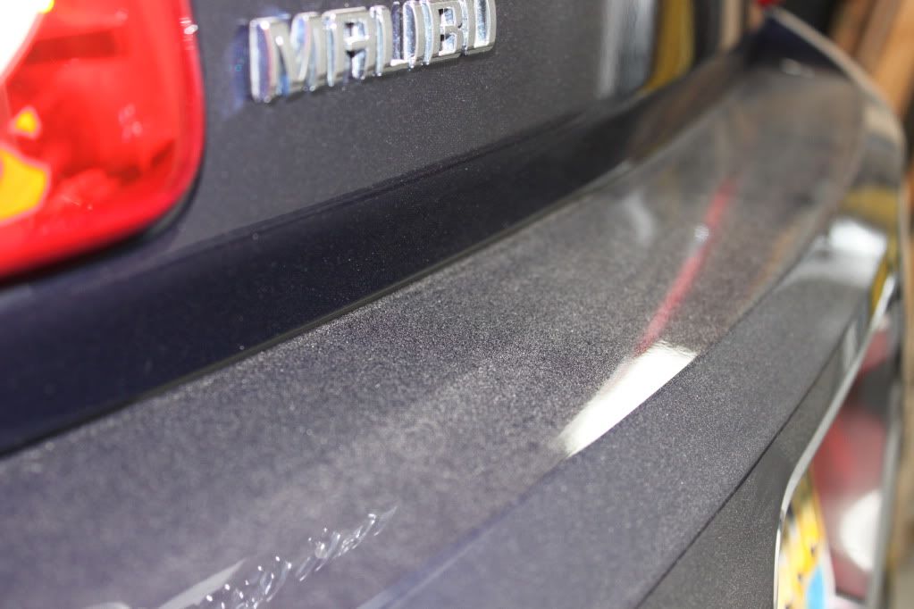

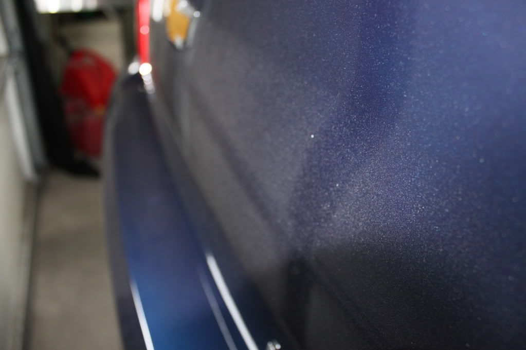

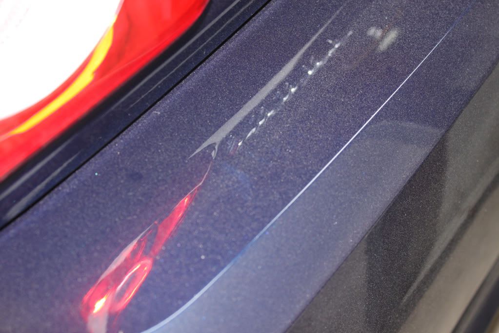

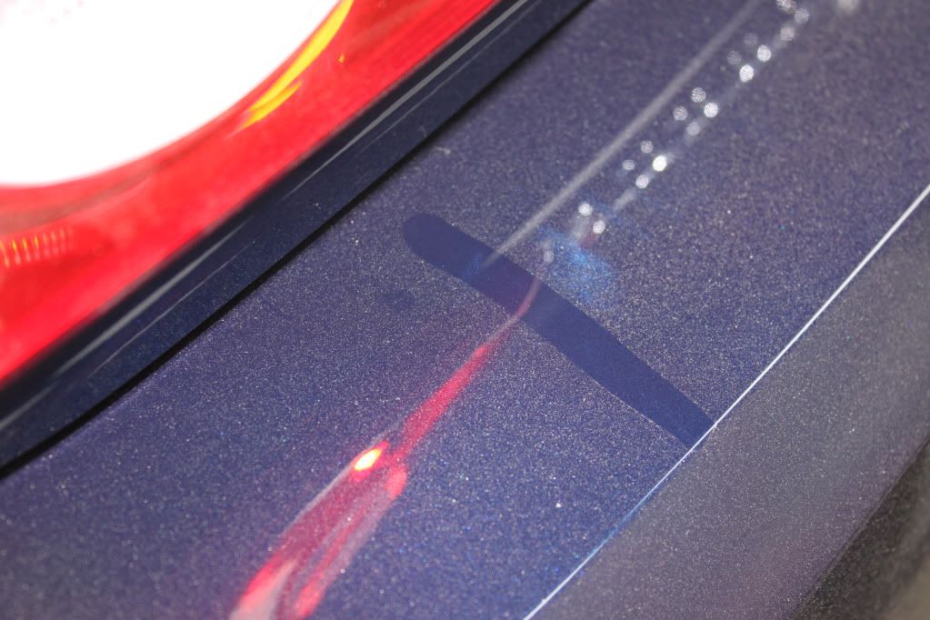

I have seen many thread where people ask about dust and quick detailers so I thought I would put up some pictures of how much is too much.
I tried capturing photos of the amount of dust that would be safe to remove with a QD but the metal flake on the Malibu interferes with capturing it. I would say if you have about half the amount of dust you see in the pictures you would be safe using a QD and high quality MF towel.
These are all pictures of dust that IMO would not be safe to remove with a quick detailer. I would recommend washing the car with an ONR type wash or a traditional wash. Also if you have an air compressor or metro blaster you could blow most off and then hit it with a QD. I went with blowing it off then safely using a QD and pakshak MF towel.
BTW this car had Opti-Coat applied and was wiped down with FK425 shortly before going down the dusty driveway that caused this. Don't fall for the anti static hype that some quick detailers claim ;)
