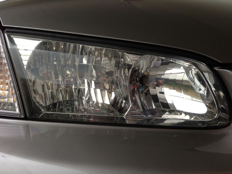

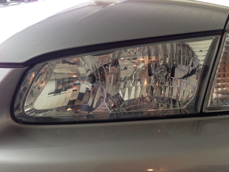

View attachment 64489View attachment 64490
As a reminder, and as you probably already know well, an aggressive compound usually doesn't finish down LSP ready. Meaning a simple follow-up with a finishing polish is all.
Perhaps depends what product? Wolfgang Uber Compound is as its name states, a so called compound, but this one does finish down oh so nicely I've found. This one's always now in my personal arsenal of products.
There's different abrasive technologies, some are referred to as "DAT", (Diminishing Abrasive Technology) some are referred to as "SMAT" (Super Micro Abrasive Technology), and some I believe are even a hybridization-combo of the two.
DAT breaks down from larger clusters into smaller micro particles, starts out more abrasive then breaks down finishing well in its working cycle. SMAT will start with various size abrasive particles per formula, and doesn't break down through its working cycle,
I'd suspect your previous attempts with the Griots D/A only gave you what could be called a "glorified wax job" was all. Meaning you probably haven't done much in the way previously, of knocking down or diminishing much of the thickness of the clear coat to be much concerned about.
When I first got my Porter Cable D/A here from Autogeek and all the goodies to go with about 5 years ago, I knew jack about these newfangled D/A machines, never used one quite like them. I wasn't about to break it out first on my beloved Tahoe SUV, but had commonly used most, if not all the products, tools, and processes I've ever bought here on my once owned shitbox 2001 Kia Spectra instead.
The first time I did the Kia, with Wolfgang Total Swirl Remover, I only had a smaller backing plate and a few small 4" Pads to test. Got pretty good results, a striking difference from before, but as I found later, still no cigar cause I was still a cherry with this tool, and the combo of products, was still learning the ropes so to speak.
The second time around, re-thinking, studying some more, re-fining technique, and processes, I got better considerably. I wasn't about to give up, and I feel today it has all paid off.
After I began getting the results I sought, I had seriously considered selling my mint boat anchor Milwaukee Rotary. Put in on a local classifieds twice, and yanked the Ad twice, with the thought I'd be losing good money for what I paid for it, and that one day I might regret the sale, that I'd be needing it for some special purpose.
