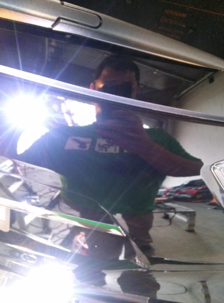

The OP came to my shop yesterday and we were able to find out that the Rogue actually has incredibly soft paint. Removing most polishing residues would mar the paint again with even the most plush of towels. We were able to fix this, however, with some HD Cut on an orange pad/Microfiber cutting pad (left a haze) and HD Polish on a white pad.
We only polished the back door so that we could find a combination that worked well for the OP. He will be polishing the rest of the vehicle after he has some hail damage repaired.

Yeah great results with HD cut and HD polish, just have to get the hail damage I have repaired on June 3rd and then hopefully be able to finish the rest of the car.
im pretty sure you were polishing the drivers side bumper when I took this picture, because this was the first spot that i polished
