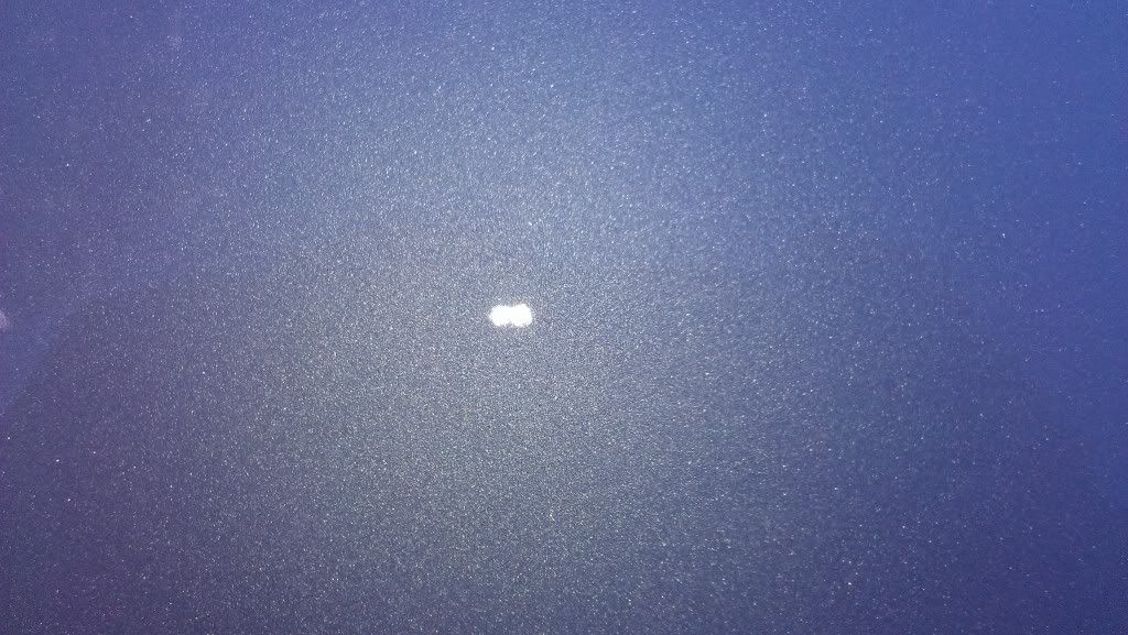

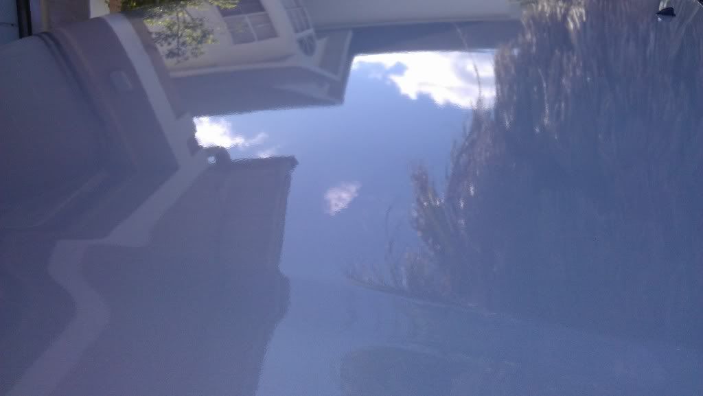

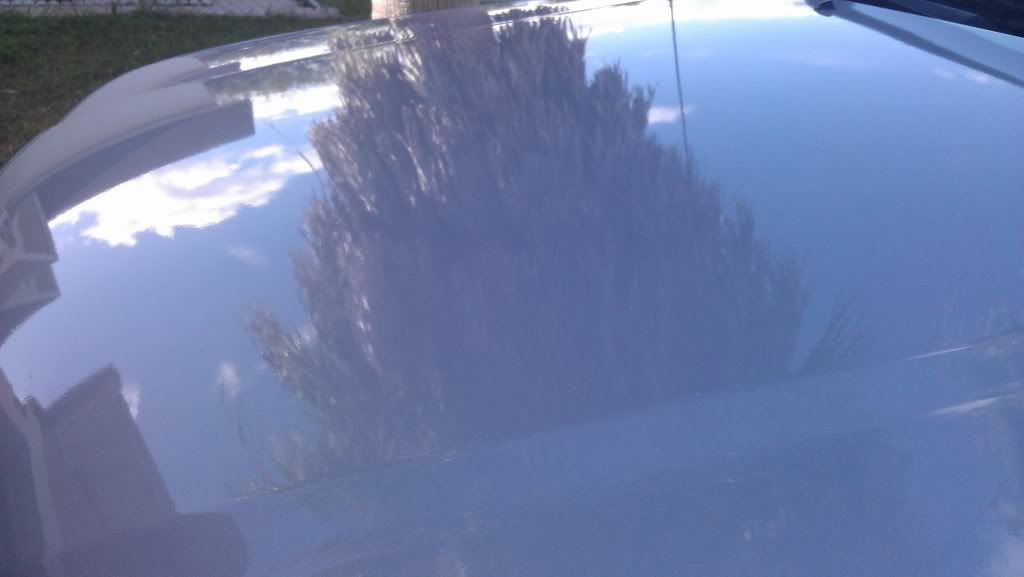

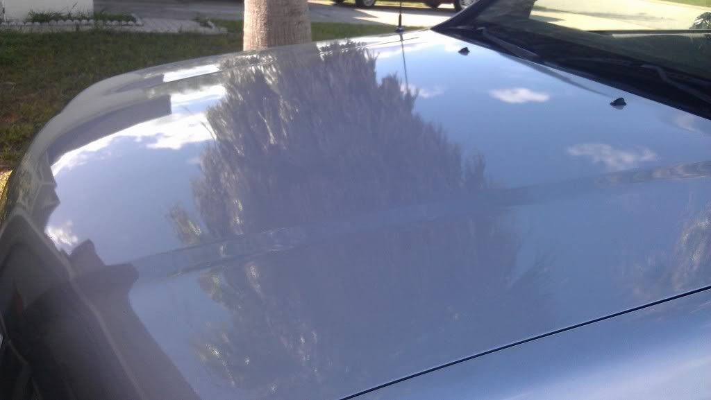

ok just wanted to show the hood of my 1999 Isuzu Rodeo, only did the hood just to see how it came out although wish I would've taken before pics. it was pretty dull and had some light swirl marks, This is my first time with the Porter Cable 7424XP
My Process:
1. Washed the Front Cap.
2. Claybar with Griot's Garage Paint Cleaning Clay & Speed Shine.
3. Megs Ulitmate Compound on Lake Country Orange Foam Pad 5.5
4. Menzerna Power Finish on Lake Country Green Foam Pad 5.5
Nice looking mirror finish
No more swirls :)
Just want to say thanks to Garry Dean for his advice on picking out the Porter Cable Kit and Products :dblthumb2:
The PC is a great machine. Not over powering yet fully capable of compounding to finishing with outstanding results.
