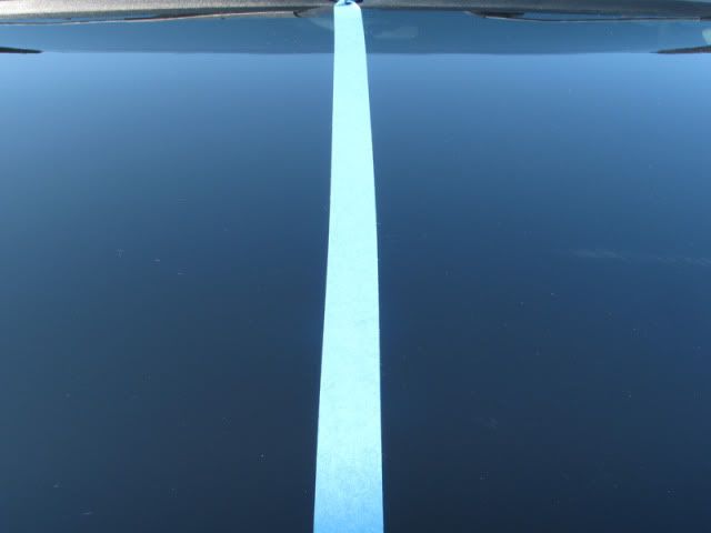

Well I had a mission to use the PC today, since it was about 68 degrees. Not having much money I was using Meg's UC with an Orange LC Flat Pad. I only got to use it on my hood, but it's pretty obvious that I am going to have to get a more aggressive polish. I got most of the swirls out, but I had to reapply 3 times... Not sure if I was doing something wrong, but I tried to remember everything from Mike's videos. Not sure if the best vehicle to start out on is a black TRUCK but it's all I got.
Here's the only 50/50 Shot I have of the hood. It's kind of hard to see the swirls, but the right side was untouched.

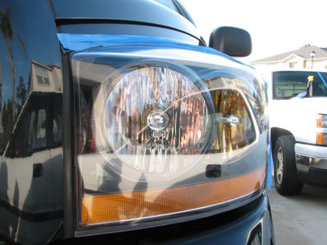

Oh I tried out the UC on the headlights too and they came out pretty good, I forgot to take before shots. But they were pretty bad. Ignore my taping job, it worked for what I wanted it to do.

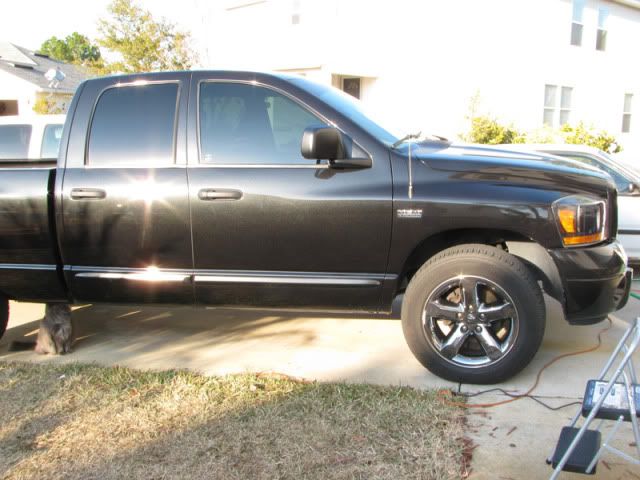

Here's some shots of the truck after applying Power Lock, so far I love the stuff, very easy to apply and remove. At first I wasn't so impressed by the look, but after about an hour it started to show more metallic.
It sounds and looks like you made some great progress and are pleased with the results. :props:
Your truck looks great and as you gain knowledge and experience you'll continue to fine tune your skills making the end result look like glass! :props:

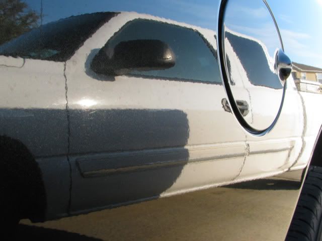

You can see the swirls in the white truck!

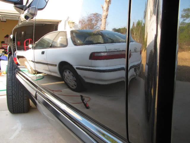

BTW, nice Integra too! I like DAs.
Thanks everyone. Hopefully sometime in the next month or so I can get the entire thing done.
It's my step sisters. It's just an old beater. No tags right now.
