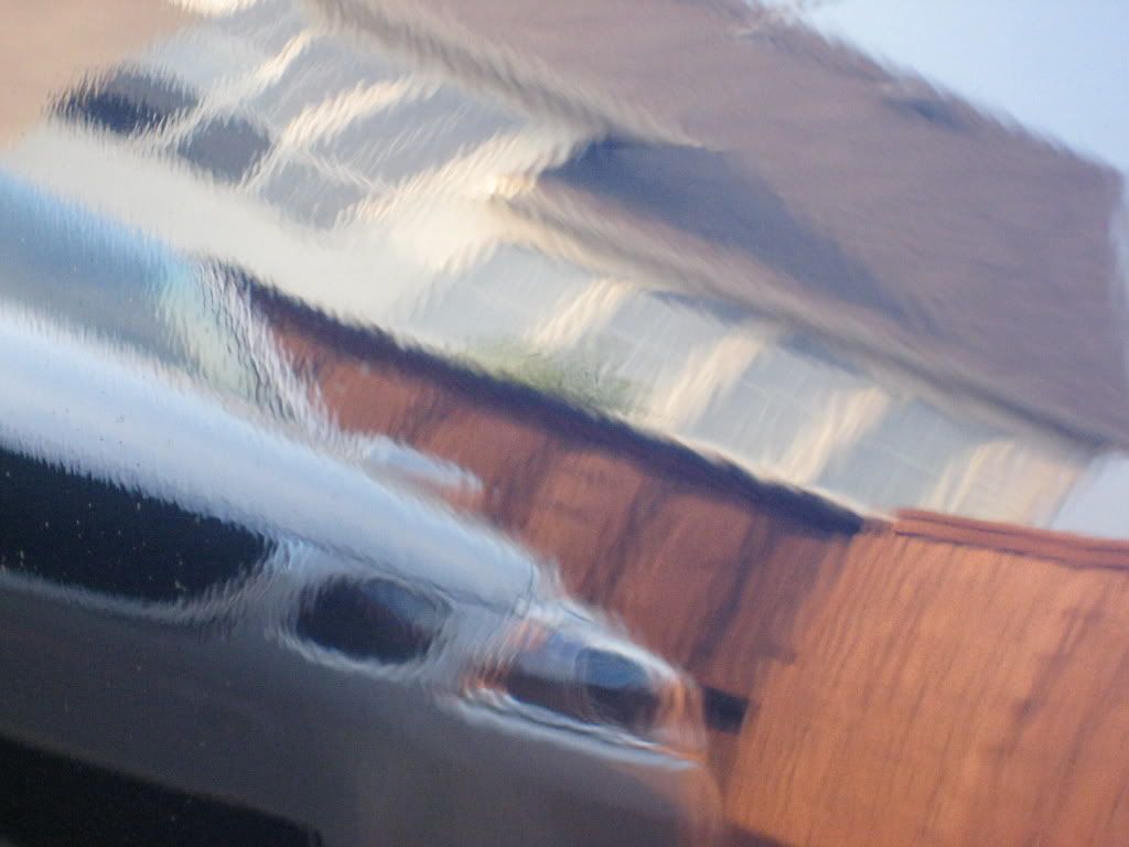

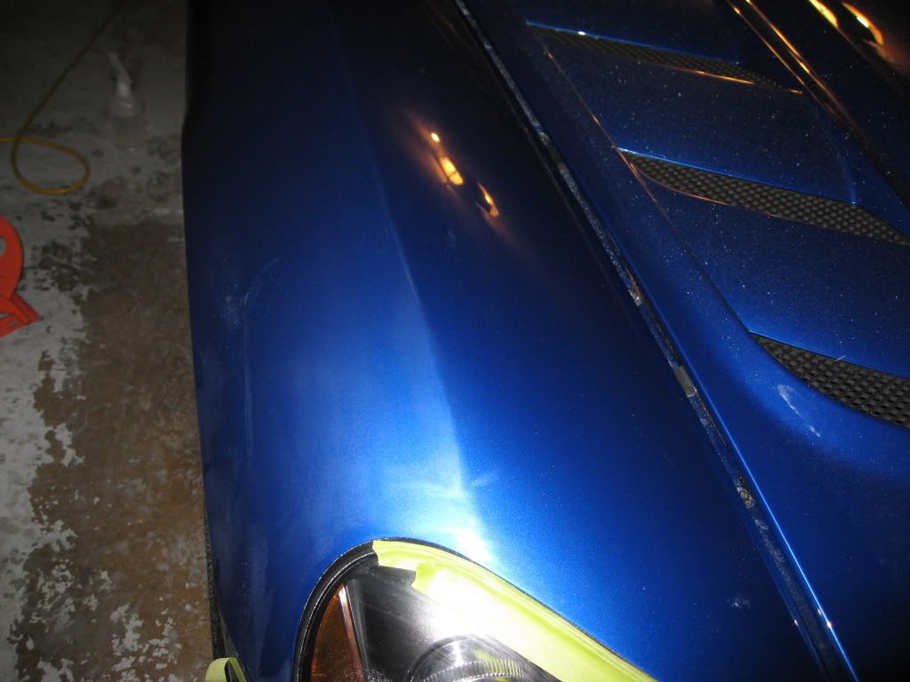

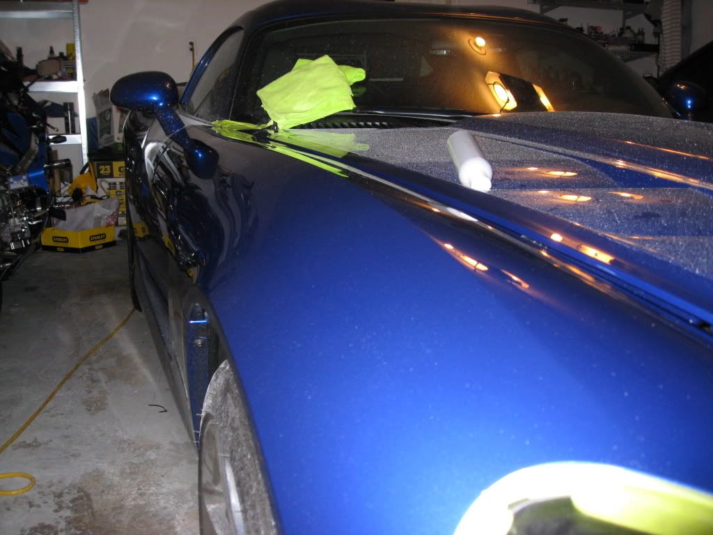

Well, I just couldn't look at it anymore. I think the company that painted the car (Saleen), forgot to wet sand my fenders, as all the panels look good except for my fenders. So last night I went out to the garage and busted out the 300 grit sand paper to take the paint from this:
to this:
So how do I make the paint shiny again? :confused: Suggestions?
Kidding :D

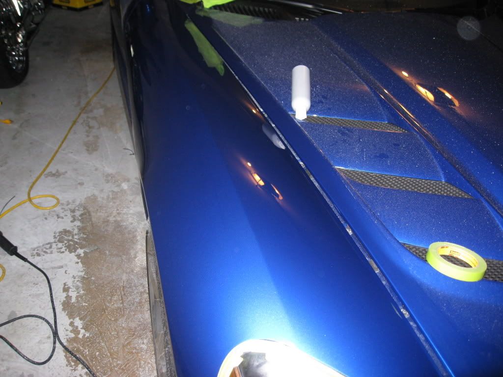

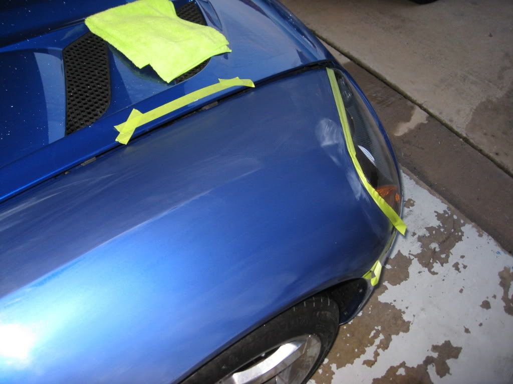

I used 3M 1500 Wet/Dry Sand Paper and a sanding block, with LOTS of time and patience. I'll probably use the 1500 with 2500 afterwards, on the other fender later this week. This one fender took me a good long time, but I wanted it to be perfect. Menzerna Power Gloss on a Edge 2K green pad, and some 106FF on an orange pad helped finish out the process.
In process:

You might want to consider taping or avoiding sharp edges while sanding, looks like you were painfully close to a huge upset.

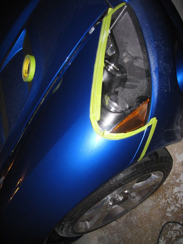

Thanks Jay! This is a VERY time consuming process, and I wish Saleen would have delivered a show ready finish on the entire car, but I'm happy for now.

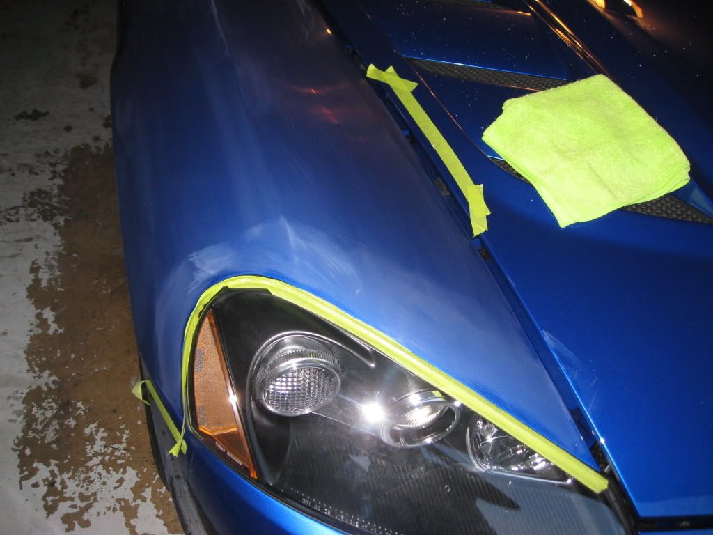

Here's the other fender:
MUCH BETTER!
Cleaning up is going to suck :(
All better :)

Nice job, but I'm curious. Why did you open the hood and create a mess in the engine compartment? Wouldn't the clean up have been much easier with it closed?
