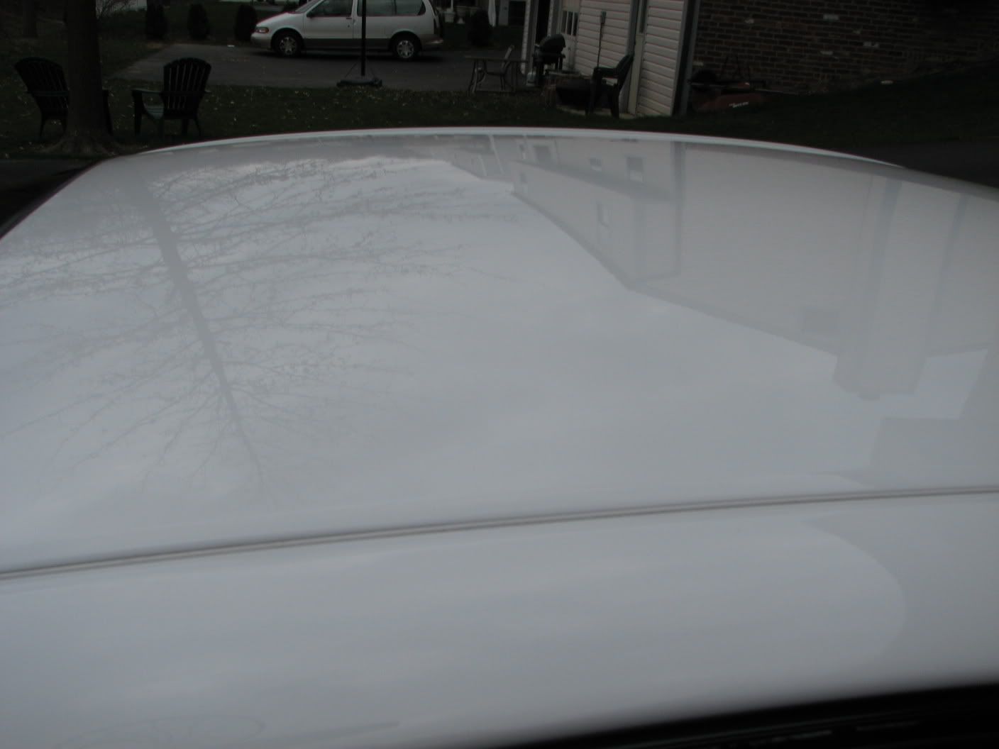

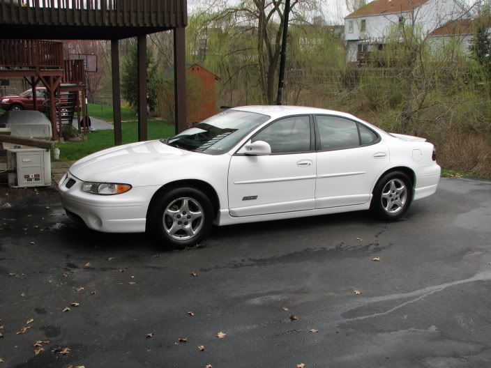

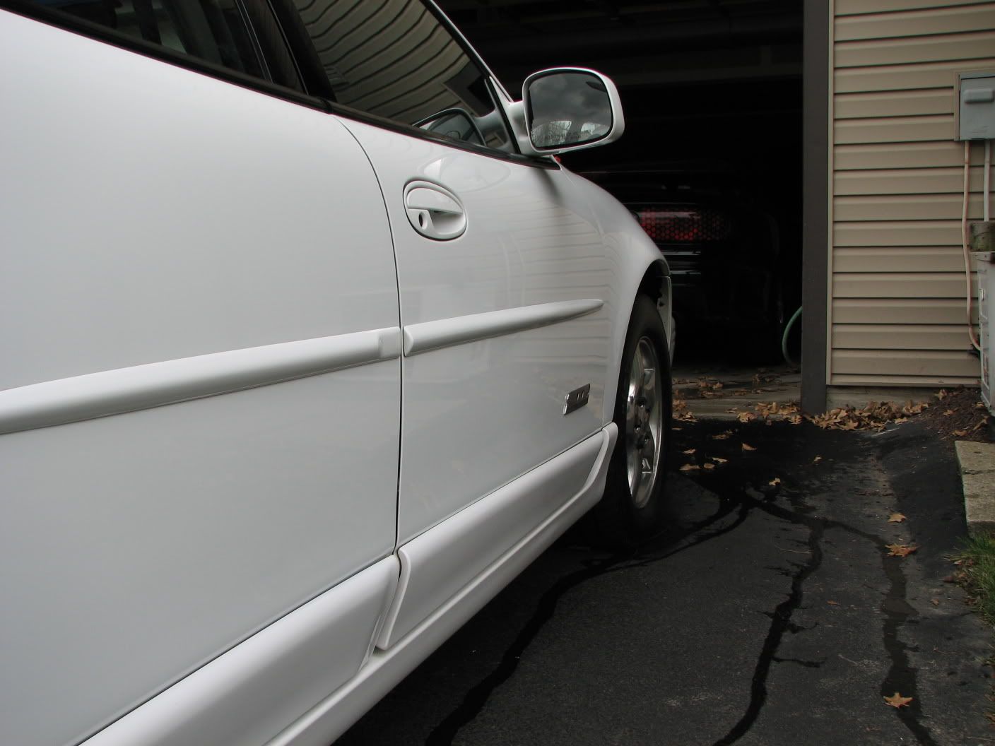

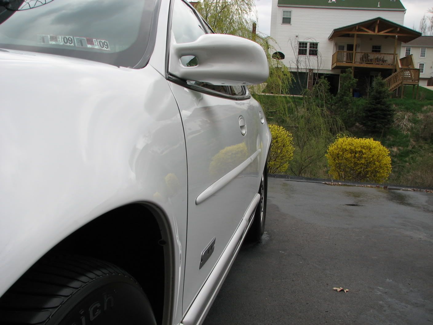

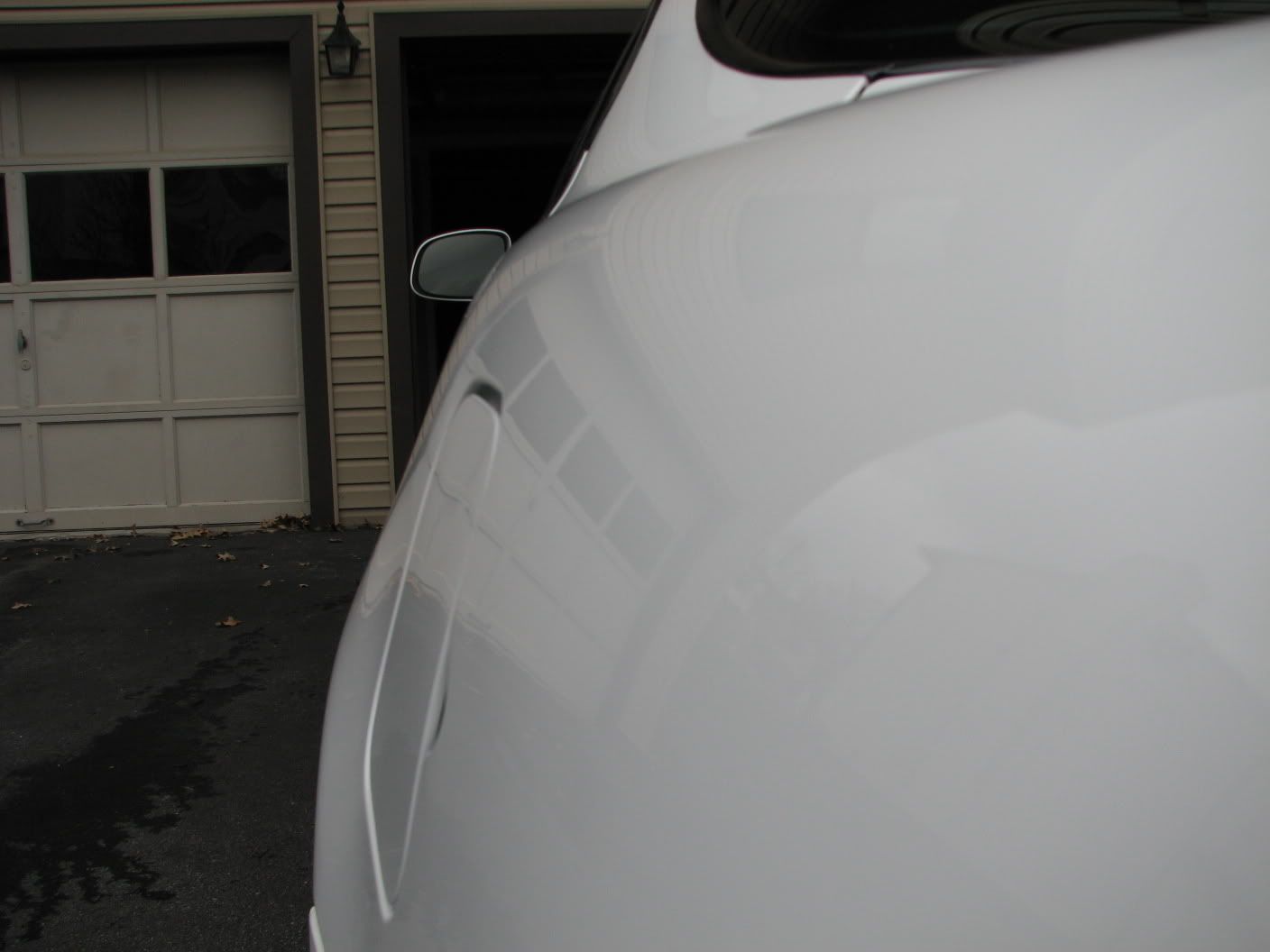

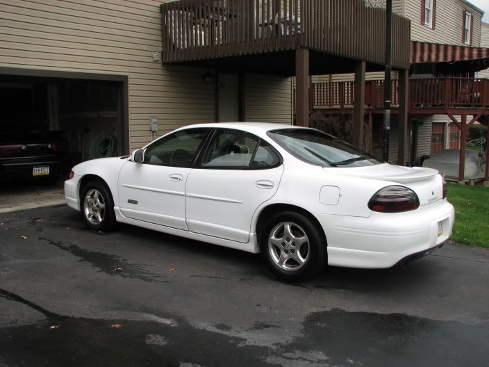

well today i used KAIO for the first time.my steps are as follows.
1.rinsed wheels to cool down and sprayed Meg all wheel cleaner
2.Wash car with gold class soap(2 bucket method)
3.Clay bar the entire car.
4.Then added KAIO w/ pc and a CCS 5.5inch white pad
5.Then added gold class w/ 5.5inch blue pad
6.Let it sit for 30 minutes and wiped of very easy.
7.cleaned outside of the windows with stoners.
8.Sprayed meg hot shine on the tires.
I wasnt really sure how to work with the KAIO.i put it on 4 and just went back and forth 2-3 times and wipped off.I did notice the paint got lighter.i was surprised that the white pad got so dirty even though i used the clay bar.The reason i used meg gold class wax is because before i found this site i lived by it and i have 3 bottles left to get rid of before i can buy more stuff from here.over all the paint is more bright then before.the pictures are dark because the clouds were dark most of the day but it never rained.

looks good ... only problem with white is actually driving it will speckle that pretty finish. I had a white car ONCE for about 4 months and sold it. Never could keep it clean !
Ive always said people dont relize how important paint cleaners are in a detailing process.I paint clean all my white cars even if they dont pay for it because it really makes white look that much better.
so even after clay bar the paint cleaner is supposed to pick up even more dirt?also did i use the KAIO right?cause im honestly not sure.so i just winged it.lol
Clay bars main function is to lift contaminates from the paint i.e rust, brake dust, industrial fall out, water spots, ect, ect. A paint cleaner will strip all oils, old wax/sealants, and water spots as well. Its another deep cleaning step, some skip it while others include it. I view it as option but always include it, it's always made my white whiter.
I was just as surprised at how dirty my white CCS pad turned using KAIO with my UDM. I'd clayed the car beforehand also.
ya the 14 yr old paint actually has a nice glow to it now
