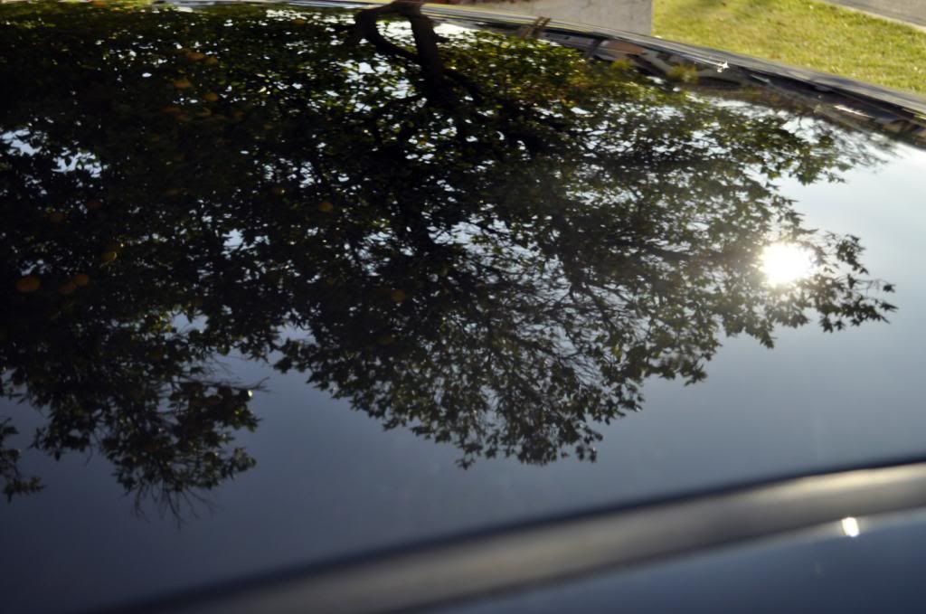

So I bought a GG6 from AG, this weekend was the first try at using it. My roof had some swirls as it had never been buffed out by machine. I forgot to take before pics as I was too excited to finally have a nice day outside to get going. My roof was the only thing I could hit because I took it really slow and just figured out what pads to use. Seems my paint is pretty soft, so I used an orange LC CCS pad to get rid of the swirls with M205. Then I hit it again with a White CCS pad and M205. After that it seemed ok, so I waxed it with megs ultimate paste wax. It is a daily driven 2007 Hyun Tiburon. Will get a shot of another panel to show condition which matches the roof when the sun is in the right spot tomorrow.
