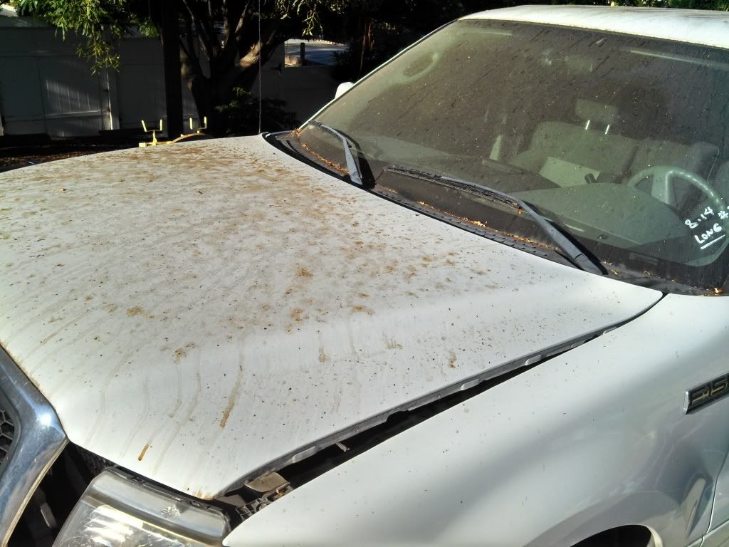

So I guess this beautiful tuck just sits under a tree and a nasty tree it is!

And the culprit! Don't ever park under one of these trees!

after washing only, I needed power to remove this crud
The right side was Nano skinned, the left you can still see the filth in the paint.
TA-DA!!! All clean, shiny and protected. and it's white again!
This shot shows the defects still left in the paint but I was only hired to Wash-N-Wax but at least it's white again and not brown

I'm not sure but at least a year or so. It wouldn't start and the battery wouldn't take a charge. I try to charge it for an hour.
