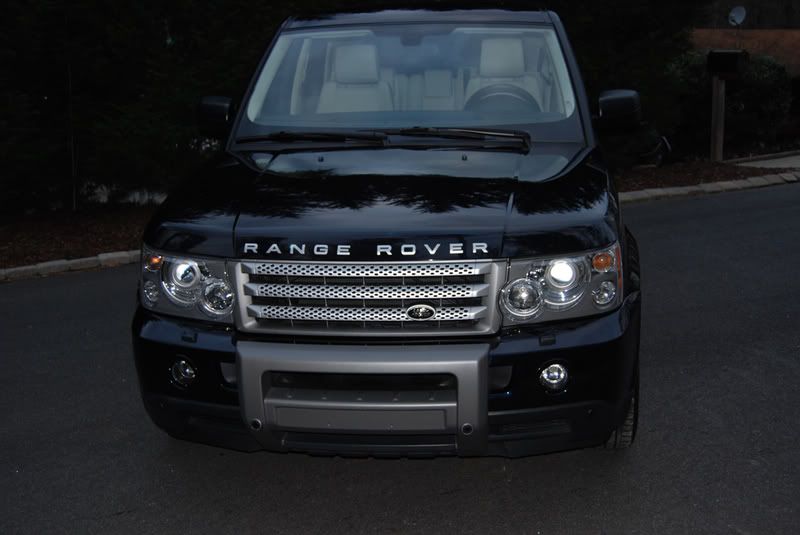

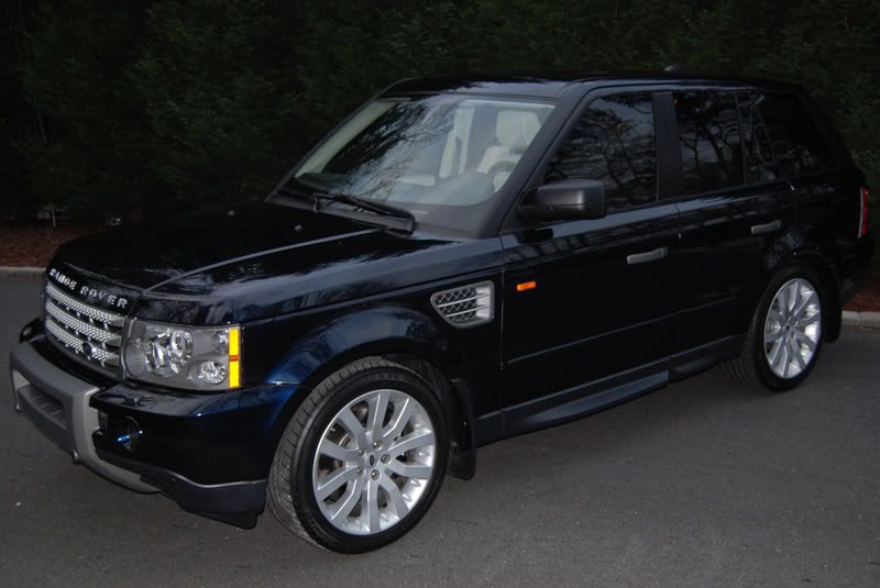

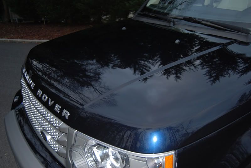

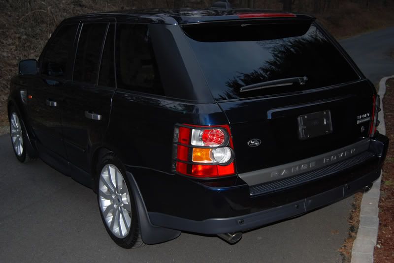

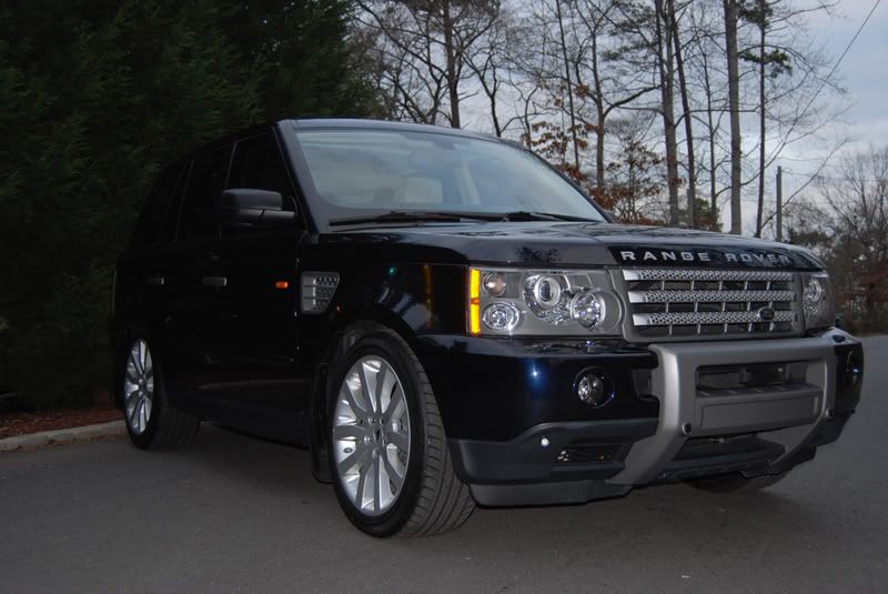

Well I went back and did the Range Rover this past weekend.
They don't look that big, though that is deceiving.
Started with a DP 4-in-1 wash, and also clayed the RR at the same time. Once that was done, and the vehicle was dried. I went with a LC low profile org pad and the PC. Polish of choice was menzerna SIP & Optimum Polish mix. Cobra deluxe jr. to remove polish residue. Then went with DP Premium Surface Shield Paint Sealant for protection and shine.
The DP sat on the vehicle for around 30min, till it past the finger test. Then it was removed with a Cobra Indigo. Black wow was applied to the rear tail light gaurds, and side door trim.
It was getting late, when I finished up. So I am sorry I didn't get any sun shots
Good looking detail. That DP SS is stunning on that dark color.
Even with no sun the flakes are popping on it. Very nice Ed.
