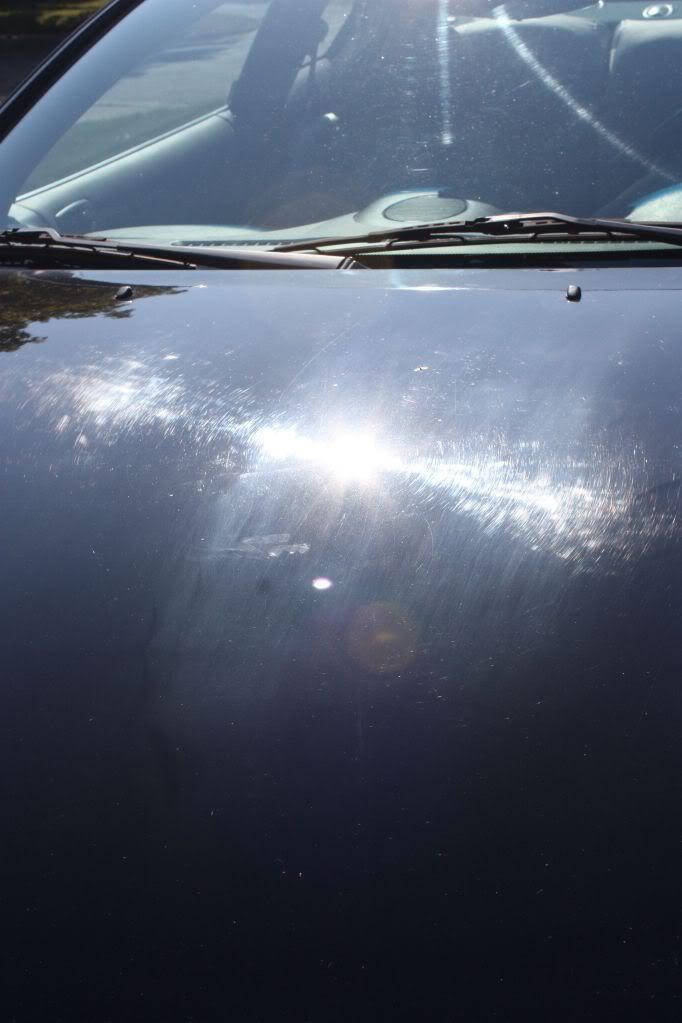

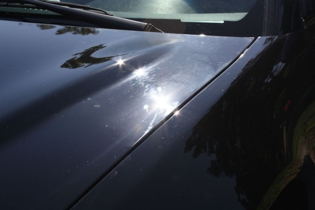

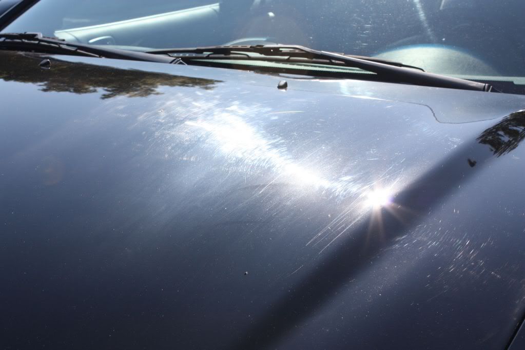

Check this out (keep in mind, this is relatively new paint)
The rest of the car suffers from basically the same thing to a slightly lesser degree.
So with my limited knowledge, this is what I see:
1.) Lots of swirls, which I believe were introduced through terrible washing technique after the car was polished?
2.) Long, straight and fine scratches. Considering the relative lack of orange peel on the hood in comparison to rest of the car, I'd say these are left over wet-sanding scratches?
3.) Buffer holograms or trails?
Now, I saw the car shortly after it was painted. It was not severely orange peeled, there was a fair amount but there was absolutely no defects in the paint even under the mid-day sun. So sometime between 5 weeks ago and now, it looks worse than a Black Oldsmobile Alero I did not too long ago. It's paint is 9 years old...
So what do you think I should tell the owner? He has a lot of respect for the person who painted the car, and apparently this painter contracts another guy out to do the buffing. After talking to this painter, I soon understood that his idea of washing a car is with a rag and dish soap. For the sake of not arguing with him, I just nodded and smiled but I think I may have been doing the owner a disservice by not pointing these things out.
Judging by the appearance you have
Swirls from horrible technique for anything and anytime anyone has "touched" the paint after it was painted. Could be washing, or wiping with a spray detailer.
The story of 3 H's - Horrendous, Horror Story and Hack Detailers...
These are called Tracers
Tracers Tracers - RIDS - Pigtails - Cobweb Swirls - Rotary Buffer Swirls - Holograms - Water Spots - Bird Drooping Etchings - Micro-Marring
Guaranteed.

Ben,
Definitely do a Test Spot and be sure to use a Tape-Line so everyone around can easily see the before-and-after difference which should be dramatic and shocking.
Then find the painter and show him how his paint job was completely hacked-up with your before pictures and be sure to show him your after pictures.

Alright, I've pointed the defects out to the owner and he's agreed to let me perform a test spot.
With much thanks to Deep Gloss Auto Salon and his thread here:
http://www.autogeekonline.net/forum/show-n-shine/24617-deep-gloss-jet-black-2010-bmw-m3-hacked.html
I was able to show the owner a good test spot and what black paint really looks like. :xyxthumbs:
Mike, I'm not sure that any of the following pictures are satisfactory examples of tracers. It is rather tough to capture what the human eye sees, even with a decent camera.
I'd think that the last picture is the best I have so far. It's a fairly clear representation of what is described in your article. The tracers being the duller, grayer looking area on the right where you can see that they have been compounded out on the left. At least, I think that's what has taken place?

Getting really good pictures of specific defects is a challenge.
For tracers, the best type of shot would be to capture them after you've removed all the swirls so the only defects in the paint are the straightline scratches.
No big deal... I can always create them on one of our black training hoods.
