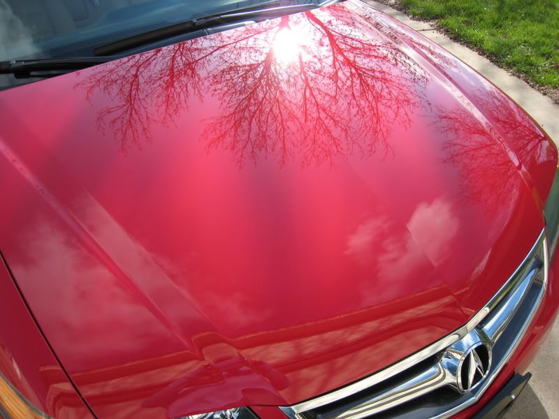

The TSX has 2 pretty pronoucned styling dips(lines) in the hood I'm wondering how that will be to buff.
I have an '08 TSX with the 3M clear bra as well. I have buffed mine a few times now with no issues. I also use the 3M blue paintes tape to tape off the edge. Just be sure to keep the DA at slow speed setting and use a fine polish, as you don't want the 3M film too get hot. :props:
Hood pic for reference...
Nice TSX. :xyxthumbs: I knew an AG member had a TSX but I couldn't remember your name.
What product and pad did you use to buff the 3m? What buffer did you use? Would you suggest speed 2?

I used the PC and the Flex 3401 on it with Meguiars M205 and M80. I think I had on a black finishing pad and a speed setting of 3 on both machines.
I've not used the 3M stuff you listed, but it appears to be very mild. Which is a good place to start. ;)

I have the Flex and Wolfgang products. I'm guessing the finishing glaze (with very mild abrasives) and the black pad would be a good combination for the 3m material.

The wolfgang "finishing glaze" is rated at the same cut as Menz 106FA and a step lighter the Meg's 205. That should be a very safe combo to start, and see what it does. Just keep your speed down on your flex, and light pressure, to keep heat to a minimum. Make a pass or 2 and see how it works for you. Let us know how it turns out!
