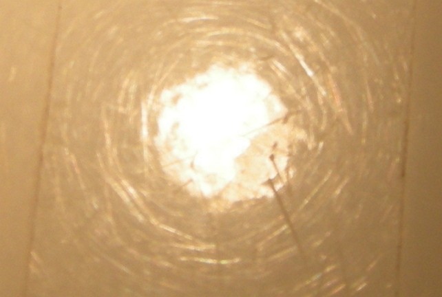

So i started with 800 just to get the old uv off. Then went to 1500 then 3000. Didntt have 2000. And i just did a quick pass on 3000. After that i wiped it down with IAP and then the spar mixture. It is clear for sure but im mot sure if its the scratches i can see or if its the lines from the uv. View attachment 54568View attachment 54569
