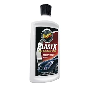

I wouldn't use ANY type of polish,......compound?, yes.....polish?...no,
sorry,...
do you say Meg's Ultimate Compound
would be better then
