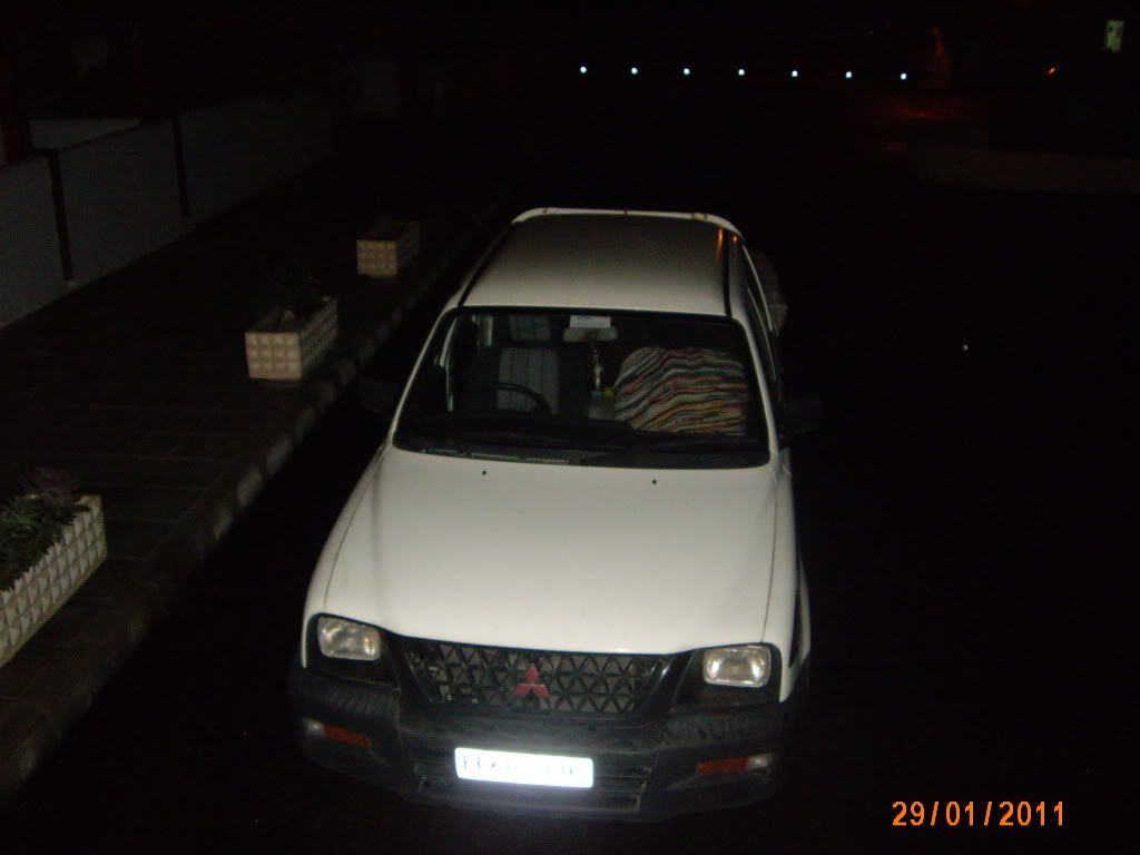

Hello guys .i need your Help in this because i dont want to make any stupid thing.I recently took a flex 3401 with all the lc pads. I want to shine a lit of bit by dads car which is a mitsubishi 2001 with single stage paint and to many oxidation.
MY polish are all the gloss it products from the compounds to the detailing spray.
I am thinking to start with the orange pad and the more agrresive compound(extreme cut) to see how is it?
Your opinions pls
