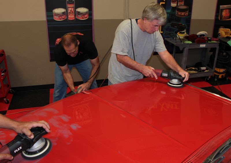

I spoke with Jason Rose about this when I was at RUPES in Colorado a few weeks ago teaching our Roadshow Class. I shared with him my experience that thicker pads seem to buff easier and smoother.
Pictures: Autogeek's Roadshow Class at RUPES in Colorado - 2018
As a professional courtesy, I make sure everyone uses the official RUPES Mille pads on the Mille polishers in my class and then if the student wants I let them try thicker pads like the ones I listed. I'm pretty sure each person that has tried both thin and thick pads has concurred with me that the thicker pads buff smoother.
