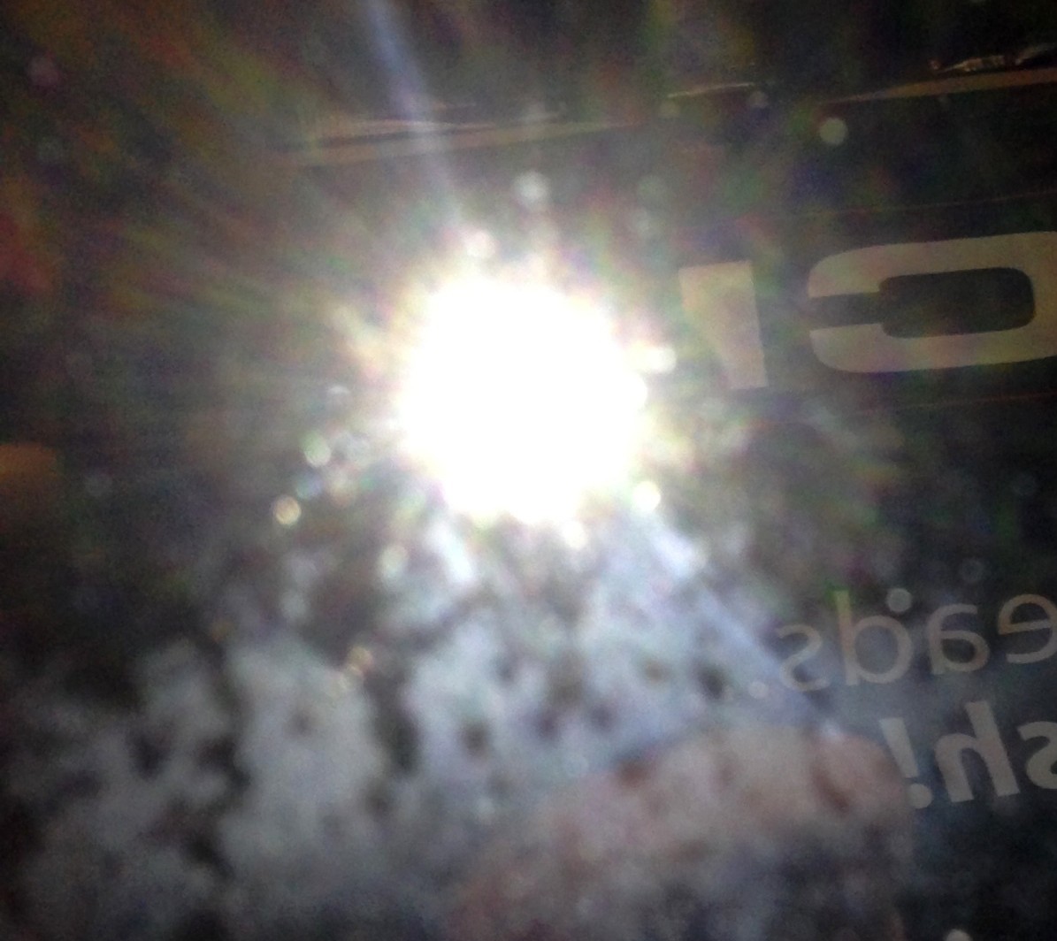

Had good luck with the CCS orange hand pad and Mezerna SF4000. The door I did I couple of days ago with the halogen work light pointed at it from the side was the worst by far. I was exhausted by the time I got to it. I had done the hand buffing in spots, polished the rear fender with the G9, and applied a layer of the Lite to that panel. I ended up going over that door with G9 on 1 with an orange LC flat pad and SF4000. I’m torn whether I want to try to put more lite on those areas or just leave it and see when it fails relative to the other panels. The best panel for high spots was the hood. It was under the fluorescent fixture when I did it. The high spots were all at the edges of panels, especially at the bottom where it turns under the trim.
here’s the before pic, I’ll get the after in a bit...
