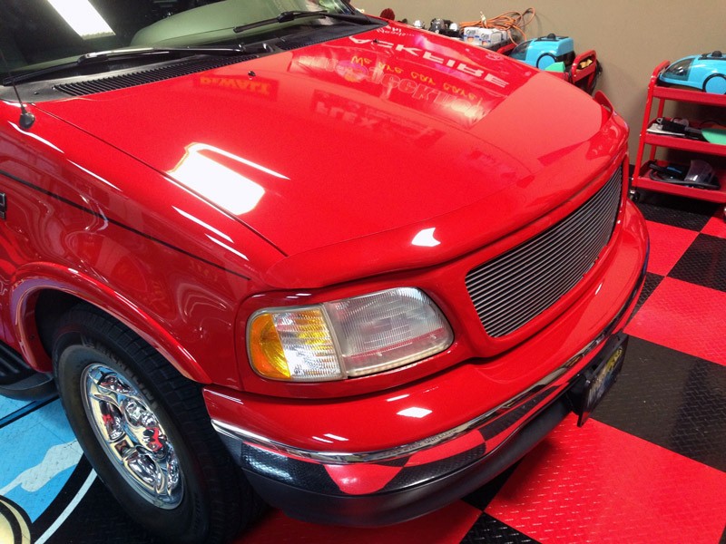

Here’s the ‘after’ picture of the area with the most high spots...
Here’s the panel I did today in sun light. Think I could see all the spots better, though at the end it had gotten more in shadow.
