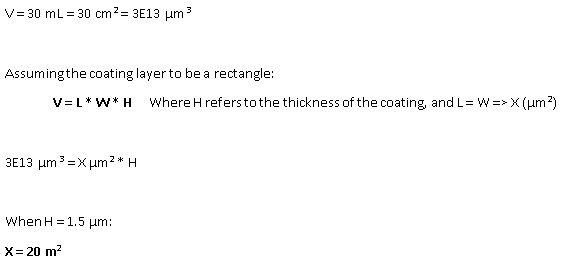

Just like the title states.
How does anyone coat a car with only 10cc or less of product and think that ?!?!?!? Or even the 30ml of CQ or any other coating....
If you do the math there is almost no way for any of these coatings to create any kind of measurable thickness barrier; unless you use a lot ore product than supplied.
I bought a 10cc syringe of Opti-Gloss Coat simply to do the wheels on my GTI. The wheels are very simple and easy to detail so there wasn't any wasted product from intricate details I had a hard time with. Just for the wheels and calipers I used the ENTIRE 10cc of product. I didn't have any "high spot" issue I simply applied it as thick and uniform as possible. So based on this I have to step back and ask how anyone does all the paint and/or wheels on a care with 10cc or less of product. In my mind it just doesn't make sense.
