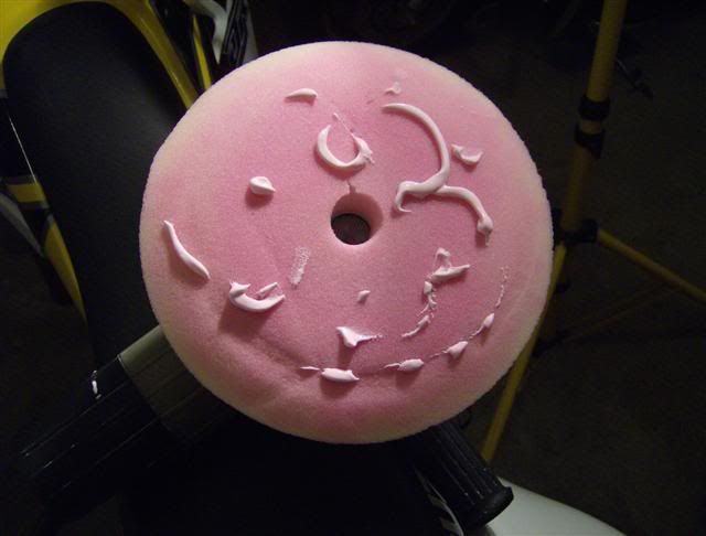

This is how I prime my pads with all polishes, especially the SSRs:

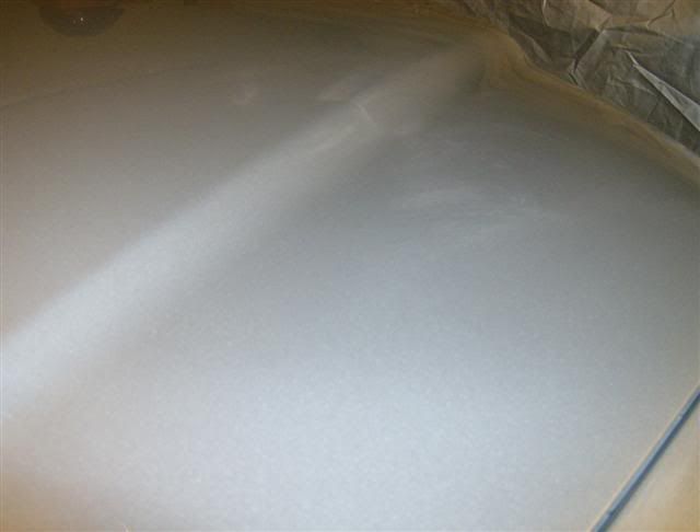

Now smear the pad around on the paint and try to cover all of the pad before using the pad:

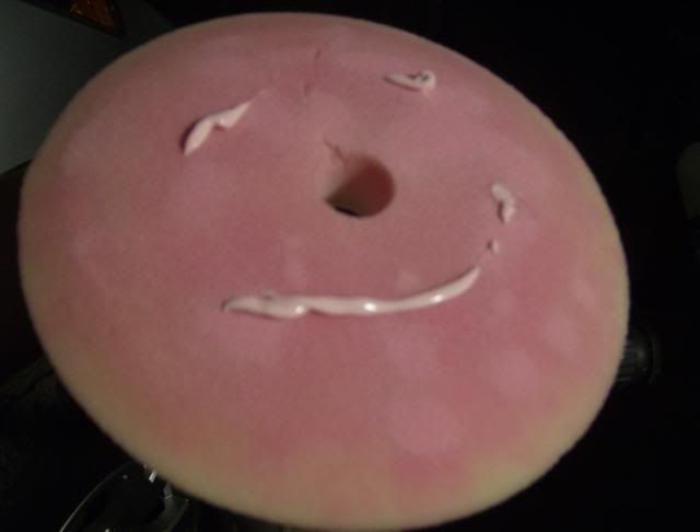

After I worked that area, I went ahead and continued on to the next panel using this much product (smile

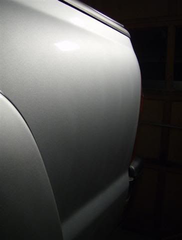

Notice the lack of swirls and dust (I polished the whole truck with zero dusting with the above process):

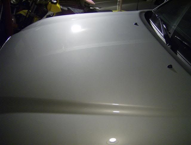

After the polishing, I applied JeffsWerkstatt Acrylic Jett, thin is in!:
