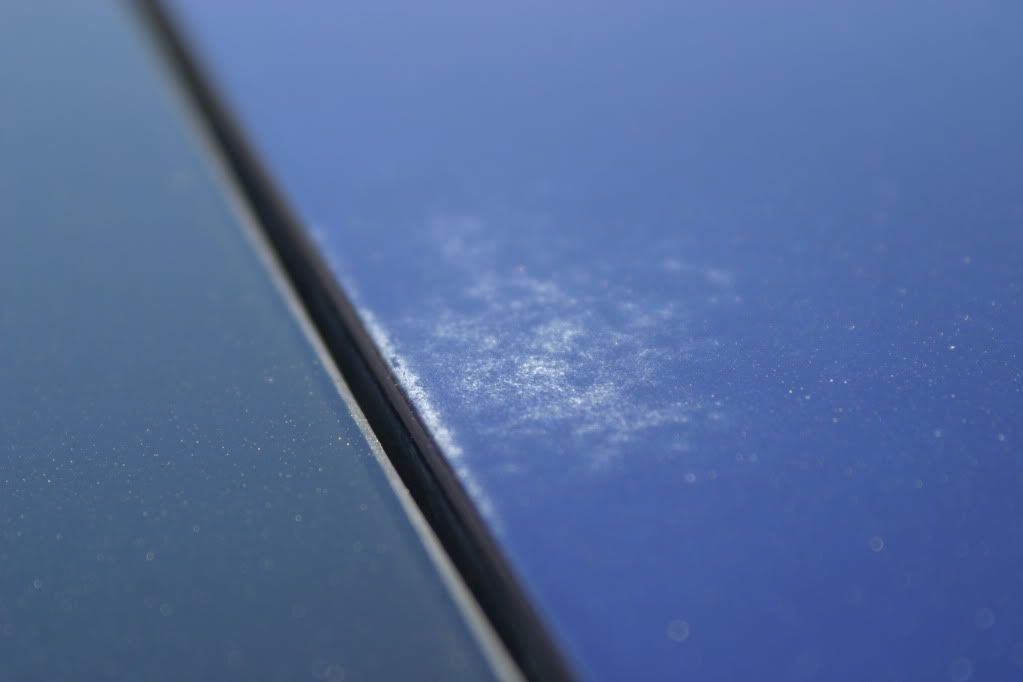

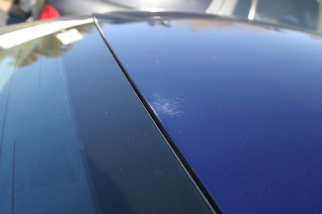

I noticed the other day that I have a small spot on the roof of my car by the rear window that looks like this:
I know there isn't really anything you can do with a failing clear coat other than paint it... which brings me to my question.

Any touch up is going to look exactly like it sounds, touched up. Whether or not that is better than the existing spot is up to you.
I would focus on making sure the rest of the paint is properly protected and hopefully slow down the continued degradation of whats left of the clear coat.
I've had to repair many of these in a body shop I used to work at. We had a big account with Honda and the blacks and blues would always have these problems. It's a paint defect from the company. The way it worked with Honda I believe is, no matter the year of the car you just go to the dealer and they have to take care of it. The problem though is a lot of body shops don't do the job correct. They'll just sand out the area and respray over that and a few months down the line you'll have the same problem. The correct way is to get the entire panel to metal, prime, paint, and clear the entire thing. What kind of car is it happening on for you?

2008 Honda Civic Si
I may be remembering incorrectly but I believe Honda had either a recall or a technical service bulletin on a certain color.
Definitely covered. The civics are prone to fade on the roof, trunk,fenders, hood, pillars, and quarter panels. I'd go to your local dealer they should straighten it out for you. Just be sure to ask the procedure they do to fix it.
