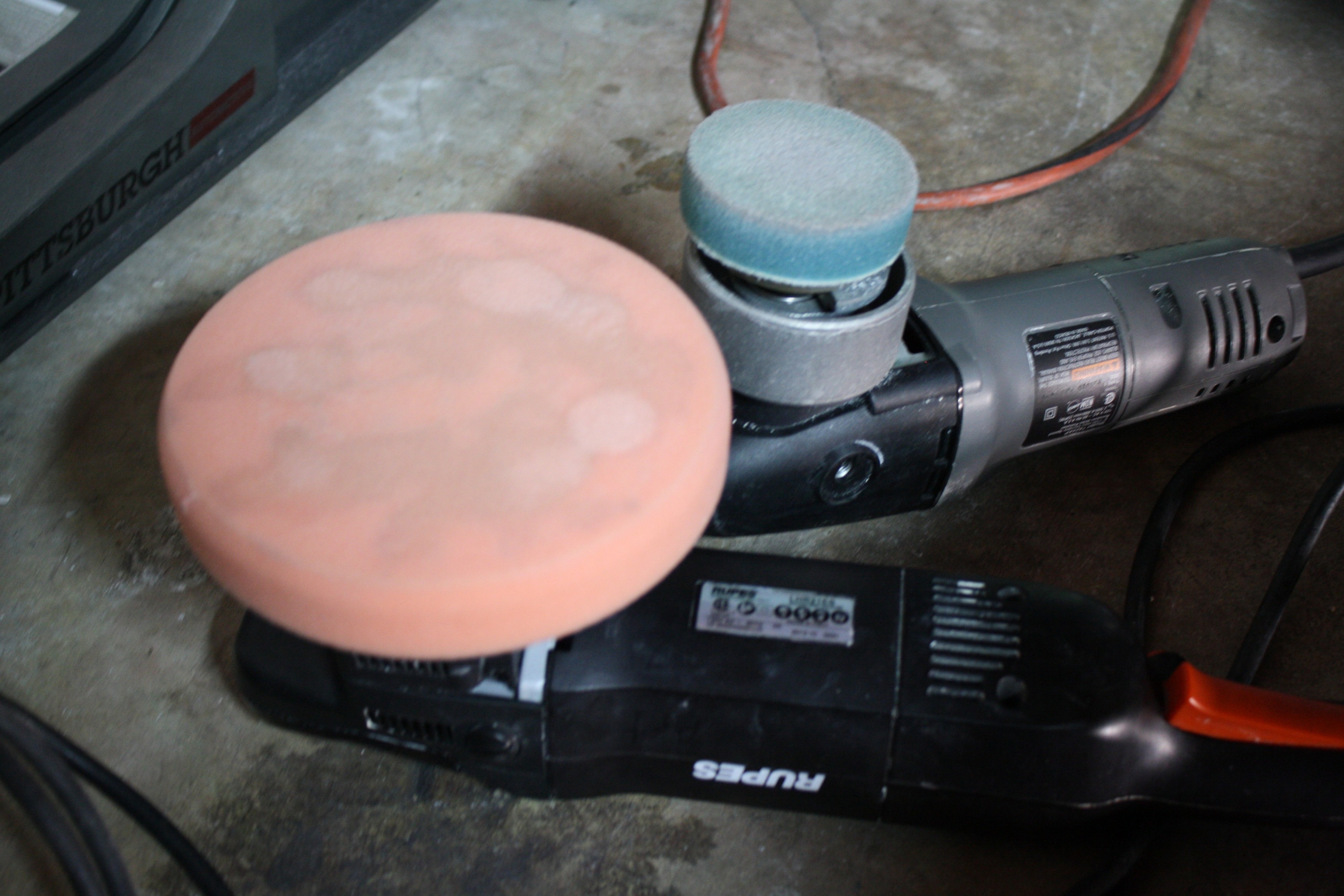

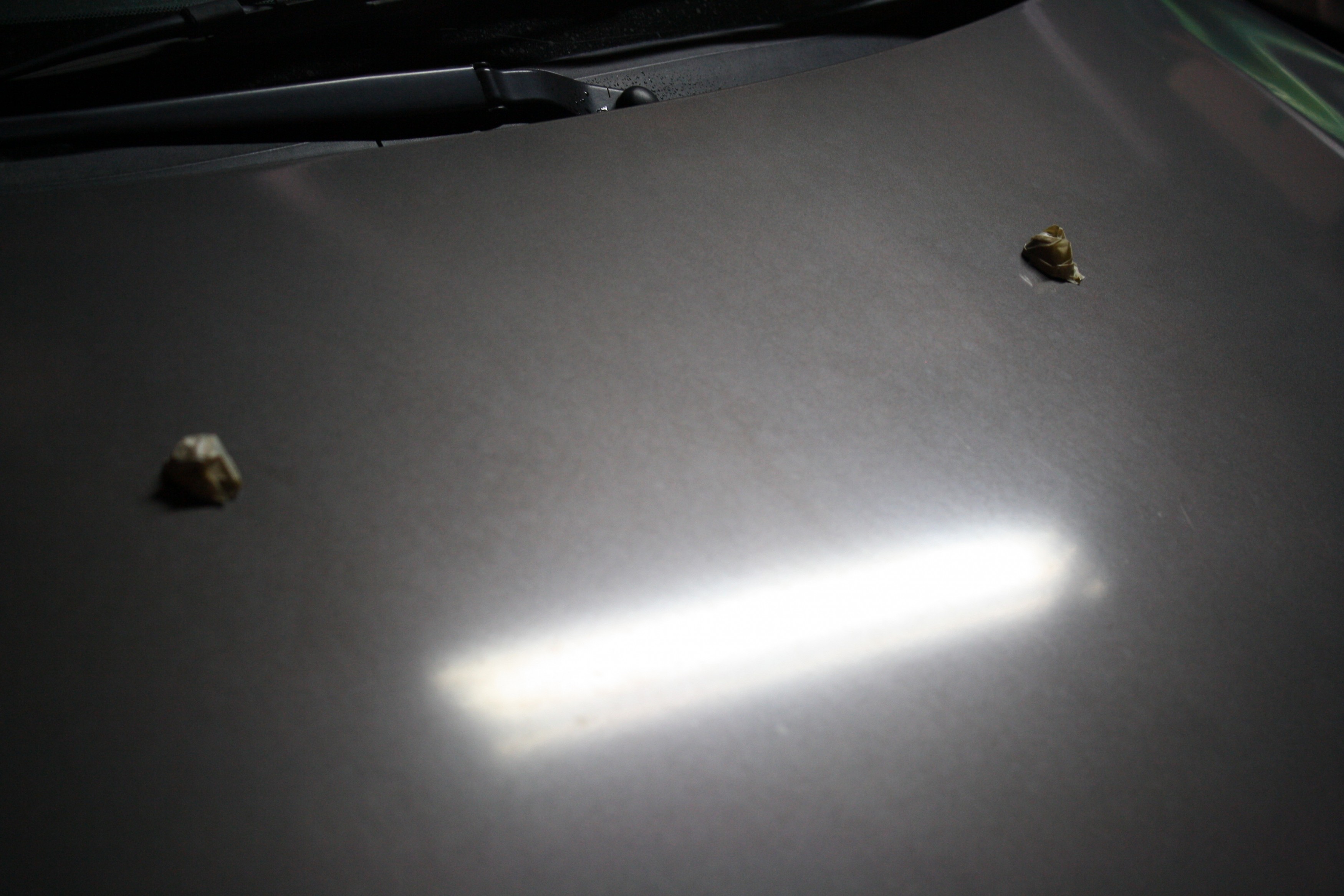

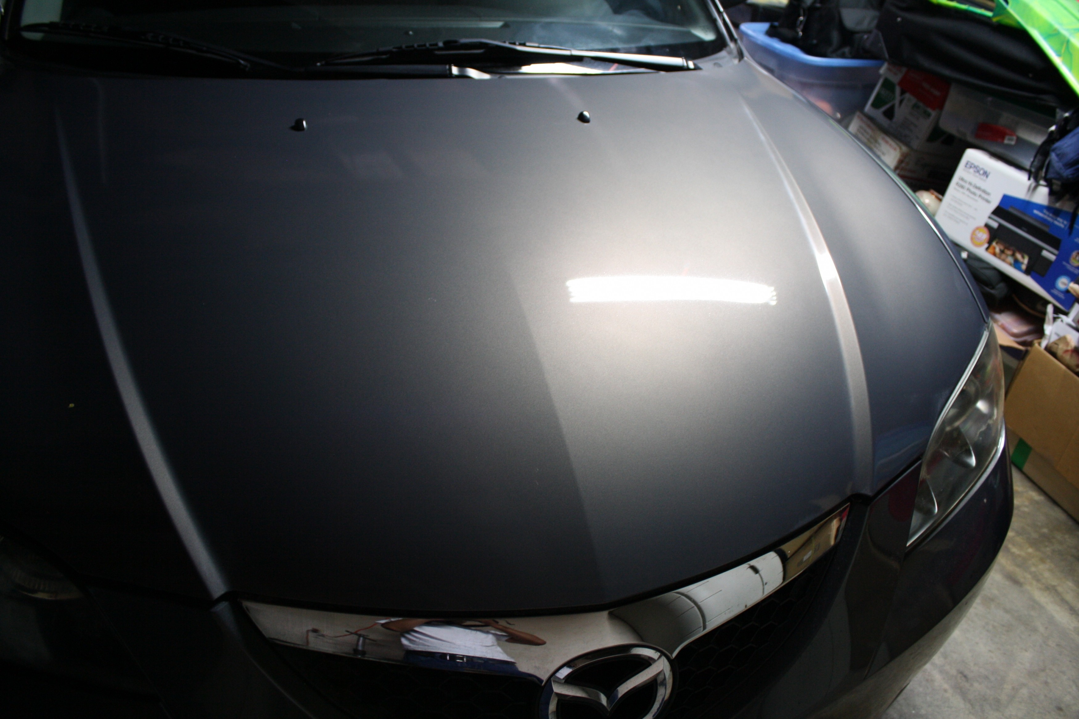

Went to a regular clients today for a roof only job for a Christmas gift for her roommate. I already had a pretty good idea what shape the roof was in. She had sent pictures and described the rest of the car was fine. After a good decon I went straight to a blue Rupes foam with the 3401 and 3D ACA 510 After a small test area I felt It was definitely going to need the rotary! I first tried a Blue wool/Corse w/same compound. And it didn't produce as good of results as the BEAST! HUM..... OK I then went for the old school wool w/same compound. Still not the results I got from the Beast! Now I am really DUMBFOUNDED!!!! So I went back to the BEAST and the blue Ruped pad and just finished off with very nice results. But WTH I even laid into it with the wool pretty good! Not just flat either! So it took 4 good long slow passes to clean it up! I was hoping the rotary (1 good pass) and finish up with the 3401.

I consistently out cut the 3401 with my Porter Cable. The only reason I could come up with was my familiarity with it. That's for heavy correction though. The 3401 works great for me with one steps or cleaner wax jobs - even though I typically use the 7424xp or the Rupes Duetto.
How did you like that blue pad with the 3D?

That Pad is a work horse. I'm pretty stingy with my HDO CCS Blue's But I tried 205/Cuttmax and Fast correcting cream and the ACA 510 was the strongest musket:)
But I'm almost embarrassed to say how long it took. 3.5 hours but that included decon/Bilt H. then Slick N Slide foam C. and wipe down dusting a bit. She gave me a nice 50% tip though.

I was VERY impressed with how fast the DA Coarse with the blue coarse rupes wool pad leveled the paint. I was also impressed with the amount of dust it produced - would have been perfect if that's what I was going after - dust!
But my muskets of choice are indeed the 3D offerings. As of today it's the ACA500. I do plan on picking up the Rupes pads again at some point, but this time I'm going to use them with my 3D abrasives.

Nice job. Your already getting pro results
