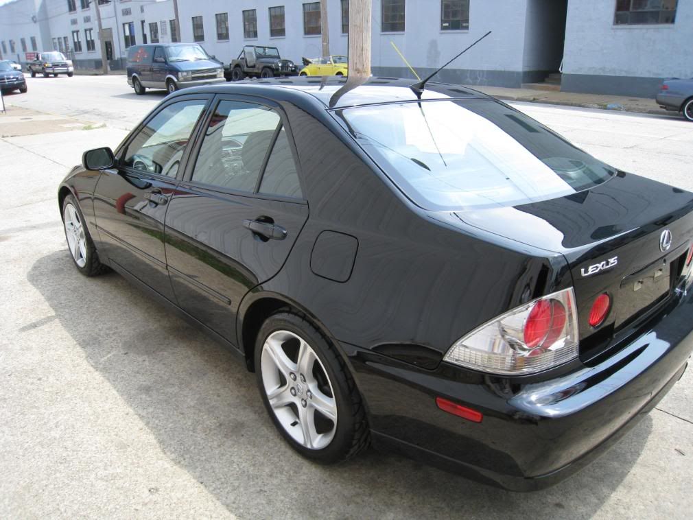

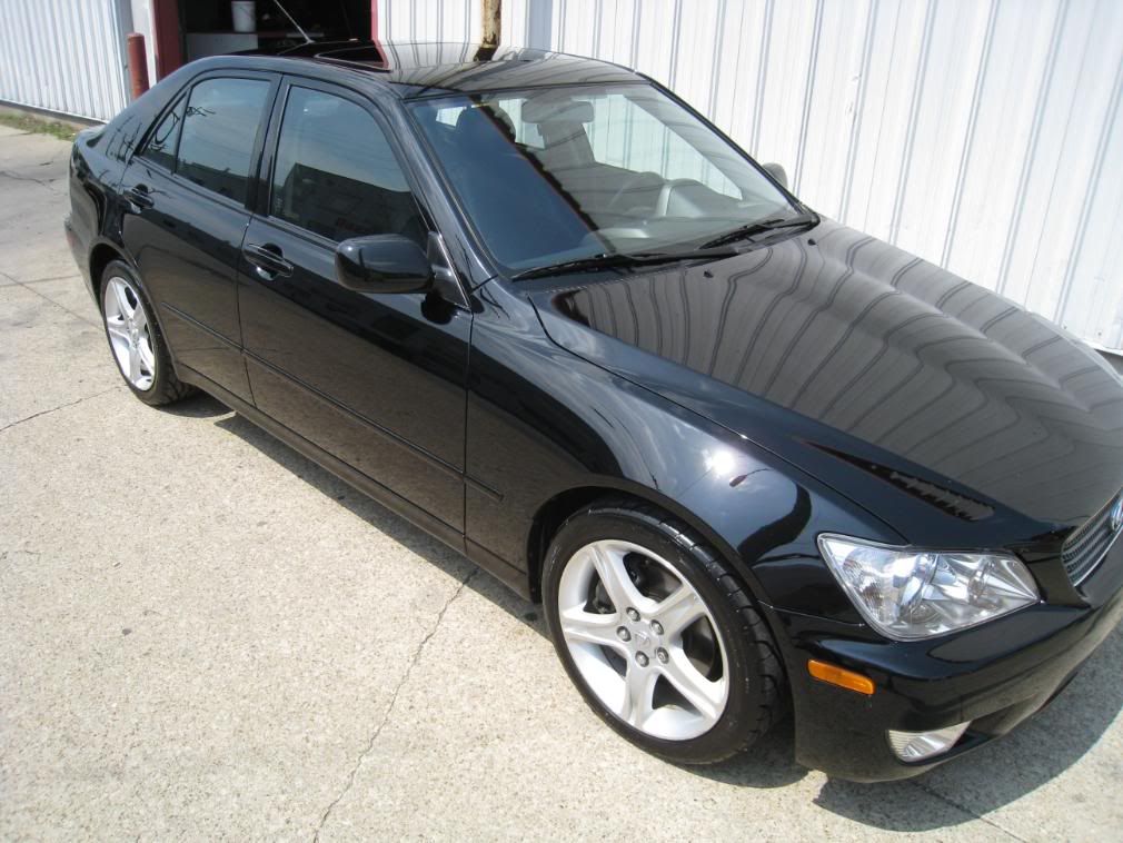

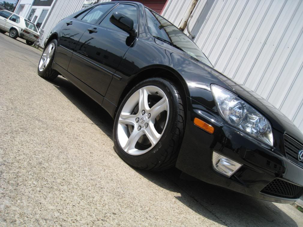

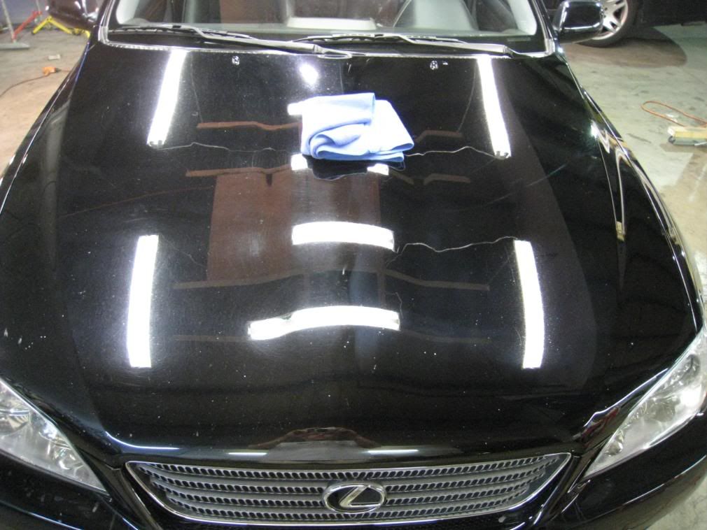

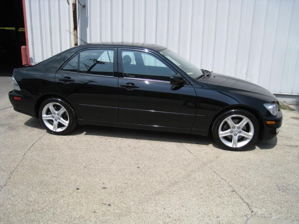

Just your normal scarred up 8 year old Lexus Black paint.... oh yeah single stage
Engine, Wells, Tires and Rockers were degreased with Purple Clean
Wheels were cleaned with HF Acid
Citrus Pre Soak
Wash-Clay Process with Wash and glow
Rinse and dried with purged air and chamois

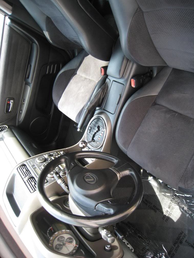

Interior Tools used:
Matco air polisher w/cyclo brush, Various brushes, Shop vac, extractor, Comp air, plastic upholstery tools for crevices, scotch pads, magic erasers
Chemicals
Fabrik Magik
Blue clean apc
Mr Jinx
Sprayway spot
Sprayway glass

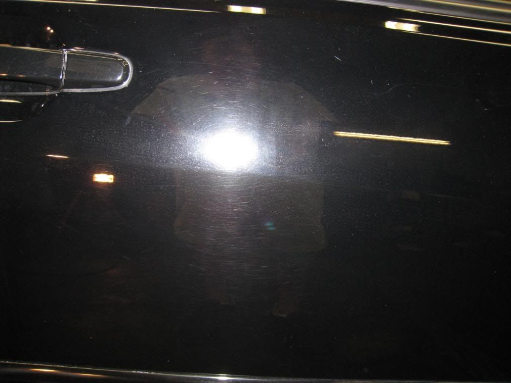

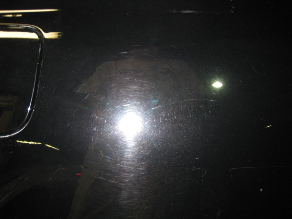

Exterior(paint correction)
Megs 105 with cutting pad at 1600
Megs SF Polish with Sonus white polish pad at 1200-1800 via Makita
Megs sealent cut with Instafinish Swirlaway with Megs finish pad at 1000
Megs #26 via PC
Dressings

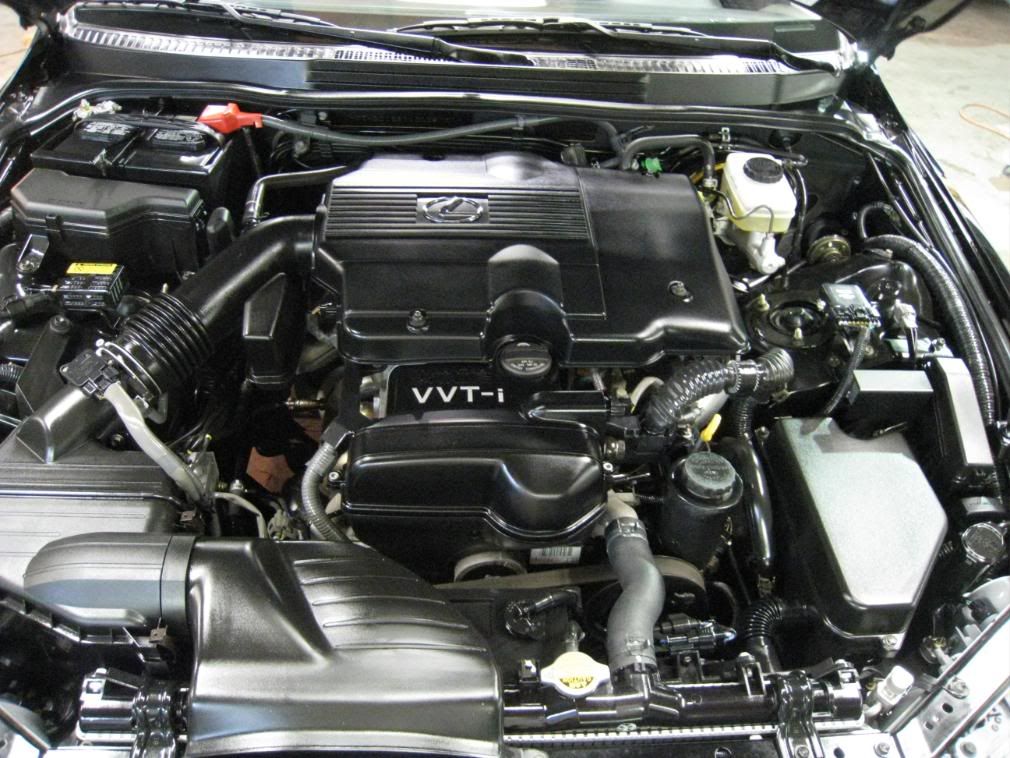

Engine-quick Shot
Wells- sprayway undercoat and instashine
Tires-Ultrablue II
Any metal or exhaust polishing is done with Carbrite metalbrite and a silvereagle air polisher

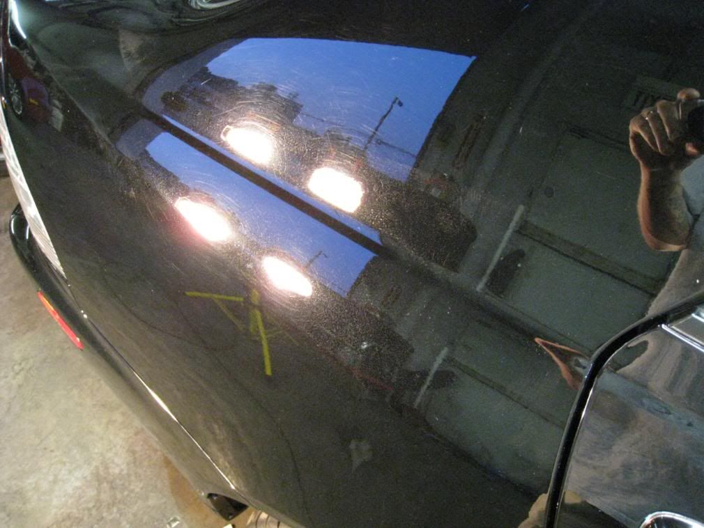

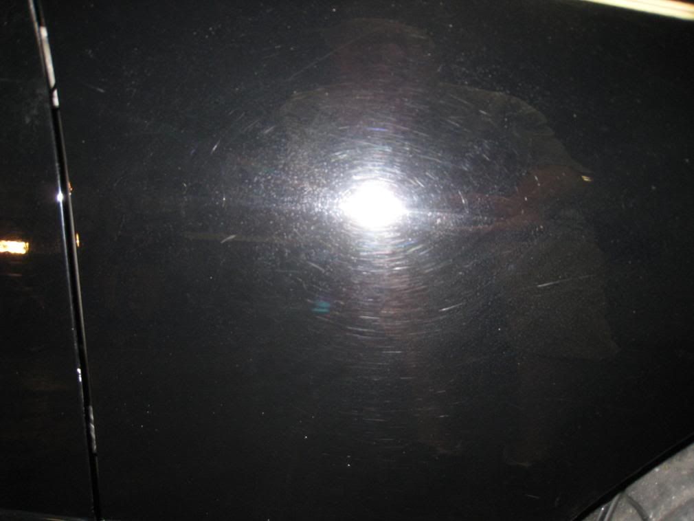

A few of the paint condition
Interior and engine

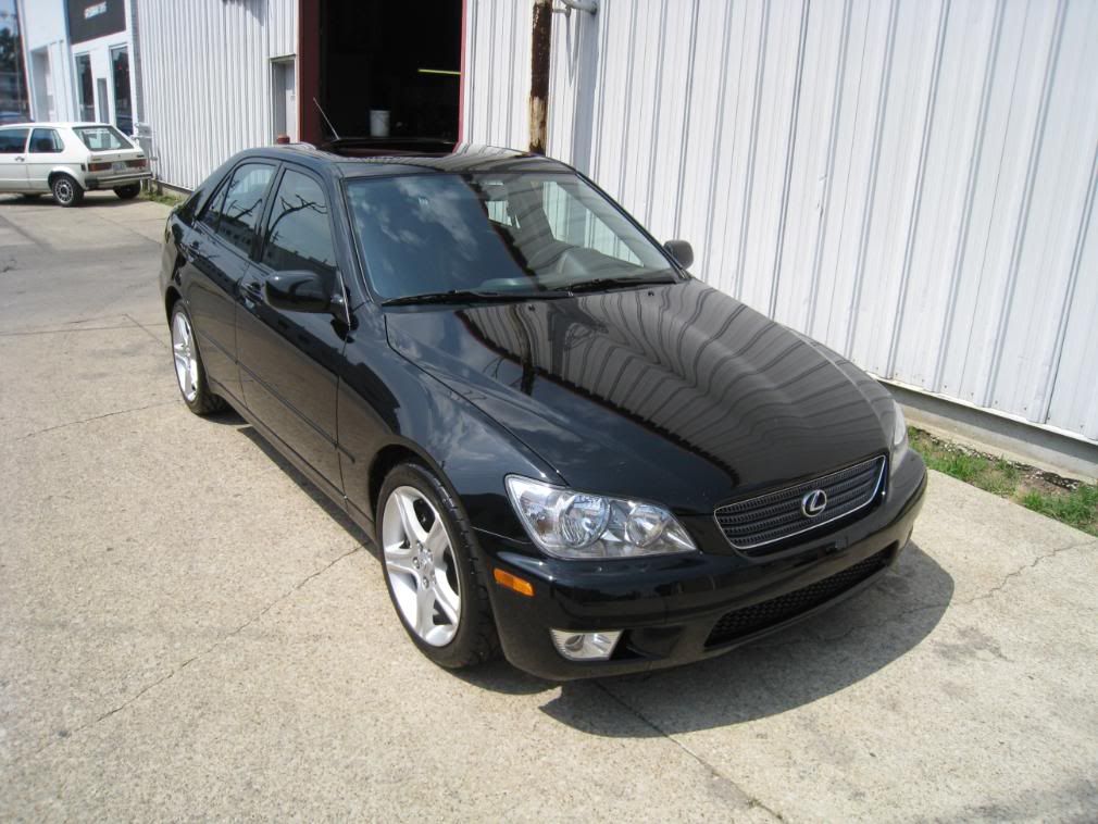

Afters...
Thanks for looking!!!
