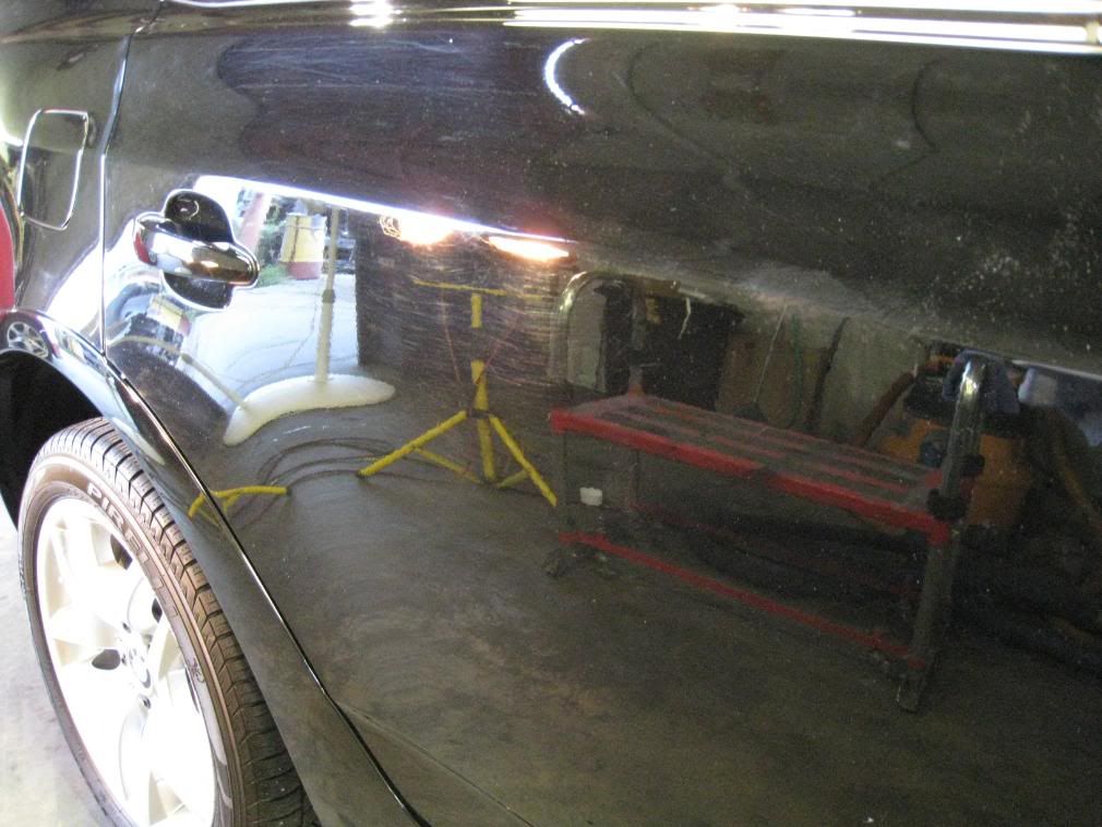

This was the replacement for this accident, Owner and 4 others were parked when he was hit.
Car was purchased a month ago and it had been detailed by the dealer, but they installed some buffer trails free of charge
Polished with #83 white pad via makita, Glazed with machine glaze and 3m black waffle via flex, topped with 26

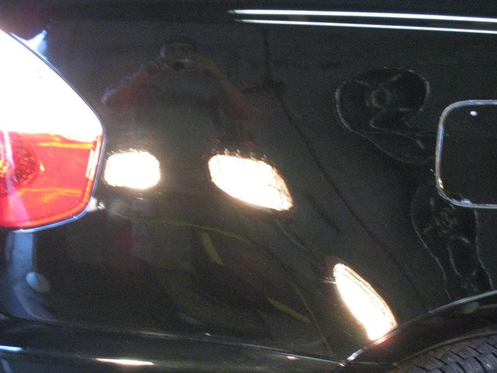

Here are a few shots of a 2006 Black X3 with the M sport package corrected with a orange pad and 3m 6060
Befores
After one pass with orange
one more pass with a white pad with some #82

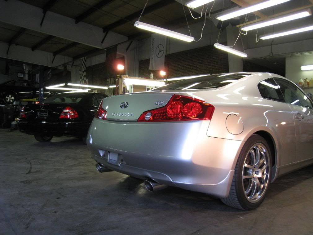

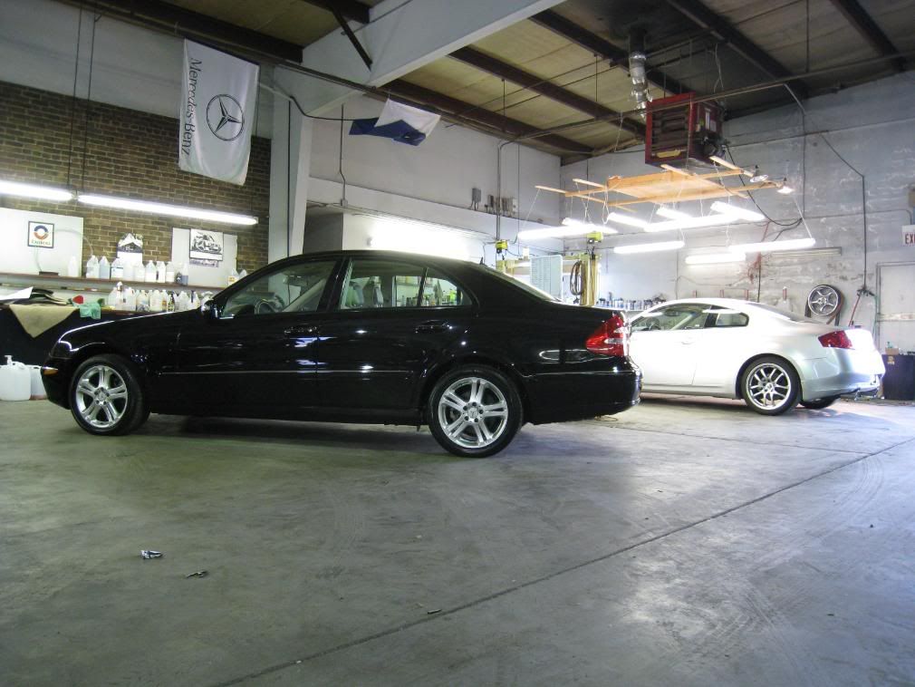

2005 G35 and a 2006 E350
The E class was hit with the 83/82 combo, orange and black pad via rotary, topped with 26
The G car was hit with 82/80 sonus yellow and white pad and burnished with the new 21 which I will never use again, it seemed like it would never come off
