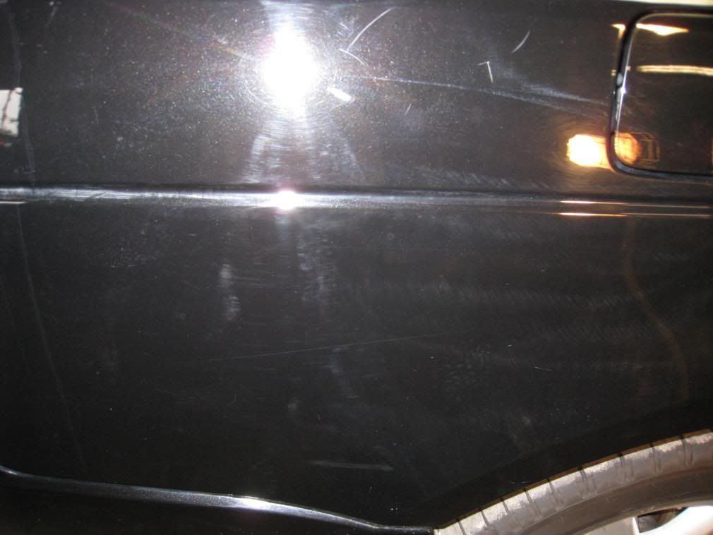

Wash/clay/wash/rinse
air gun and chamois to dry
acid on wheels
purple clean on engine, wells, and tires
Megs swirl free polish at 1200-1800 with solo polish pad
polyseal with soft polish pad and pc at 5
#26 with finish pad on 4
sprayway on windows
quickshot on engine
instantshine on wells
blue clean,fabrik magik and mr jinx on the interior
mats dressed with quickshot

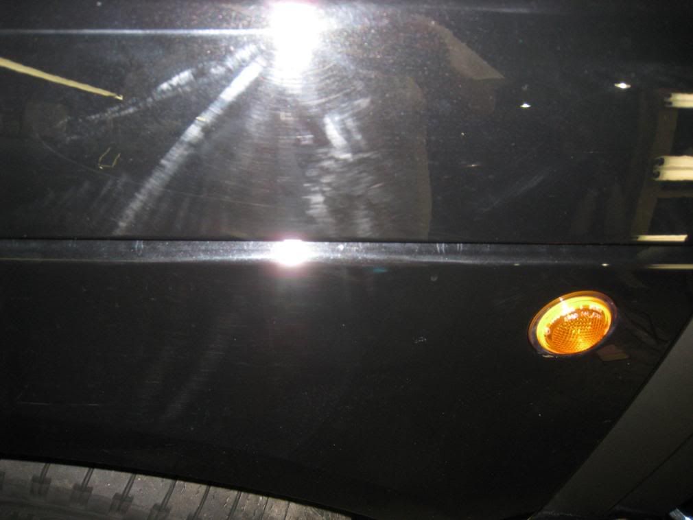

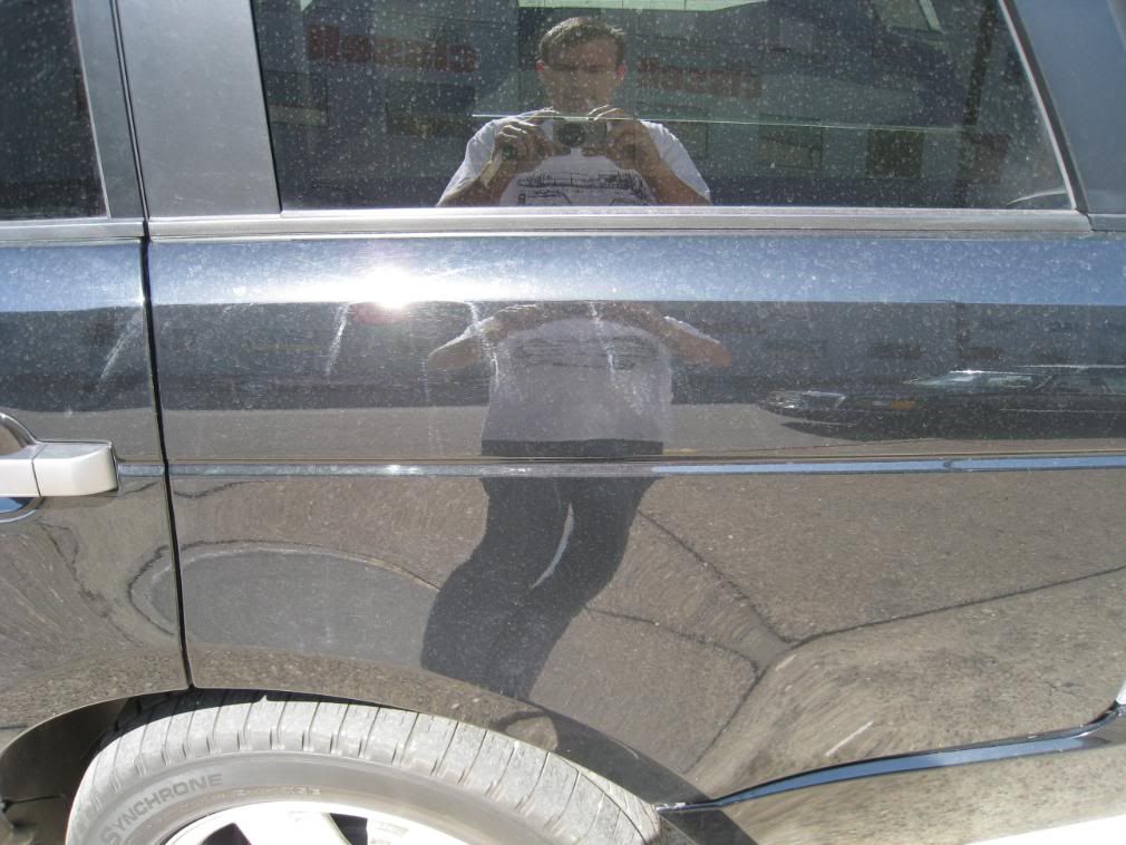

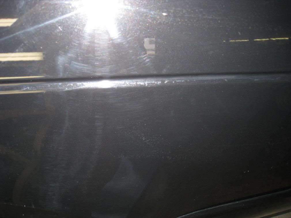

A few befores
